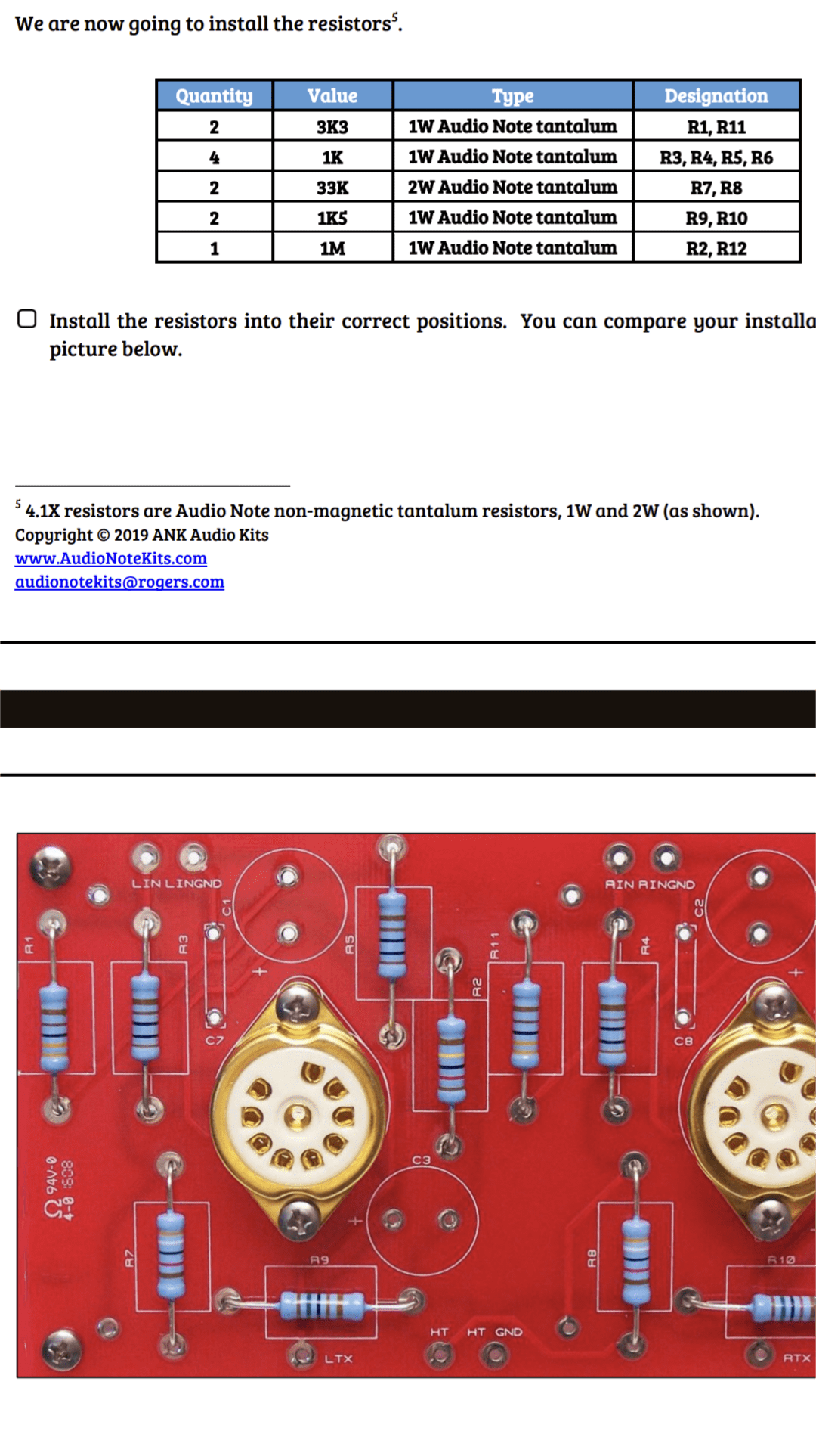

I think you are confusing the DAC with another model. What I am talking about is the Audio Note Kit DAC 4.1, which uses IV transformers with a 3.3K resistor, and the spec for Zout = 13 Ohm.

Neither of these numbers are mentioned on the linked page. Nor do they make a whole lot of sense. Where did you get them from? R19/R20 seem to be the I/V resistors in your dac and they look like 330R.
1mA * 0.7 * 0.33 = 0.231v RMS after the resistors
Assuming 12AU7 together with the follower amplify x14, that is 3.2v RMS at the output. Unless i have an entirely wrong idea of the topology that doesn't leave a whole lot of options for the output transformer to reduce the impedance, so it's pretty much the ECC99 cathode follower determining the impedance here. So, assuming no series resistor with the output and zero DC transformer Rout = 100R or thereabouts.

This is a manual
https://ankaudiokits.com/ankmanuals/DAC 4.1 C-Core Manual V 6.07.pdf
Page 9 is the basic circuit

A 3k3 resistor cannot work on the dac side. It may work if the little transformer is a step up and the iv resistor is loading the secondary. It should be trivial to open the lid and make sure.
The output impedance could also be possible if instead of CC/CA the tube topology is CC/CC. Then a step down transformer, similar to what AN have in some preamps, with a voltage ratio of 33:1, is used.
Not sure why all the obfuscation in the user manual.
Opening the lid and drawing up a partial circuit seems essential.

Actually my mistake, there is a 330 Ohm resistor before the IV resistor right at the output of the DAC chip and a 3.3K resistor on the secondary.
I don't know what the turn ratio is, but I believe it's 1:1, which would give a Riv = 300 Ohm
