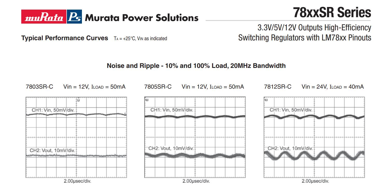

For $13 try this Murata 7805SR 5 volt reg as it's very quiet:
https://www.digikey.com/en/products/detail/murata-power-solutions-inc/7805SR-C/1926159
Russellc
It's quieter than the LM7805 that it replaced, but the datasheet does not look impressive I admit. Do you have other Vregs to compare against?
I also use the Murata, but only to drop from 24V to 5V for a MCU (not audio) supply.
And only as a pre-reg.
