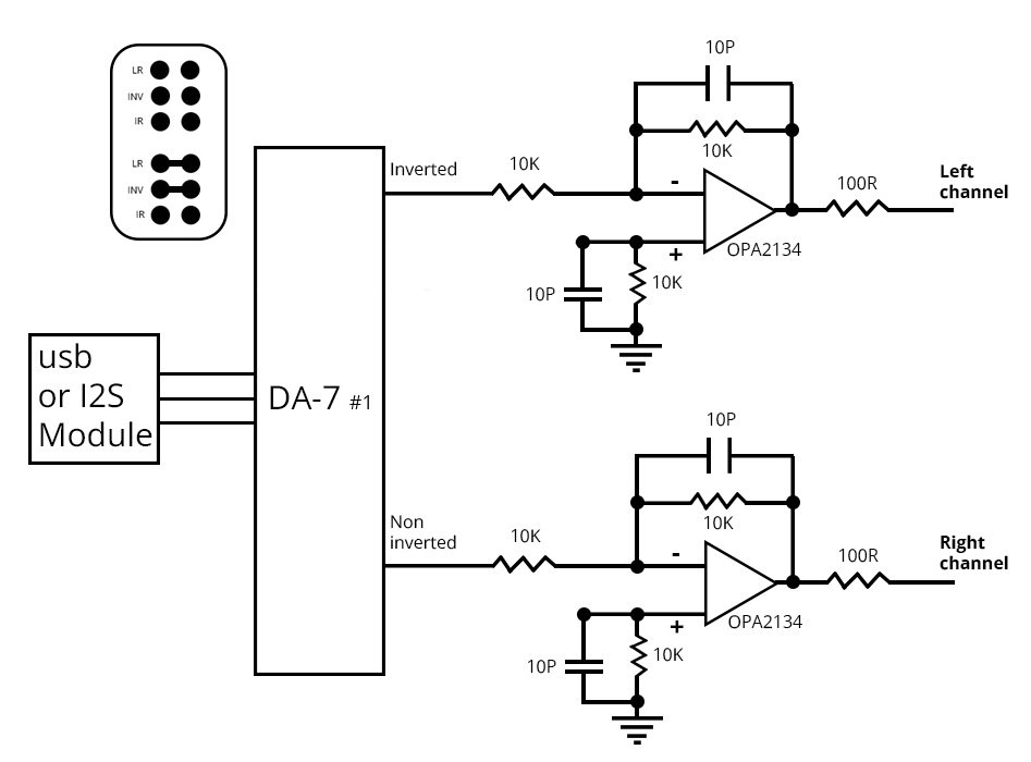

Good evening, I am trying to build an R2R DAC I purchased from AudioPhonics, and this is the one. My problem is that in the single-ended configuration, I have a positive output from the channels, but following the schematic, I need to connect it to the negative input of the operational amplifier, which results in a negative voltage on the RCA outputs. Can someone help me understand where I might be going wrong? Thank you very much!

No problem, just the way it is designed. Both L ad R outputs are in the positive polarity.
Follow the schematic.

Thank you very much for the response. I have two more questions: The power supply for the OPA134 needs to be dual, correct? Also, I plan to connect it to the Buffer Preamp B1 by Nelson Pass. Should I maintain the signal inversion all the way to the power amp? Can I also connect this DAC to the Naim Nait XS3 without any issues?
In engineering there are usually alternatives. Op amp circuits CAN be made to run on a single supply.
Your circuit is probably dual supply, but do you have an actual complete schematic diagram?
There is no signal inversion at your board's single ended outputs.
The IC has one inverting and one non-inverting output. This IC was originally intended for a balanced mono circuit.
But it can be used for a single ended stereo circuit, as shown. Then the left side must use an inverting op amp circuit.
The B1 is also non-inverting. with DC blocking at both input and output.
The Naim is also non-inverting, with DC blocking at the input.
If your board is wired exactly like the diagram, it does not invert either channel.

Can you draw a complete circuit diagram of what you are measuring?
If you are using the diagram above, that is more of a conceptual diagram, not an actual schematic.
What is the DC voltage output of each channel, at the DA-7 outputs?

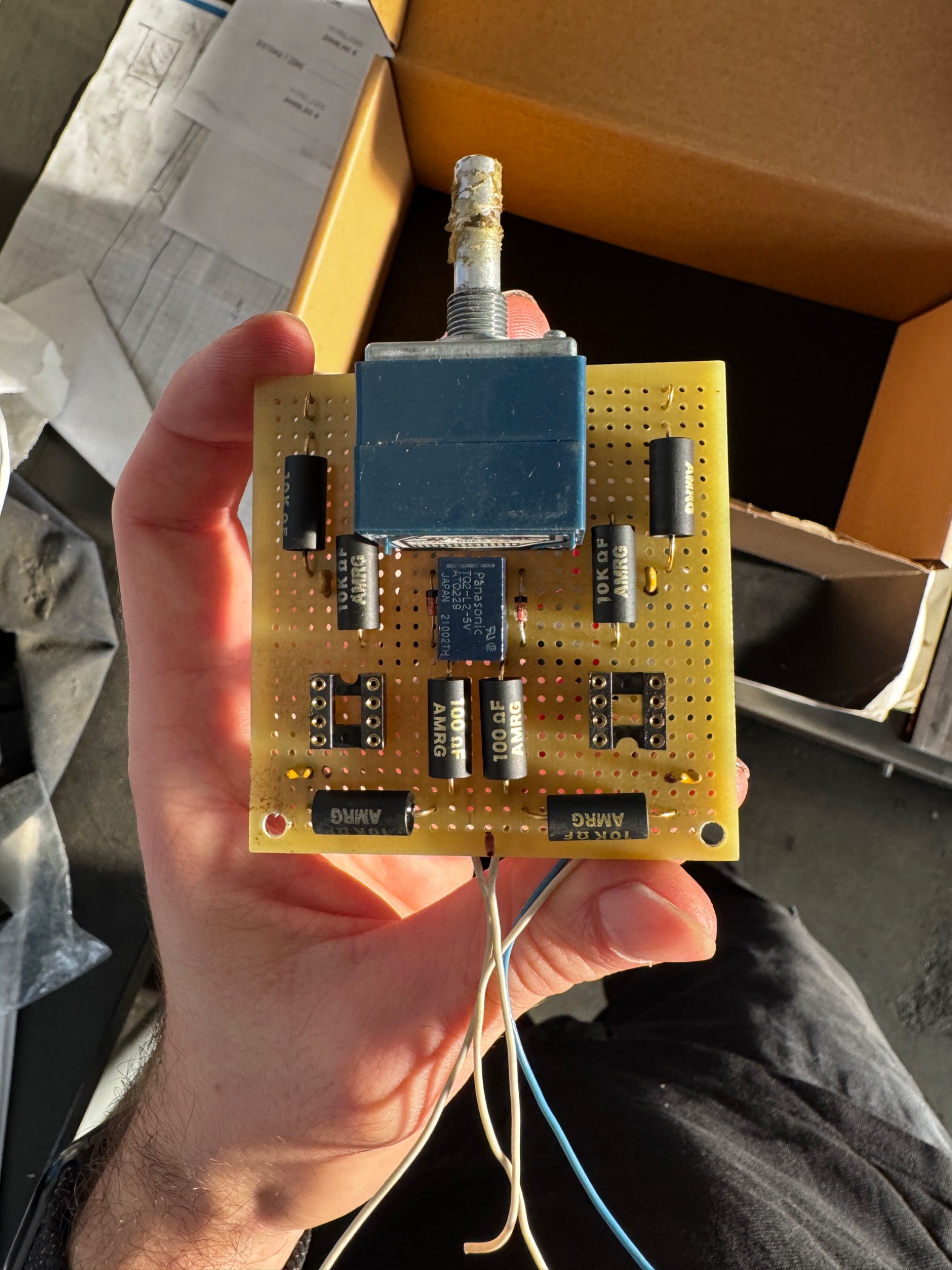

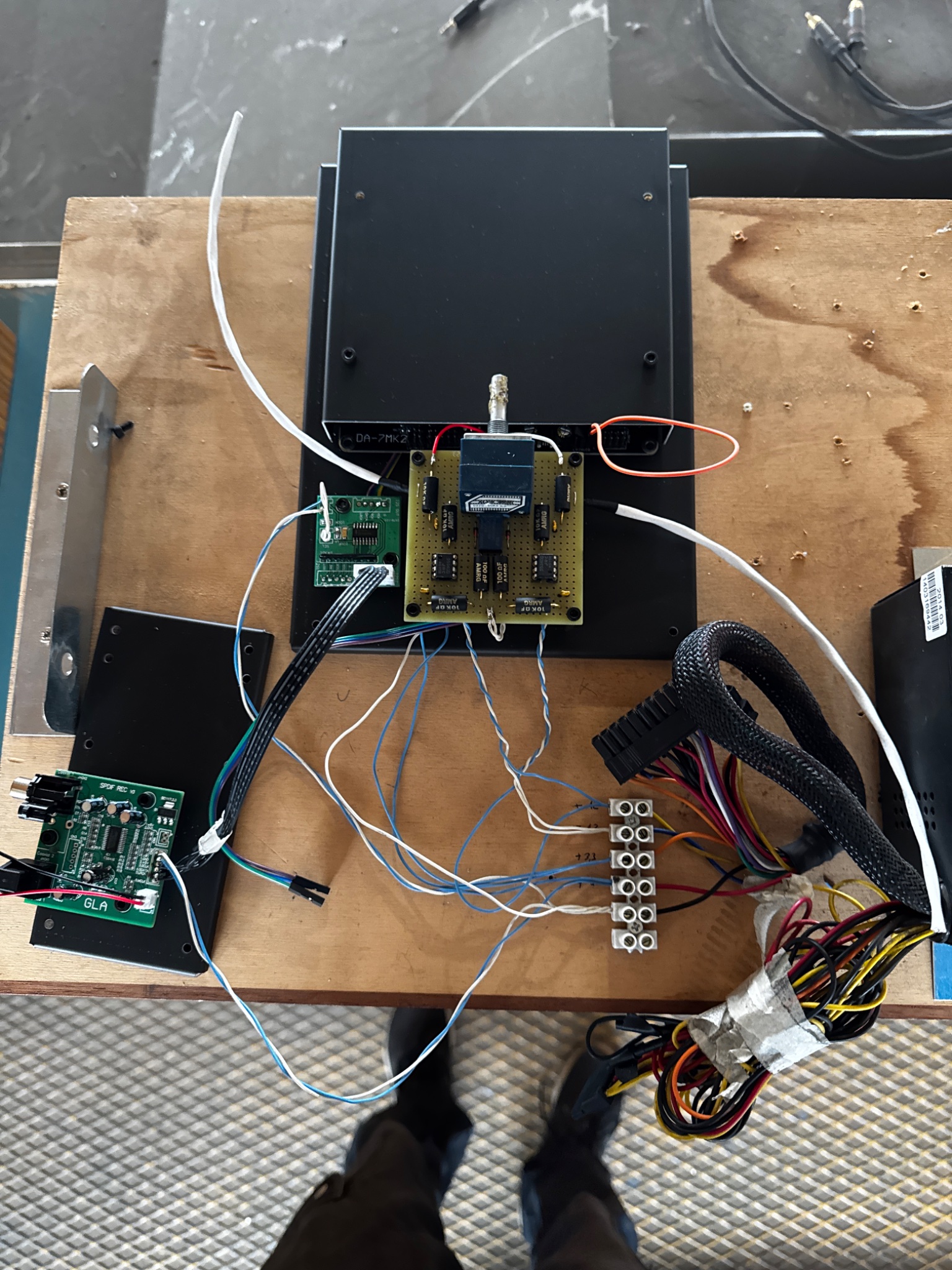

At the moment, I’m using the +3.3V output from a PC power supply to power the DAC and +12V and -12V for the op-amp. The rest of the schematic is the same as the one on the website that you posted.

go look at the product page he quoted, it is not so straight forward as it seems and I don't think he can explain any better what is wrong. There is no schematic at all. Picture of the POT and other paraphernalia has nothing to do with it, I don't know why he is showing it. He must first establish that the DAC is operational as he wants to apply it. There is a number of solder links he has to configure. There is some interpreting to be done. I don't do DAC, have not tried to, 50 bucks for a topping is my goto DAC
I guess he can do some simple signal polarity measurements with a scope and see if the left channel of the DA-7
does indeed invert the signal polarity, while the right channel does not invert polarity.
If so, the right channel op amp must be a non-inverting unity gain circuit (signal applied to the positive input).
But also he likely needs DC blocking capacitors at the outputs of the DA-7, about 10uF at 35VDC.
Also there must be main output DC blocking capacitors as well, even if the power amp has them at the inputs.
