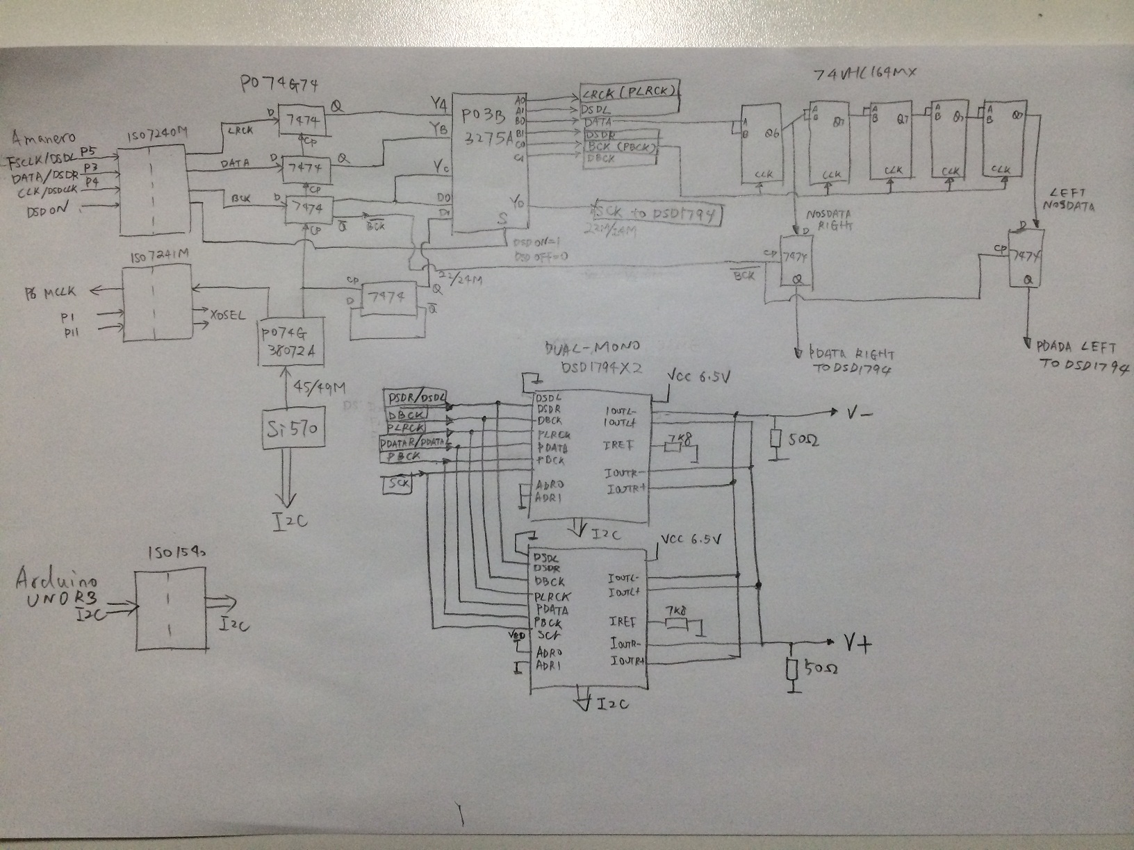

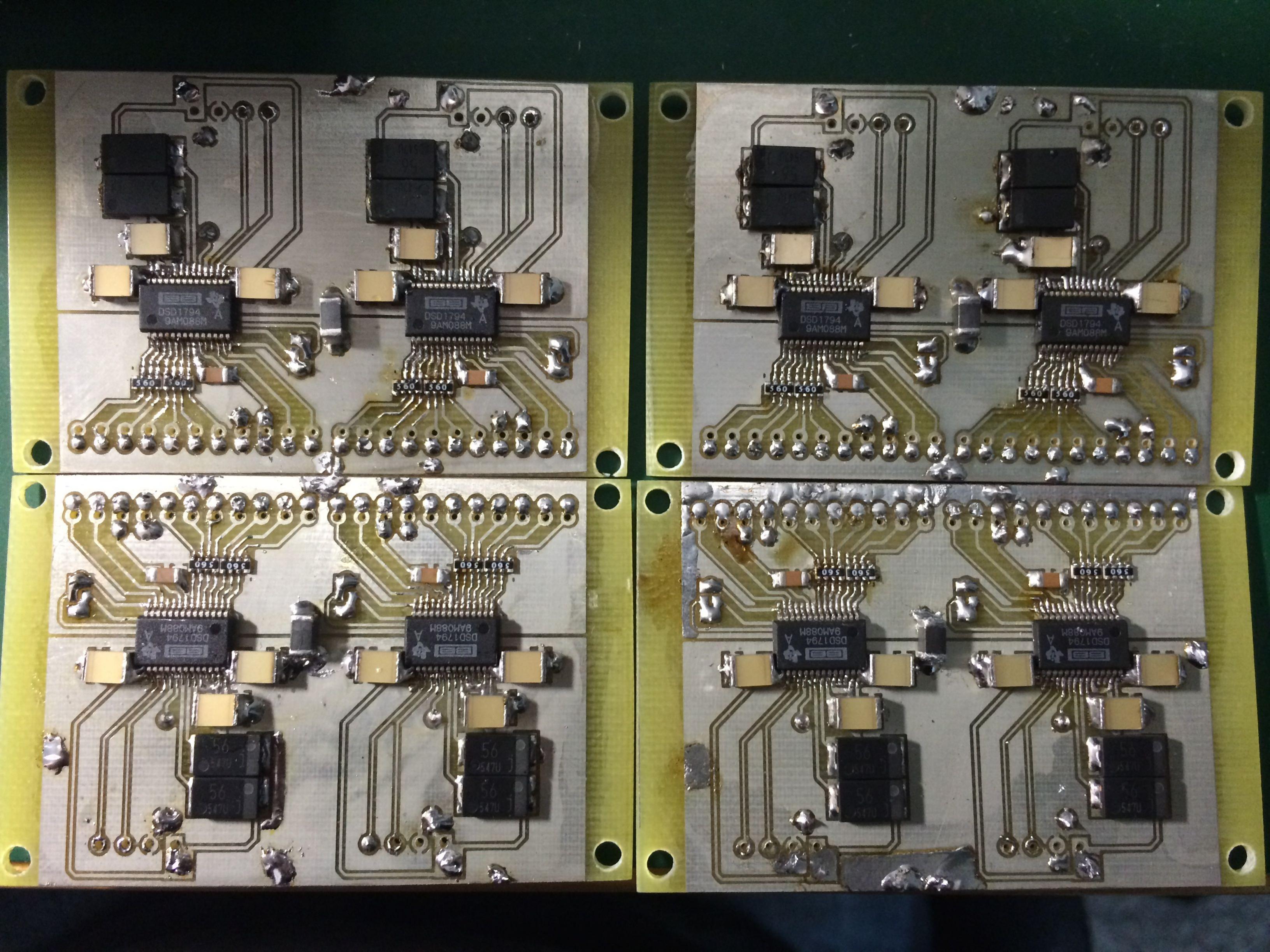

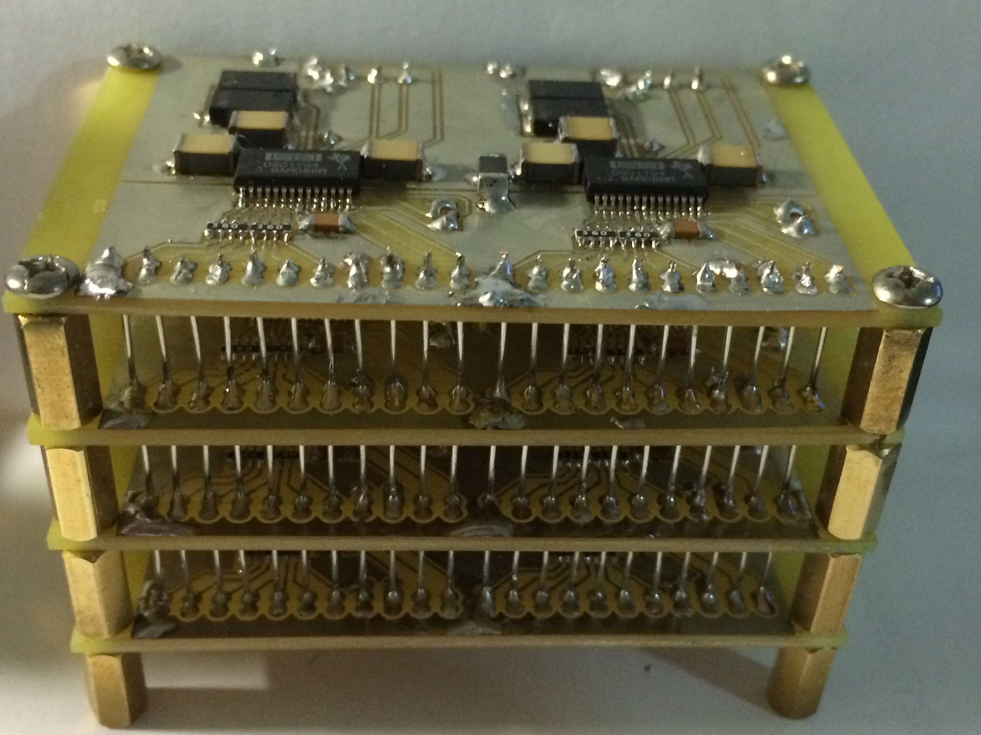

Hi 2A3SET,
Congratulations! ... So you decided to learn Diptrace to make it happen with your DSD1794 design ... And altogether 8 DACS - wow ... I'm thinking (with a smile 🙂) that you'll almost be able to drive the speakers directly ...
No, just kidding ... hope it is as you'd like it ;-)

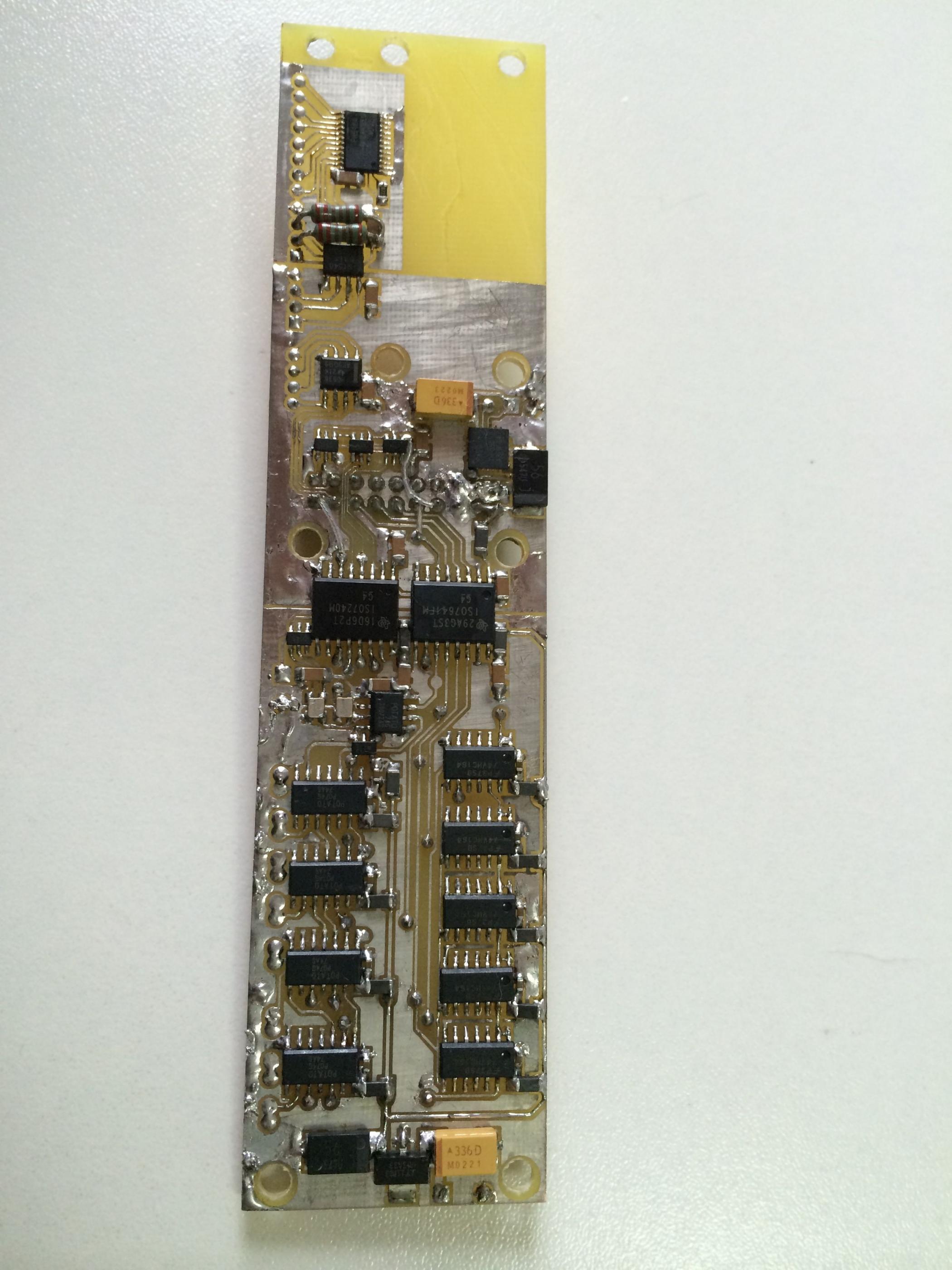

Thanks Jesper, have couple of more pics at
http://www.diyaudio.com/forums/digital-source/257806-parallel-dsd1794-nos-dsd-passive-i-v.html
It's pretty natural sound with native DSD (SACD RIP) and more chips in parallel, together with using latest foo_dsd_asio to convert DSD64 to DSD128.
