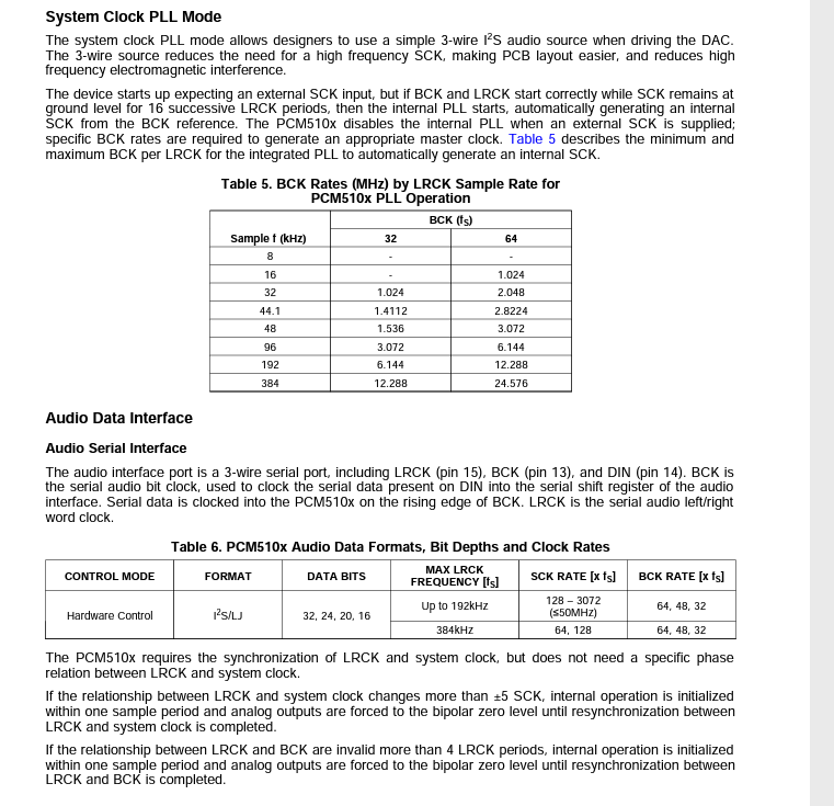

yes, i am having difficulty understanding that table, This would be my first DAC-based project.
and
if I were to use a PCM5102A could someone explain me that please- its table.
