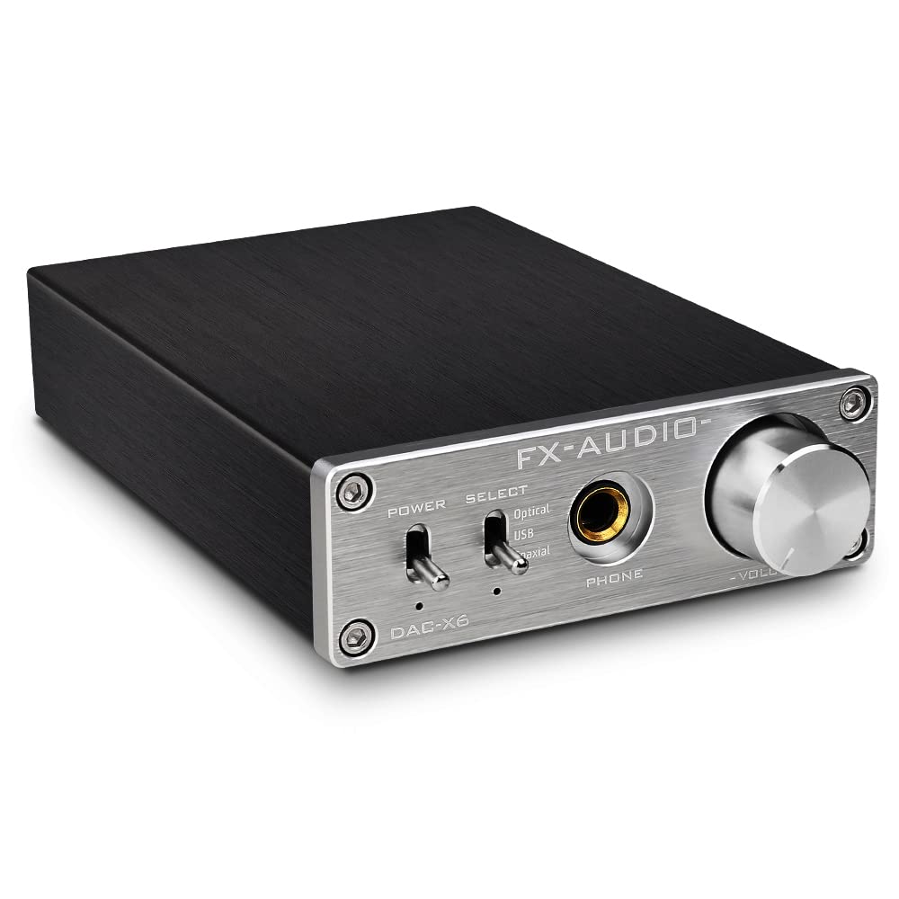

Hi. I measured 2 different DACs. Canary dac and FX audio dac6x. Both gave same signal value. 500mV pp max.I opened 1khz signal 0dbrfs on YouTube .I connected it to Samsung TVs via optic cable. Is the value normal ? I couldn't find output values on datasheets of them.
