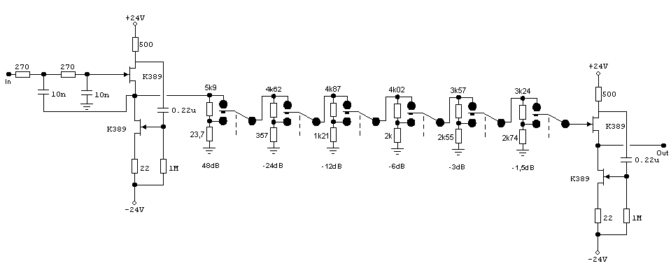

Isn´t the PCM1716 a delta-sigma DAC that does not need a I-V converter ?
In that case it should work.
And Freddie:
Have you built it yet and how does it sound ?
Yes the PCM1716 is a voltage output DAC.
No I haven't built the circuit yet (currently building a new power amp), but I will try this out when I've got time.
