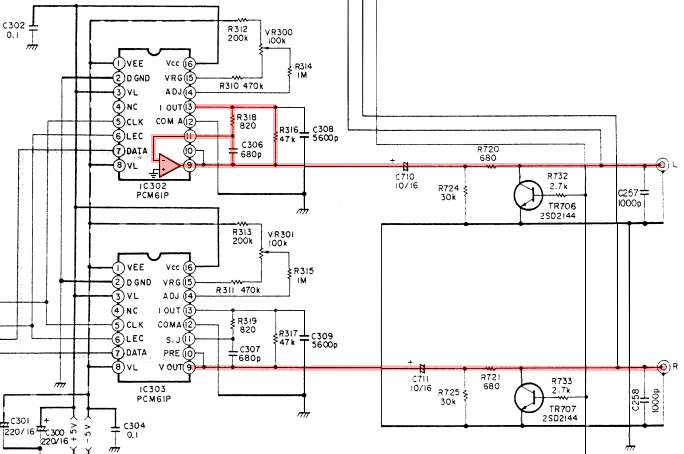

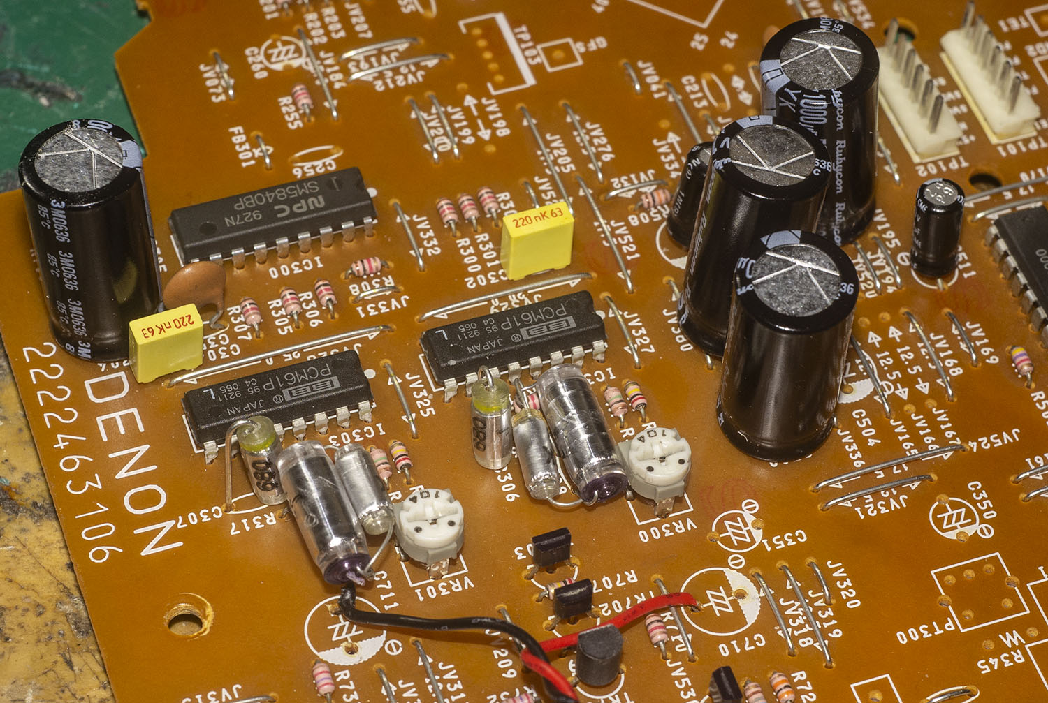

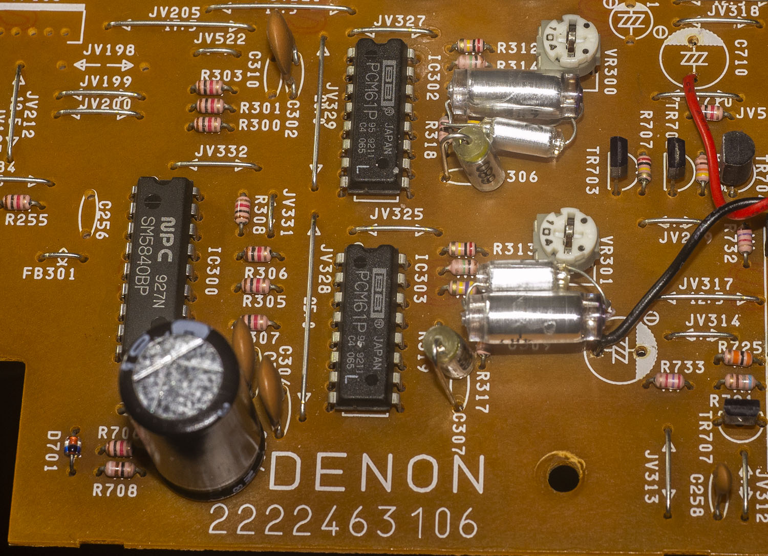

The application for the I-V converter is to upgrade a Denon DCD-590 I got for nothing. It's using dual PCM61s but instead of having an analogue output stage with opamps like most of the dual PCM61 CDPs I've seen, it uses the Vout of the DAC chips and a 10uF DC blocking cap. The digital filter is the SM5840.

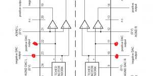

TDA1547 is a bitstream DAC chip, no need for I/V there. But it needs a modulator (SAA7350 or TDA1307 if I remember correctly).

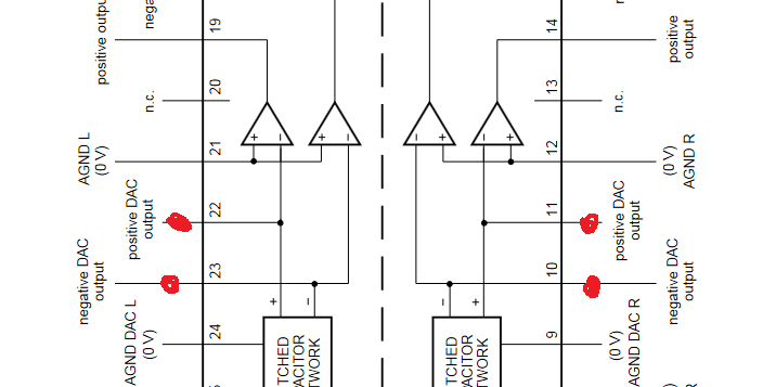

Yes, but the current output can be drawn from pins 22 23 and 10 11, the current is 0.1mA. For now, I will use the ADA4610 for I / V.

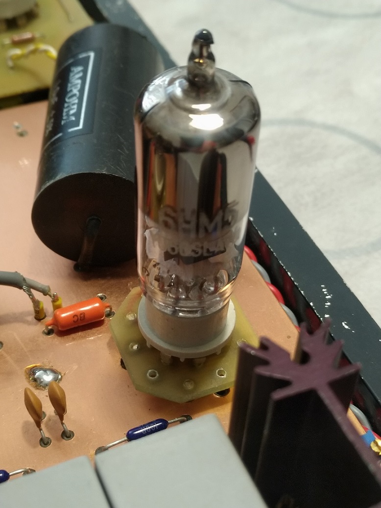

In my stock I have two pieces of TDA1547 and three SAA7550, and soon I will have SM5842 for the filter, I already have PMD100 but it is in the DAC with PCM1702 where I used AD811 before, now I use 6HM5 tubes for I / V.
How do you stop the on-chip opamps of the TDA1547 interfering with the S-C DAC output current when you connect an external I/V opamp?
Configure the op-amps as buffers. Connect the negative input to the output.
On the schematic, the S-C DAC's output goes direct to the -ve input. So if you connect the -ve inputs to the outputs, how to extract any current? The 100% negative feedback will give a very low impedance load to the S-C DAC.
It is what Philips do with the opamps on the SAA7350 when it is paired with the TDA1547 but looking closer there are significant differences between the two. That idea won't fly very far, if at all.

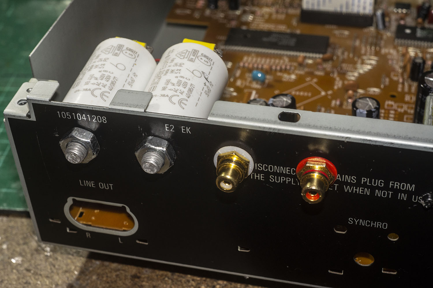

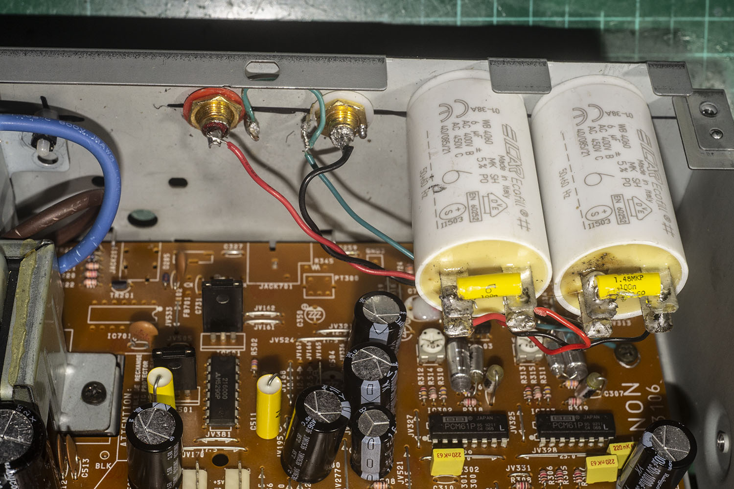

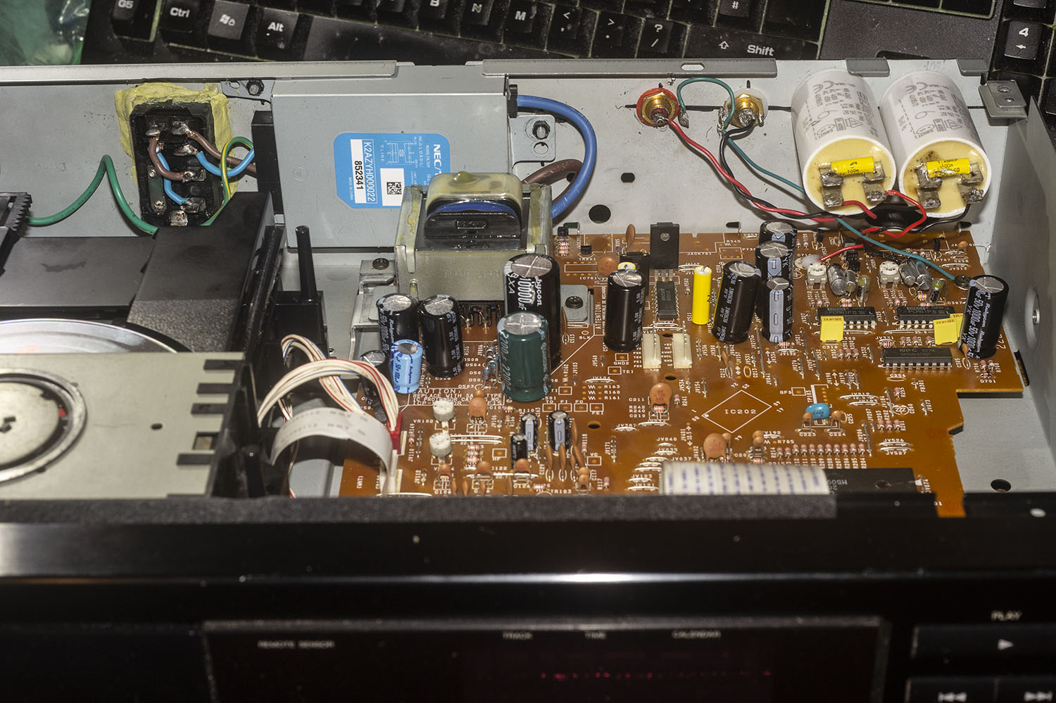

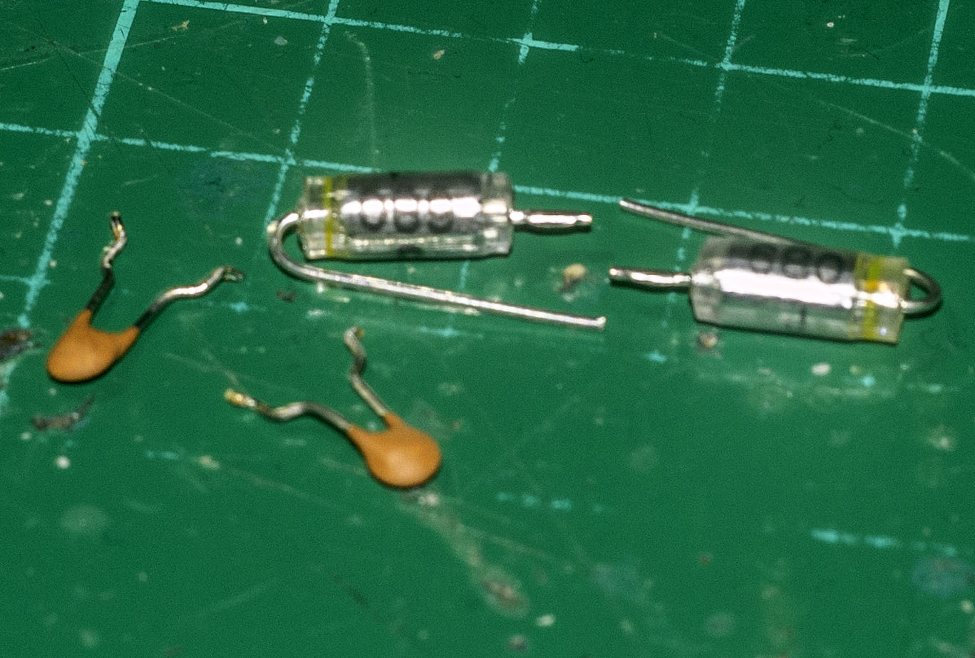

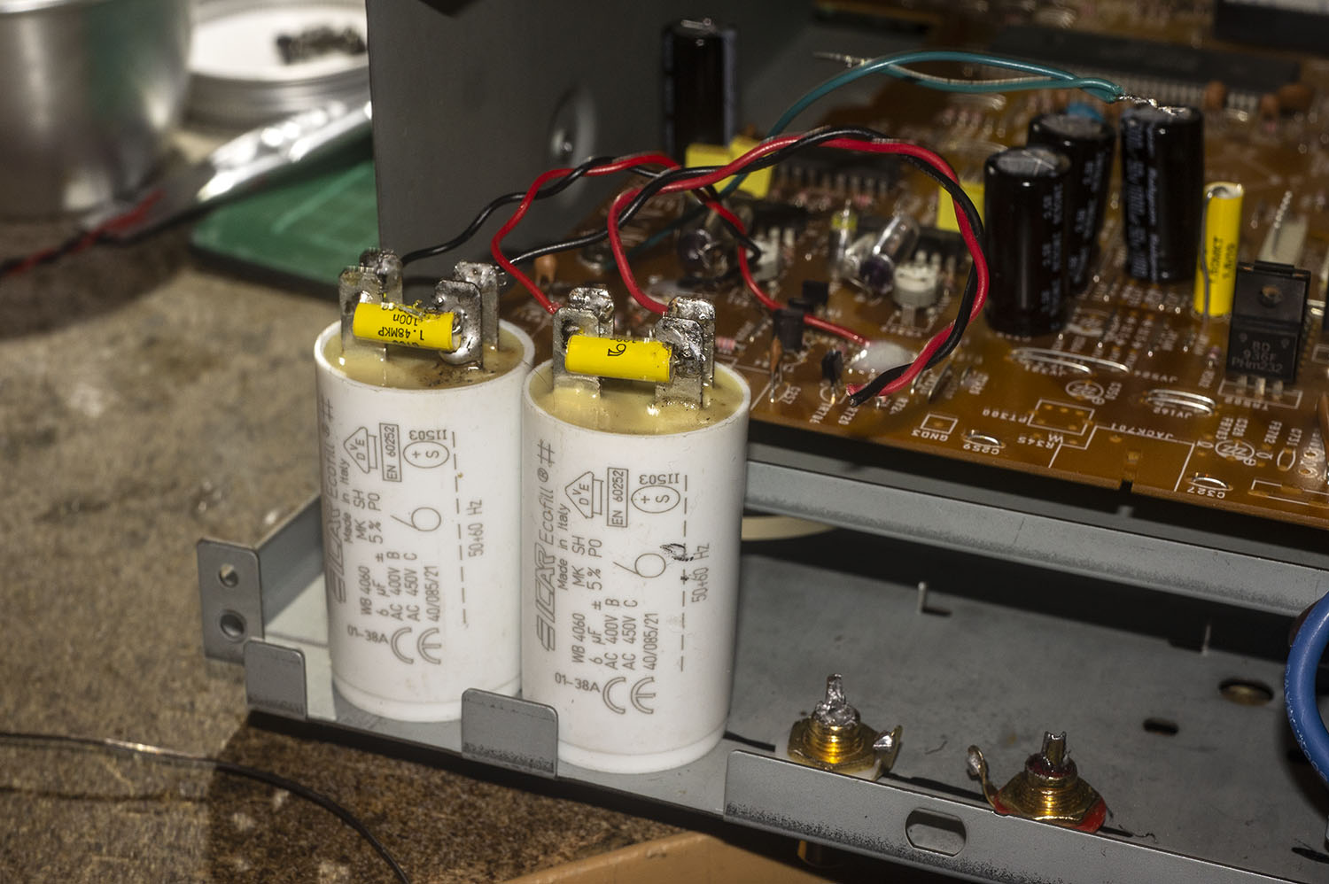

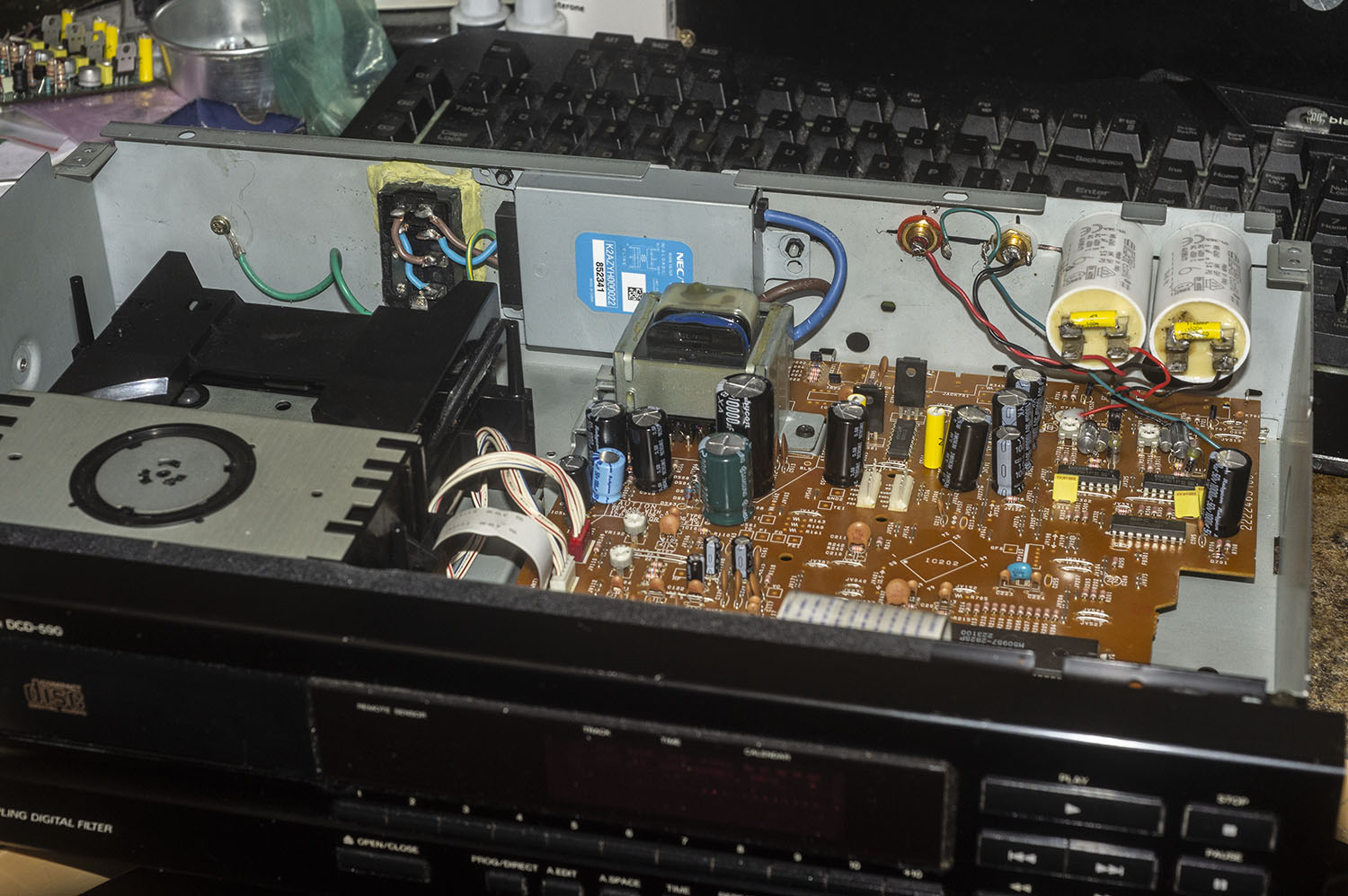

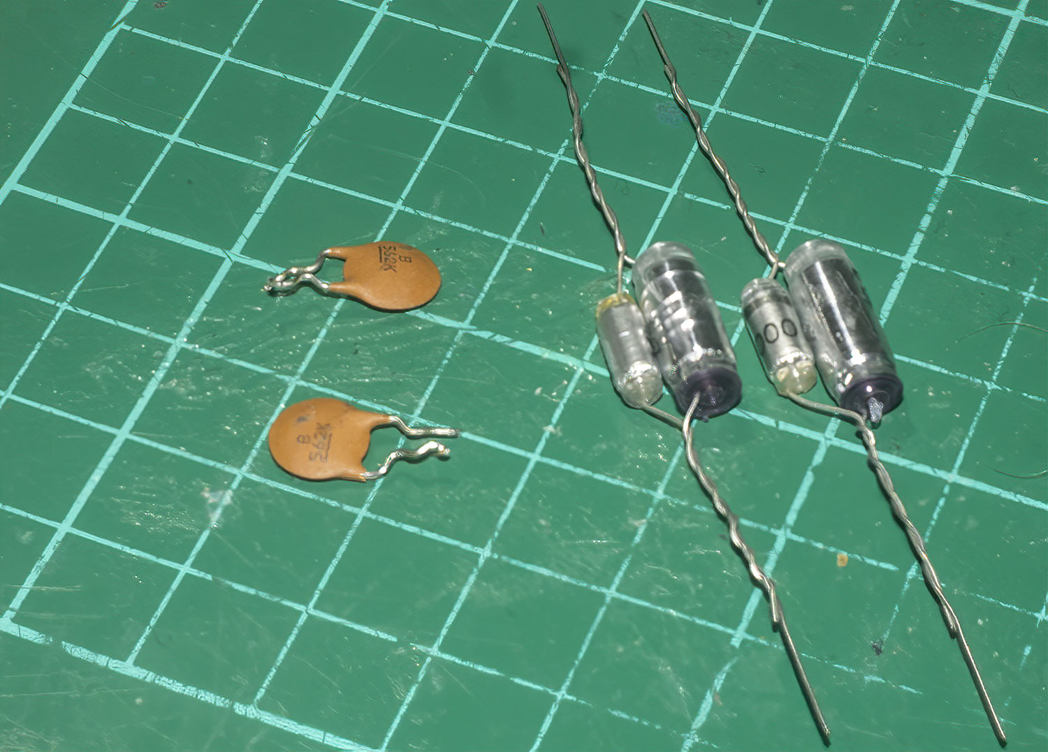

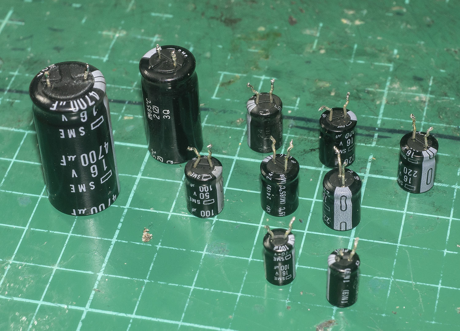

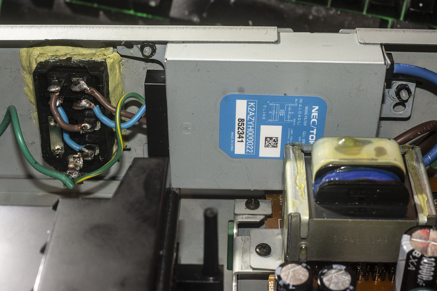

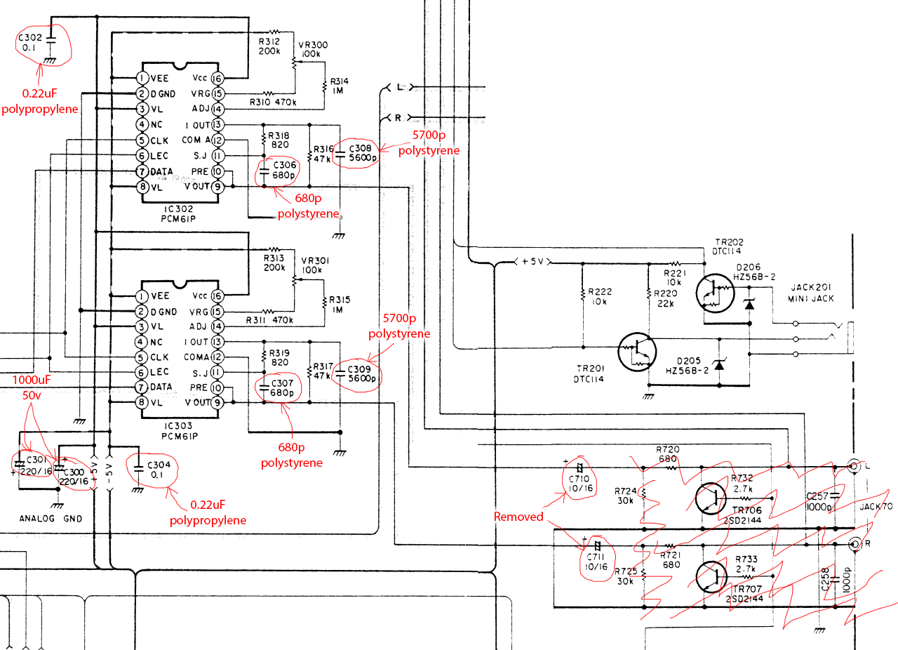

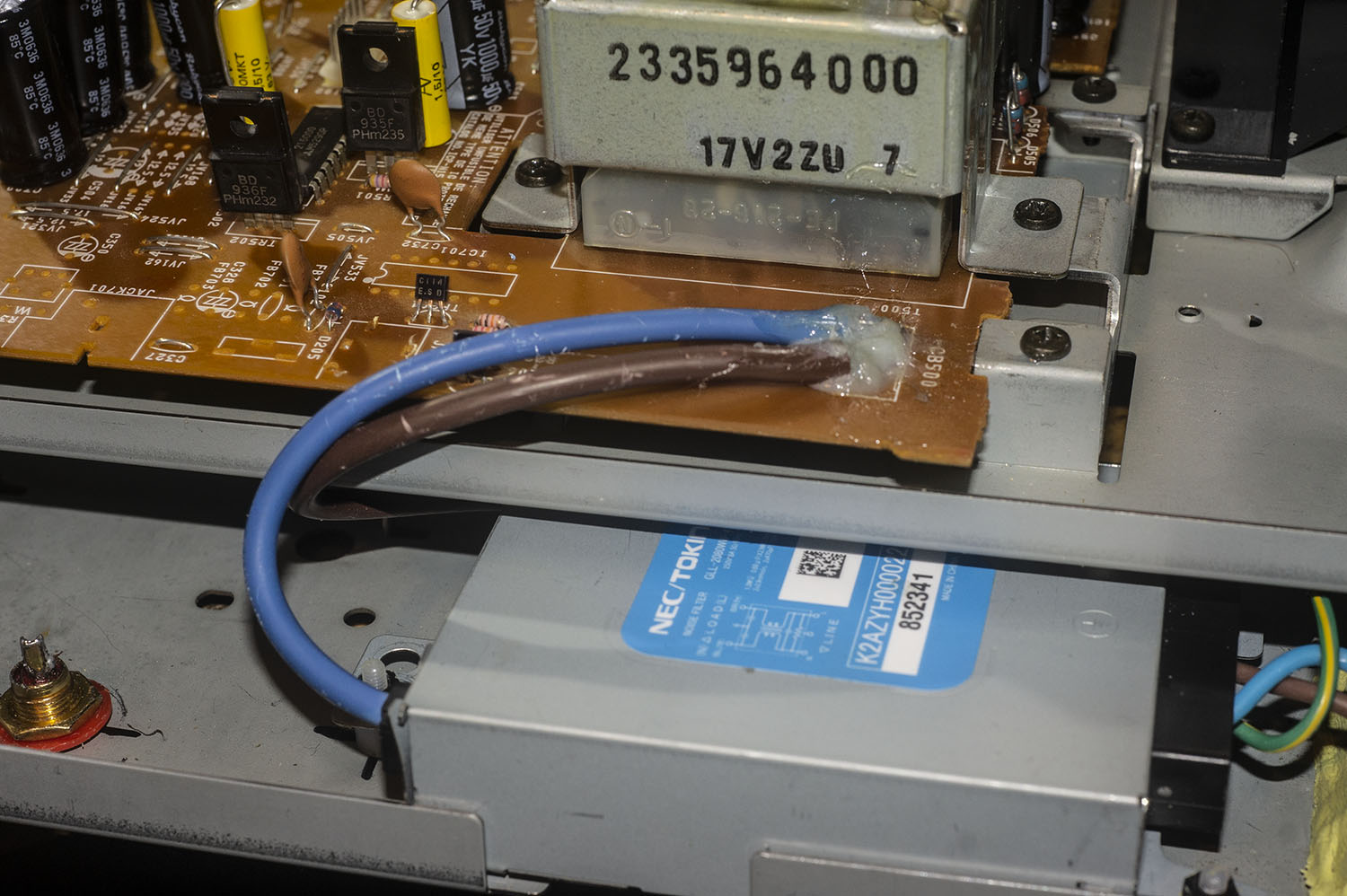

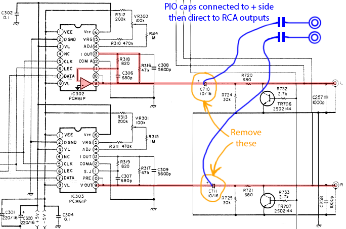

Well, the application I had in mind for the I-V converter was to upgrade this Denon DCD-590, but having reworked the player a bit by replacing the caps in the LPF with polystyrene ones (Denon, the cheap bastards used ceramic disk ones!) and then bypassing the rest of the output stage to a pair of 6uF polypropylene caps, it sounds pretty good actually. I also added an NEC/Tokin noise filter to clean up the AC input and replaced all the large electrolytics and all the electrolytics in the PSU section.
It actually sounds pretty good in this state, without replacing the dirt cheap oscillator with a proper clock and without giving the DAC chips their own, clean regulated supply, so I don't think I'll bother doing anythign else to this player and just leave it as it is now.
