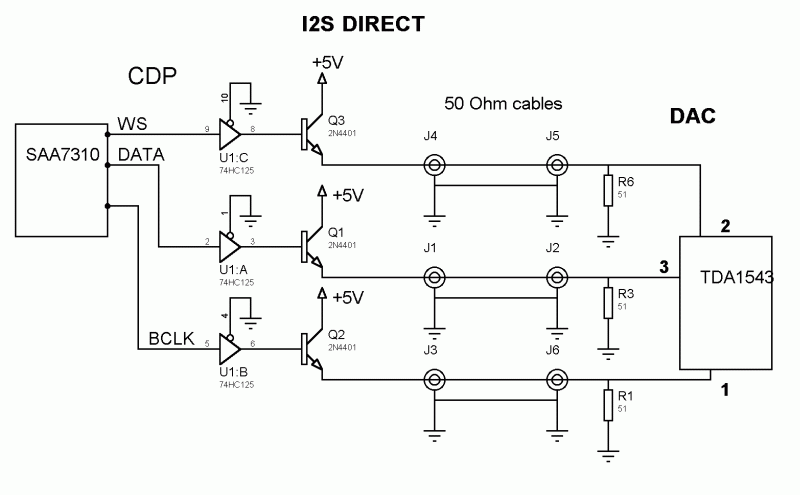

OK why it sucks:
1)The SPDIF is sent through a 75-Ohm transmission line but by standard it is wrongly terminated with RCAs / Cinch.
These are NOT 75 Ohm so reflections result. Often NON 75-Ohm cables are also used worsening the situation.
2) The clock is generated from the SPDIF stream with a PLL, as the datasheet of the CS8412 indicates lower frequency jitter is not suppressed. Anyway the clock is far less good than in the player.
3) Many Philips players use a very poor SPDIF driver especially the transformer.
All this trouble to get all audio through one coax cable.
Also imagine one has 1st to encode SPDIF in the player then decode in the DAC.
I2S Direct is far more simple as this encoding/decoding process is omitted. Yes one has to drill holes. Even four if you have a DAC with digital filter. [DATA, BCK, WS, CLOCK]
I have buffered the Spdif from my CD304mk2 with a chip DS8922. Removed transformer and coaxial jack, mounted Svhs socket (differential output) All Ecdesigns idea. Spdif output waveform on scope looks sharper now (less jitter for sure) Will try a dac soon.
Interesting I2S solution.
