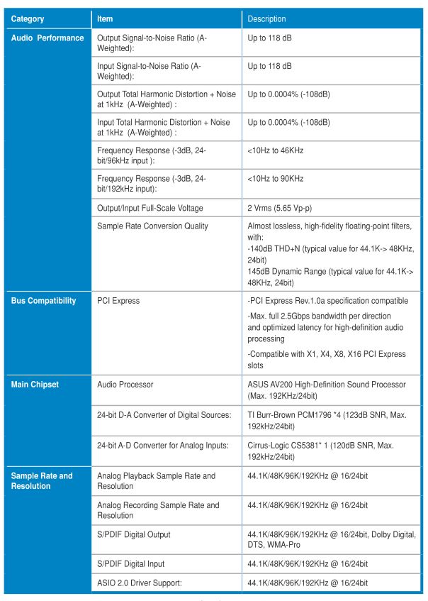

As it was said before, a PC is not an easy thing for music reproduction. 3 things which make life better when hearing music over the PC:
A high quality, low noise PSU. Same quality intern or extern Soundcard (a used Xonar D2X is about 25-30$). Lossless audio files.
