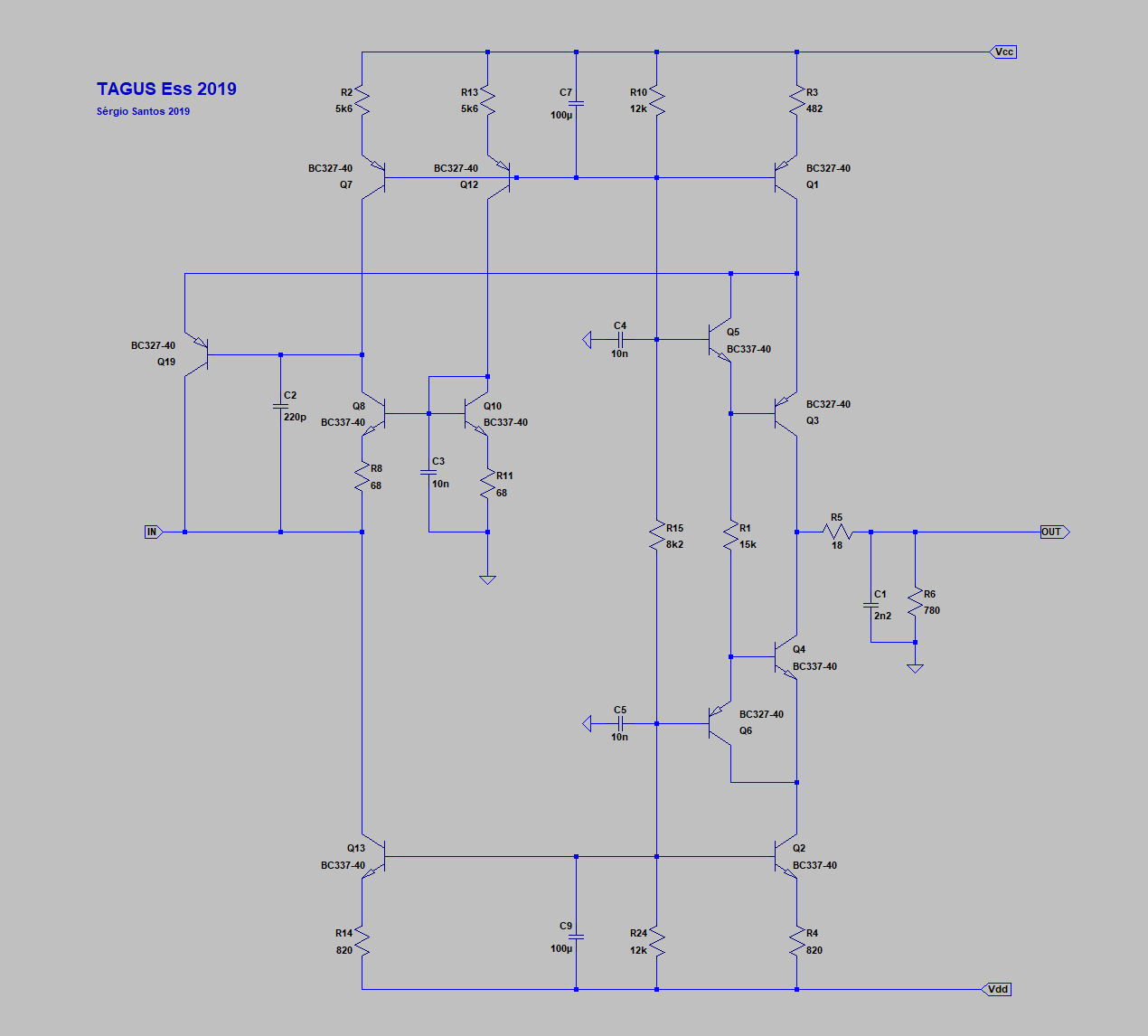

The circuit has very high NFB current feedback by the collector of Q19 to the input. The very high gain is due to the impedance of the CCS Q7.Conclusion
What makes it even more remarkable is that it is a "zero-feedback" design with lower THD(+N) than high-specification op amp with feedback. Kudos to @smms73!
These measurements are very valuable to those who design IV stage.
