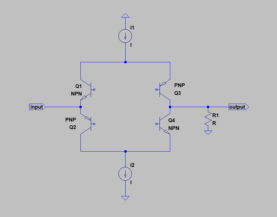

It's good to see that you are still making innovations on your interesting transimpedance open-loop Tagus-X circuit. If you have any simulated distortion plots for this version, could you post? Thanks.
By the way, I also find the occasional linestage (high input impedance) transconductance variations of the Tagus-X just as interesting.

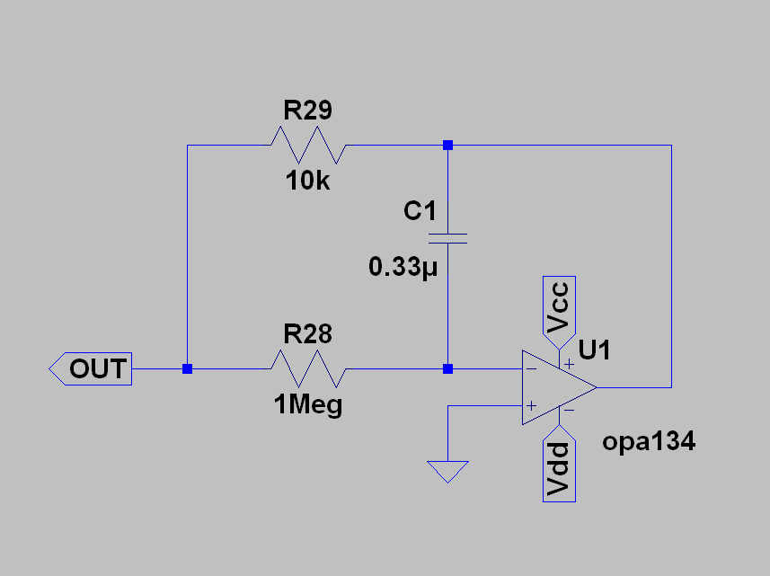

Is there a chance to remove coupling cap using dc servo and 6.2 mA ccs Injected to the Input
1) Q7 sinks the PCM1794A's 6.2mA output bias current.
2) An inverting op-amp servo could be attached right at the circuit output. Where the servo's input and it's output both are connected to the same point, which is the Tagus-X output node.

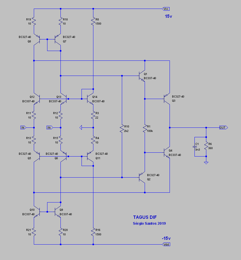

Tagus DIF

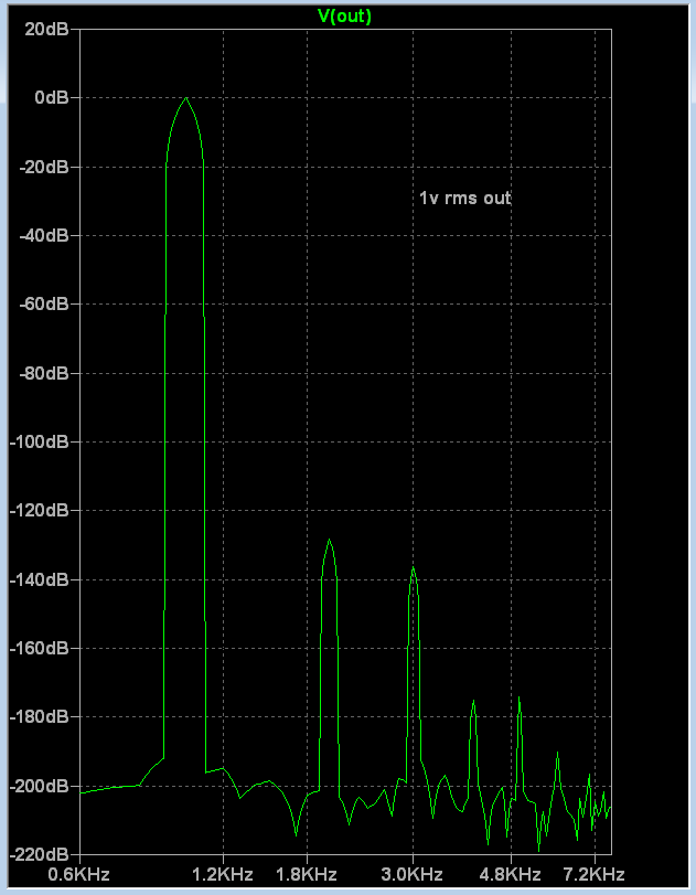

Here is what you are looking for Alexander, The distortion is 0.00004% at 1v rms and 0.00016 at 2v rms.

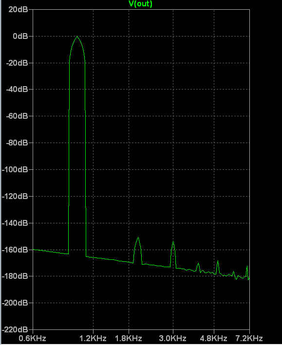

Hello Ken, thank you for your kind words, distortion at 1v
Wow, the highest harmonics are 150dB down! Essentially, distortion free operation is predicted. One of the Tagus's implementation aspects which I always found very interesting is that it doesn't much depend on the matching of transistors. While some versions do appear to utilize a short local feedback-loop around each folded-cascode, there's no global feedback. Impressive.
I note that the single-ended circuit appears to features 20dB lower distortion than does the differential version. Is that mostly to do with the differential version canceling the PCM1794A bias current as D.C. common-mode, but, in doing so, that causes the Tagus-X circuit bias to be imbalanced?

To have ov at output and very low distortion we must have the best current mirrors we can, so resistor (r18,r19,r20,r21) should be 100 ohms and must be at least 0.1%, best is 0.01% tolerance, the bjt Q7,Q8 and Q9,Q10 ideally should be dual transistors like the BCM847DS and BCM857DS this transistors are SOT457 witch is easy to solder, they have Current gain matching and Base-emitter voltage matching with max 2mv difference.
with a 0.01% error in the resistor we get 1mv in output and 0.000023% distortion, with 0.1% error 7mv and 0.000055%, with 1%error we get 80mv and 0.0006%
the Pcm1794A bias current is not a problem at all, the differential version use a current mirror that have some limitations, the Tagus X circuit are feed with current sources with very high impedance so the current variations at the input of the circuit don´t have anywhere to go but to the output of the I/V converter I also make sure that there is no early effect distortion,
Hi Serjio,
regarding differential version
using dual matched transistors for current mirror Is great Idea
I guess that also It Is recomended to have all NPN and PNP pairs closed or even better, matched
as we know there Is no Ideal things In real world, can we do fine tuning of output dc offset If we use potentioneters at R18, R20
still not sure about dc offset trimming of final Q1, Q2, Q3, Q4
what Is output Impedance and do we need to add buffer
regards
The output impedance is 360 ohms for 2v rms output and 180 ohms for 1v rms , no need for buffer.

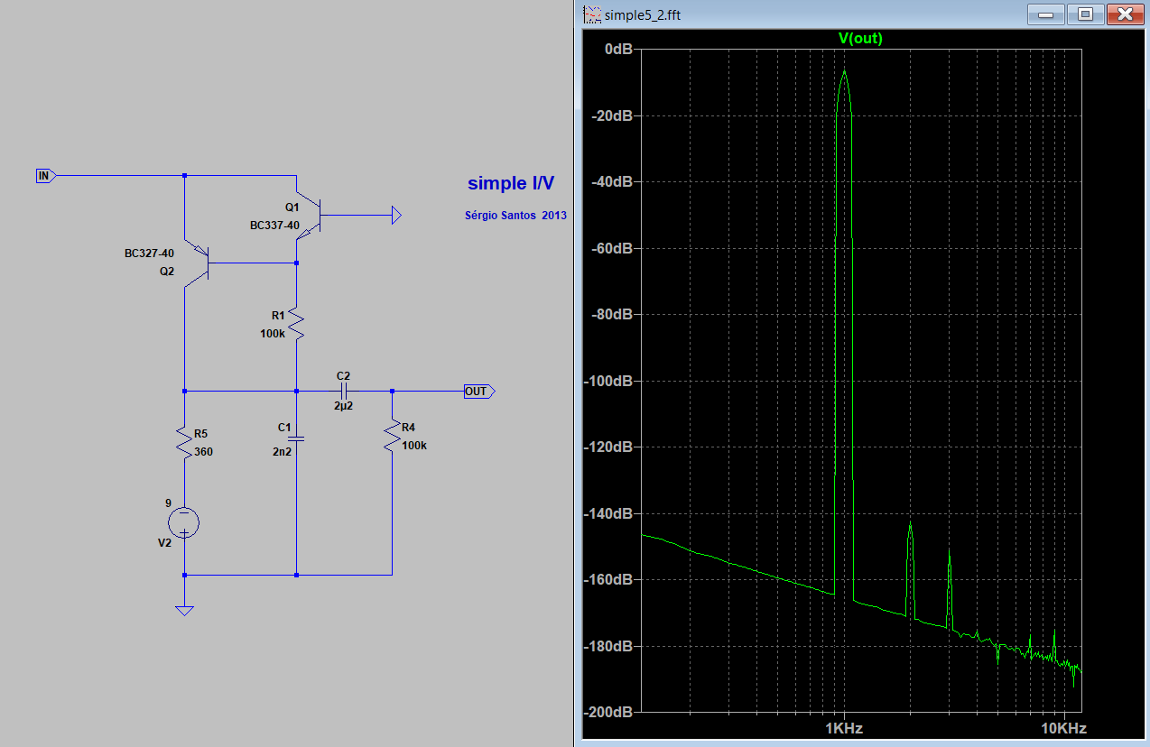

simple I/V
Nothing is simpler than doing an i / v converter for pcm1794 with very low distortion.
This is an I / V that I built some time ago, as psrr is zero the power supply has to be noise and distortion free.
Perhaps a good idea is to use a 9v NIMH battery with a large capacitor in parallel, this circuit only consumes 6.2mA and the distortion is ultra low if you have the ability to make a good power supply.
