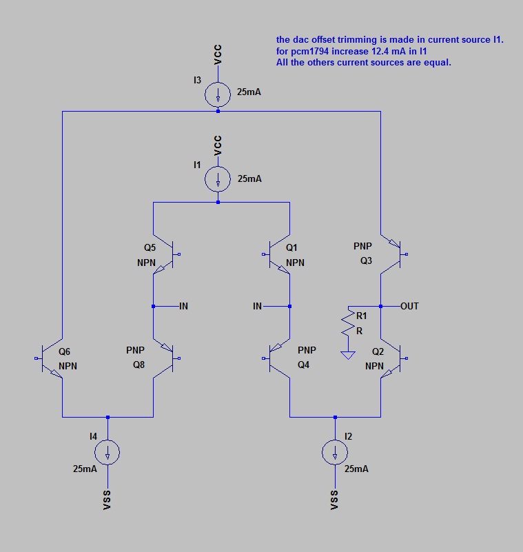

This topology is very flexible.
below is one solution for this "tough problem".
It has CMRR capability and PSRR ( all the connections to power supplies are made by current sources) and low noise, low distortion.
We make a very good team.:cheers:
You are good in finding problems...
and i like to find solutions.
Just kidding , i find very challenging your observations, and i thank you for that.

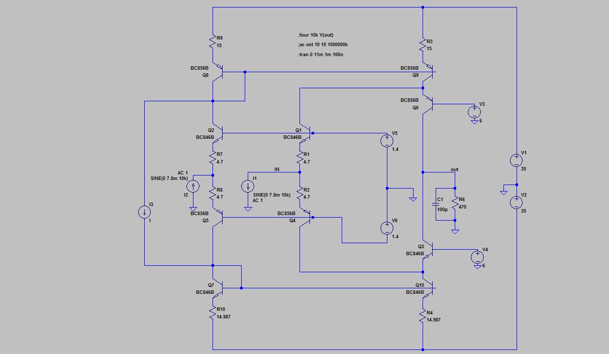

To use a mirror in the second stage or a folded cascode is a bit a matter of taste.
In post 70 we even see a mix of a mirror and a cascode.
What i found most interesting from the beginning is the returning of the base current. One of the major problems of BJt circuits.
In the Sampler mirror the idea is not that different but the solution. The Sampler mirror looses two base currents and adds them on the output so this is feed forward.
I'll watch this, and when the concept is a little more settled, I'll start simulating and add servo-ed housekeeping, but first we must decide the front end and how to get the signal out from there...for me the optimum would be to use cascodede current mirrors to currrent assemble the signal. This gives us the option of adding a filter, We could then buffer using Joarcims N-Fet buffer and servo through the housekeeping, this has proven to be a s strong solution in the paradise, Cant see why it should not be a very good solution here as well...
a question is how to handle the offset center current

Right, the typical following balanced to single ended opamp in the circuit shown in the DAC data sheet has the CMRR to reduce distortion. The bad thing about these classic circuits is that the first stage inverting opamp will contribute some distortion from the common mode signal which will not be canceled by the following opamp. I feel that it would be ideal to have a first stage connected to both the Iout+ and Iout- pins with a high CMRR. So, your proposal would be terrific if it does have a high CMRR also. I'm not talented enough to come up with a good circuit like this.
Normally a CCS current drive has extremely high PSRR the better the CCS the better the Ratio..CCS also has a great distortion benefit, as the signal than can modulate the working conditions of the circuit, and the DAC currents becomes truly purely additive/subtractive in nature.
