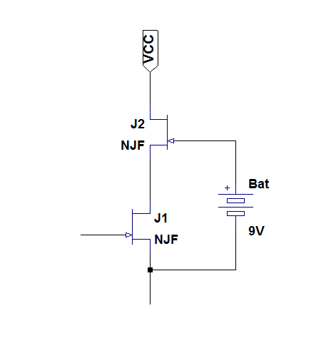

In the design of that buffer have you guys think about adding a battery to the gate of the upper jfet, with less than 1nA of leakage current a litio battery will last forever. And the voltage of source to drain of the lower jfet will be higher .
I like the BF862

I agree that the voltage is too low across drain source. What I do instead, but that takes a few more components, is to use a Zener diode with LP filter, and then a transistor. You can then set VDS to what you prefer.
I like the BF862

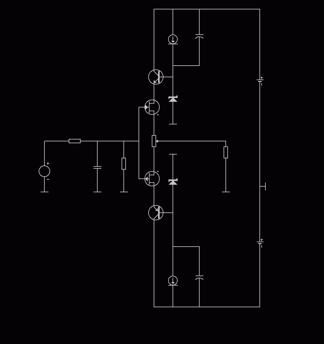

Well, to have a fixed VDS is the point 😉
Reasons for higher VDS than VDS = Vp:
1) I can have a VDS that makes the semiconductor sounds best
2) Use a VDS where the JFET is most linear
3) Higher VDS means lower capacitances

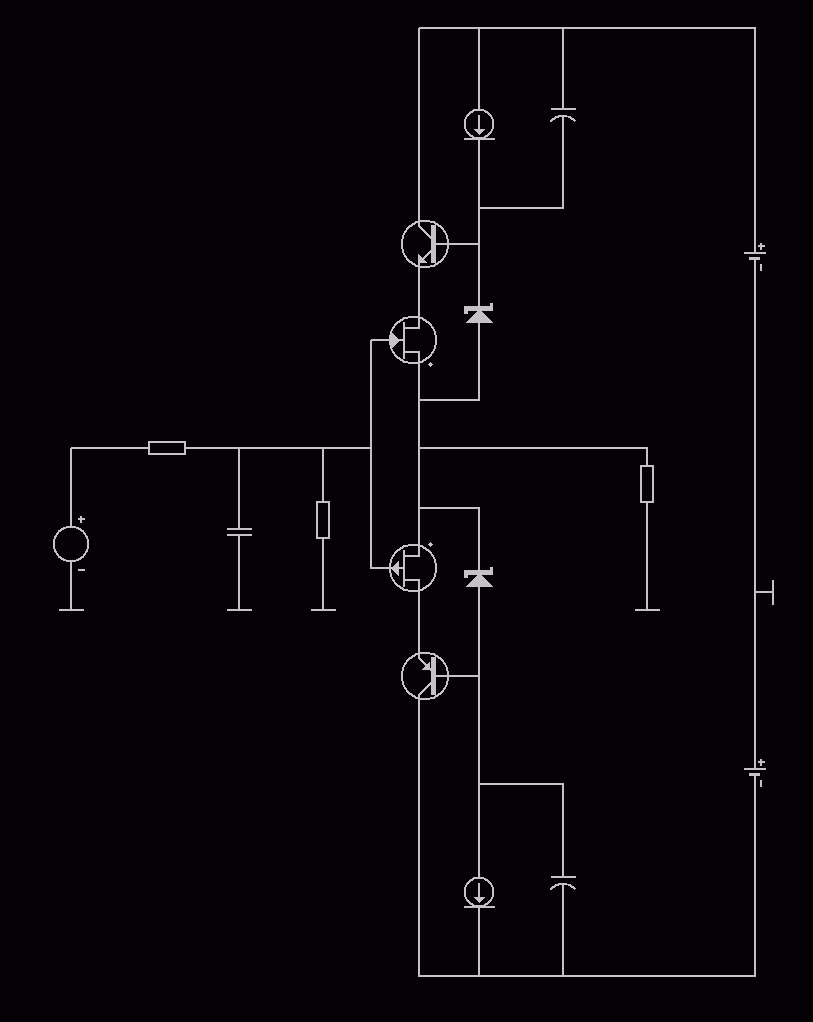

Attached are two different ways to cascode for higher than VDS = Vp.
What is the benefit of a higher VDS..?? and Why would you want to create a fixed Cascode..?? then the voltage swing would still have to throw charge so the capacitance comes into play.

The cascode schematic on the left above, is also a driven cascode if we by driven mean that Vds is locked to the source and not to ground. The cascode I describe above I did not show yet (as it contains rather many components).

Our design is a driven, floating cascode, your design is a fixed cascode, parallel symmetric.
VDS will not be Vp as I wrote but it will be Vgs as you say. In my simulations, I use a j310 with VP=-3.6V but the Ugs for it is only -2.1V and those 2.1V will be across the lower JFET's VDS.

staccatiss, in the buffers that you present in post#649 the capacitors should be parallel with the zeners not with the ccs, I like the idea of using mosfets , but carefull as some mosfet have to much capacitance. the left schema is equivalent to a floating cascode , and is much better than the one from the right. I use this configuration also in some amplifiers.

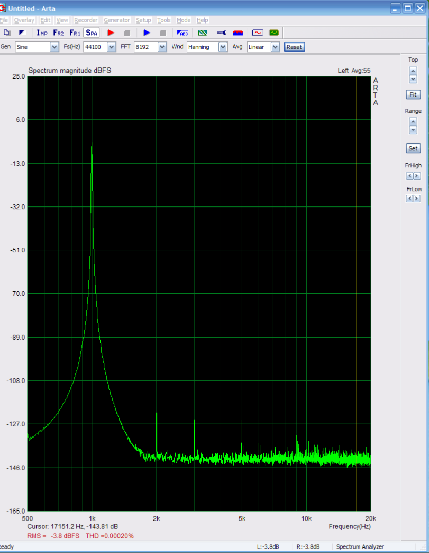

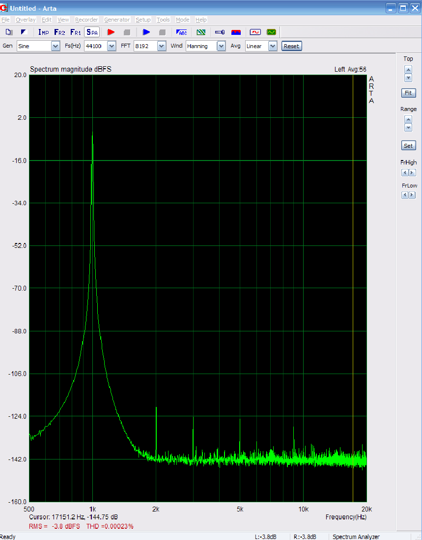

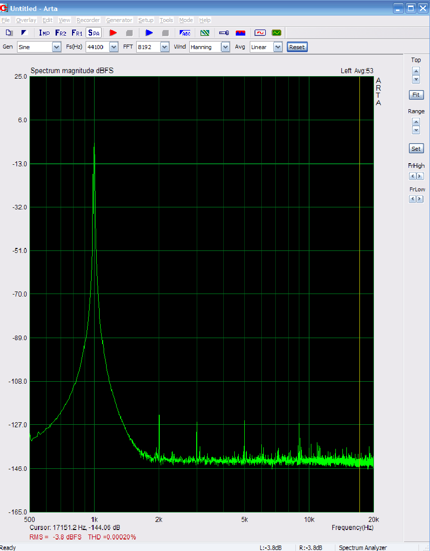

I have made some tests, the conclusion is that as long as we do not use devices with large parasitic capacitances like for example irf510 , there will be no alteration in the linearity. I recommend use floating cascode in buffer to mantain vgs constant, devices like irf510 can be use with floating cascode also.
The first image is without any buffer, second with 2sk146 third irf510 and the last bs170, the output resistence is 1K and 2,5 Vrms all the buffer dont have floating cascodes on purpose. the distortion is measure at the output of tagus.
