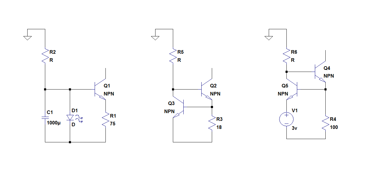

Ok, now i only have to choose a current source.
in this pictures there are 3 current sources the first one does not have a higher output impedance, but have low noise, the second have high output impedance but have more internal noise because R3 is only 18 ohms (this is the current source that i have in the prototype ), i want R3 to be 100 ohms, so the soluction is maybe the third current source where a low noise voltage reference (v1) is used . what you guys think? Suggestions are welcome.
You could use 2 red Leds in series for V1 in version 3. You could shunt the Leds with a high value cap.

Ok, now i only have to choose a current source. Suggestions are welcome.
Sergio, while not a direct answer to your question, here are the hyperlinks to a two part article you may not have yet seen which explores various audio current source circuits. It is written by the esteemed Walt Jung.
http://waltjung.org/PDFs/Sources_101_P1.pdf
http://waltjung.org/PDFs/Sources_101_P2.pdf
for the best current source use a casodede Jfet.... oh... do you need lots of current then you can parallel more.. the casode makes the impedance of the current source much much higher Tera ohms, but only to a fen hundred KHz than the capacitance swamps it..
I don´t know where i put my box of jfet, i don´t have one jfet.
I will try that.

How about a cascoded CCS using adepletition MOSFETs? Walt Jung presents a low noise type which s a follow up on his two-part article about audio CCS.
http://www.waltjung.org/PDFs/Sources_101_Letter_Revisit_0409.pdf
For lower currents you can of course use JFETs 🙂
/S
Thanks Ken for the links, i will read that for sure.

If you prefer BJT's, you could also try the C4S current source (Camille Cascode Constant Current Source)
http://i41.servimg.com/u/f41/17/21/94/71/calcol10.png
second CCS ought to be most low noise.lower resister emit lower noise.Ok, now i only have to choose a current source.
An advantage of first and third is capability of thermal compensation of BJT's tempco with diode or so.
the voltage source in third CCS should be positive tempco, so LED, which have negative tempco is not suitable here.
about 6.2V-7V zener diode can neutralize Vbe tempco.
But be careful, zener diode emit much noise than other diodes.
