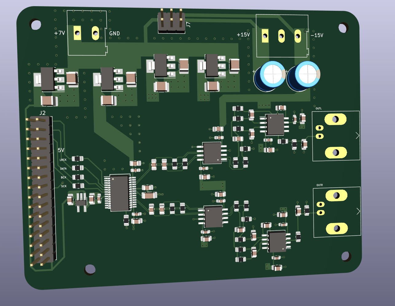

Hi, I want to build my first DAC , I don't care about performance, just for fun.

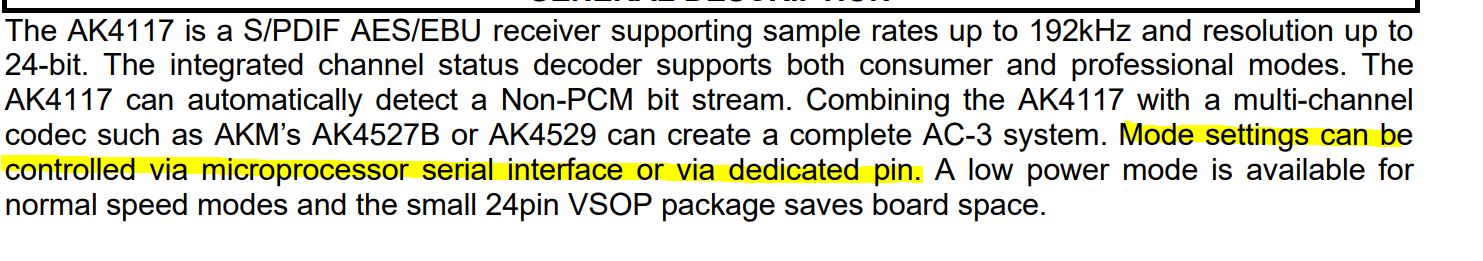

I was looking at AK4117 for spdif receiver, and I don't know how to config it, can I by PINS ( switches to select different modes ) or I need a micro controller, processor for that? .
Can it run by itself?. no MCU,
For DAC , CS4360, CS4340, PCM1680,
- Old ic's here. I know. Just wanted to build something for fun if possible.
- Cheers, Bruno.

CS8416 is a good choice. It can be configured in hardware mode without MCU control. Various mode selections can be made through pins.
