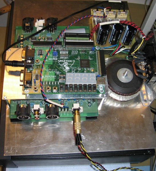

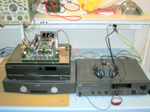

DAC finally assembled
Finally, after working on my audio DAC for years and years, I have an up-and-running prototype with all parts owned by myself, nothing borrowed from the various labs where I have worked.
Just wanted to show you some pictures of it!
Some details:
- I tap the CD player I2S signal and the crystal oscillator there. S/PDIF is an option. (Want to improve oscillator in CD player and move it to the DAC board.)
- Home-made 8x digital oversampling filter implemented in Xilinx FPGA. (Want to experiment more with digital filters.)
- Home-made analog filter built around on BB opa2132 (a newer 2134 with lower input offset voltage error).
- Three different filter / DAC combinations. Possible to compare pcm1794 and pcm1794 with same digital and analog filter.
I hope I get to make the top lid for it and bring it home tonight.
Greetings,
Børge

The 102400 byte limit in attachment size limits the kind of pictures I can attach. The power supply I etched myself. The Xilinx board I got straight from Xilinx, and the DAC board was made in Norway by Elprint. They are quite nice with a matrix where you can choose quantities and production times to find a fairly good price. I tried making it in my tank, but it got too big. Besides, no through-hole plating made it a little hard to interface the PCM1794 DACs.

The current filter is for a Spartan 3/200. I have also made it for a Spartan 2e/300 with larger filters. I have been using distributed arithmetic filters this far, but I believe I can make longer filters with the S3 embedded multipliers.
What the code now contains is this: I2S reader, PCM1704 writer, 2-channel FIR doing 2x oversampling, 2-channel FIR doing a final 4x oversampling.
The first filter has 157 taps (every second tap is zero), the second filter has 154 taps (no symmetry/zeros exploit). Both filters use 21-bit coefficient data. Output from first and second filters are truncated to 24 bits. It was actually better to use single rate FIRs and manually insert zeros for oversampling, than to use actual oversampling filters. The reason is that oversamplers can only be single channel devices in Xilinx's Core Generator. The glue logic got a little tricky, though.
Just finished a rerun of the FPGA compilation. Here's what it says:
