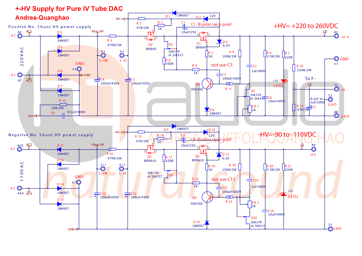

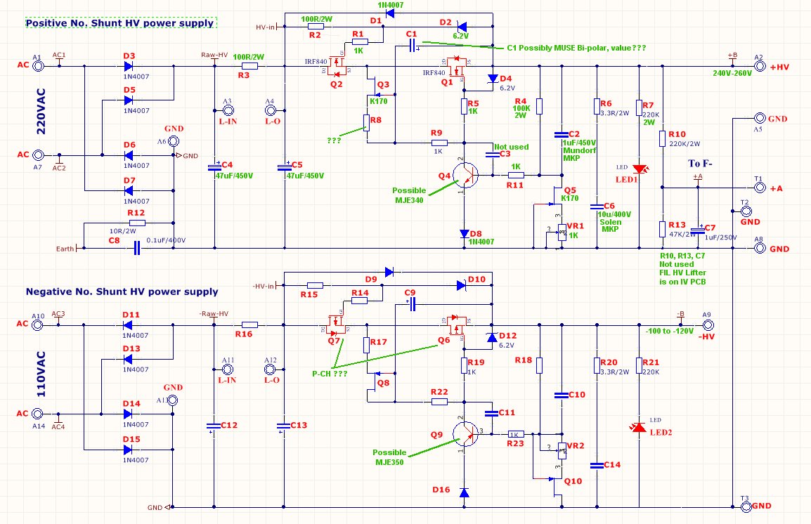

Hi. I bought the DAC with IV Tube output, and there are still some values that I don't know for the HV supply pcb from posted schematics. Check my schematic, can some one tell me what are the value for R8, Q4, C1 on the +B side and R17, C9, Q6, Q7 & Q9 on the B- side?
I assumed that the others missing part values on the B- side were the same as the B+ side.
It seems I can't get these values from Quanghao at the moment.
Also can you confirmed my findings, parts values in Green on the schematic
Any help appreciated. Thanks
SB
SB

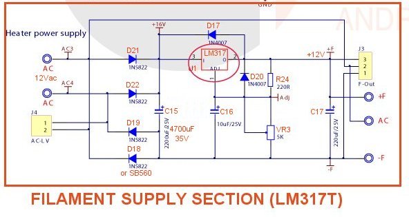

And here the Filament supply section, with correct part ID...
HI!
you use LT1084 is beter than Lm317.
The caps can use 2200uF to 4700uF .
and the HV value, thanks

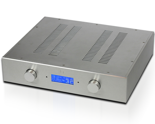

i would like to buy the chassis, please check pm.
thanks
HI!
new chassis is big , heavy and not cheap for all, it is all aluminum !
