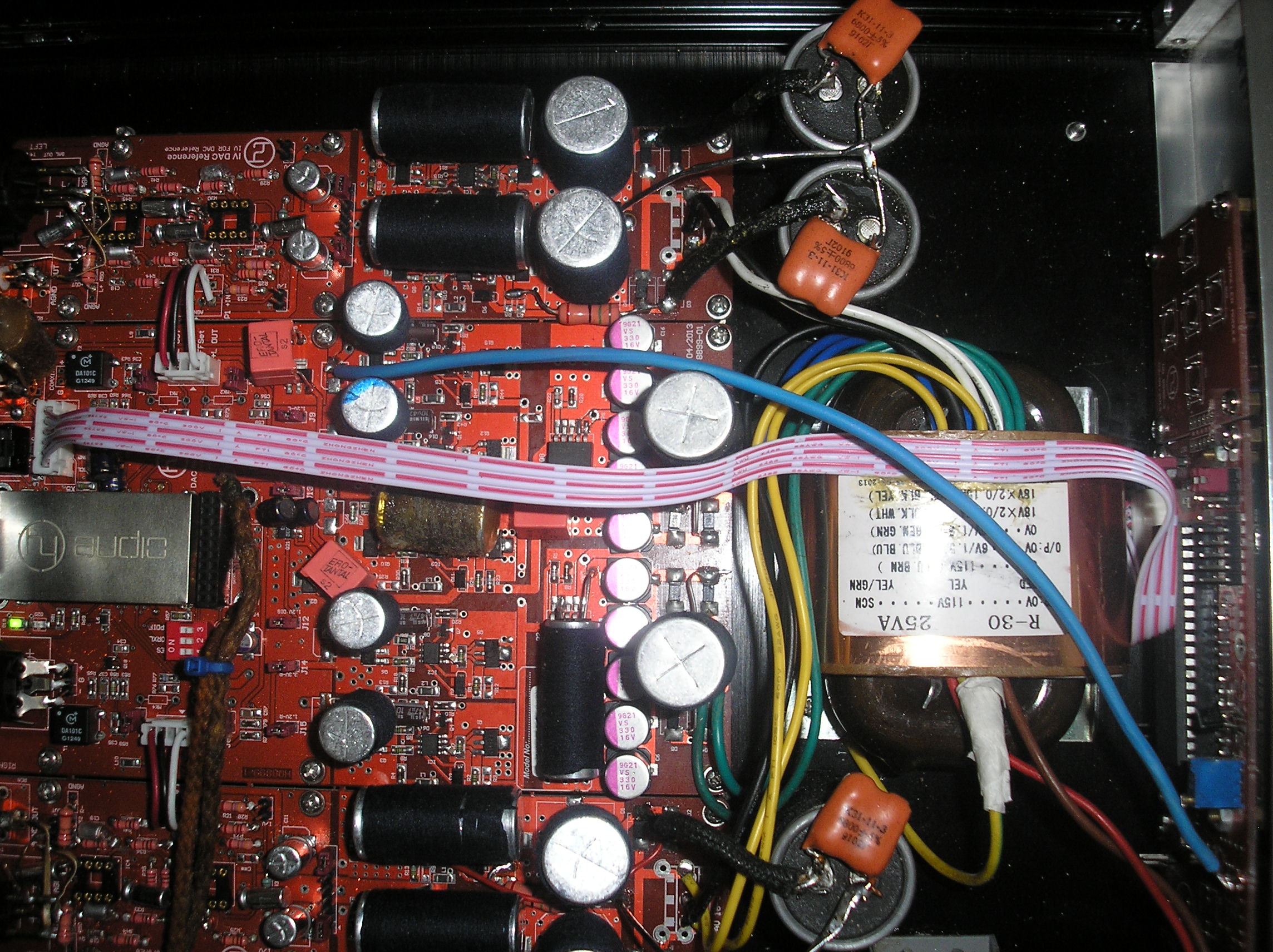

I am confused because it did not work and then everything worked an now it do not. When turning the dac off and on the display change without any reason from time to time depending how long it have been turned off. Buttons do not work and remote not either.

I do not know what Code for standby means. After 4 hours turned off almost everything works. Only the Coax could not been turned on.
I wonder if it is because off bad connection to the board when burning. No gnd so the voltage came only from the other cables. I will solder a seperate thick gnd cable from LCD board to main board.

Everything worked and I turned it off took out the I/V jumpers. The little Dc on output was gone but remote and buttons on front does not work anymore. Must be the moon ? 🙁
no, lcd backlight ?
Is there a cable from DAC module to controller ?
Could you send a photo of the DAC module and controller ?
When turning off and quick on there is no light. Measured the gnd connection before and after soldering extra gnd cable 0,9 and 0,2 ohm. Wonder if the other lines from board to LCD board is bad to.

LCD brightness can be? or dark??
No I have adjusted that. I will change the Black Gate cap for 3,3 digital to something else tonight. Anyway I do not like the LCD to use same supply as for the digital.

When turned off for 4 or 5 hours everything works for the first minute. When turned off and on again quickly the display do not light at all.
I will take display board out tonight and resolder everything.

Well I resoldered the LCD board. The big chip I was not able to solder.
It did not help at all. Same problem exists still.

This morning it keep on working 😕 . But I will let it be on for the next 10 hours until I am back from work. Lets see if it will accept to be turned off and on then. 🙄
The LCD have a separated regulator, it is not the same of the digital
