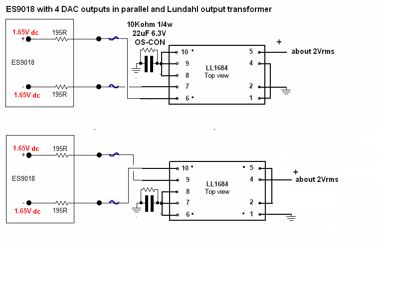

Hello Andrea,
How should the LL1684 be connected ?
I'm asking this because in your picture it is different than in your schematic.
In your actual setup you have the +dac connected to pin9 of the LL1684 and -dac to pin10
Hello Andrea,
Follows the schematic, in the photo has been the opposite pins but same result.
In the lower schematic should the LL1684 secondaries also be changed ? Like in the image that I have changed.
Or doesn't it matter ?
yes, the secondary must be change otherwise the phase is not correct

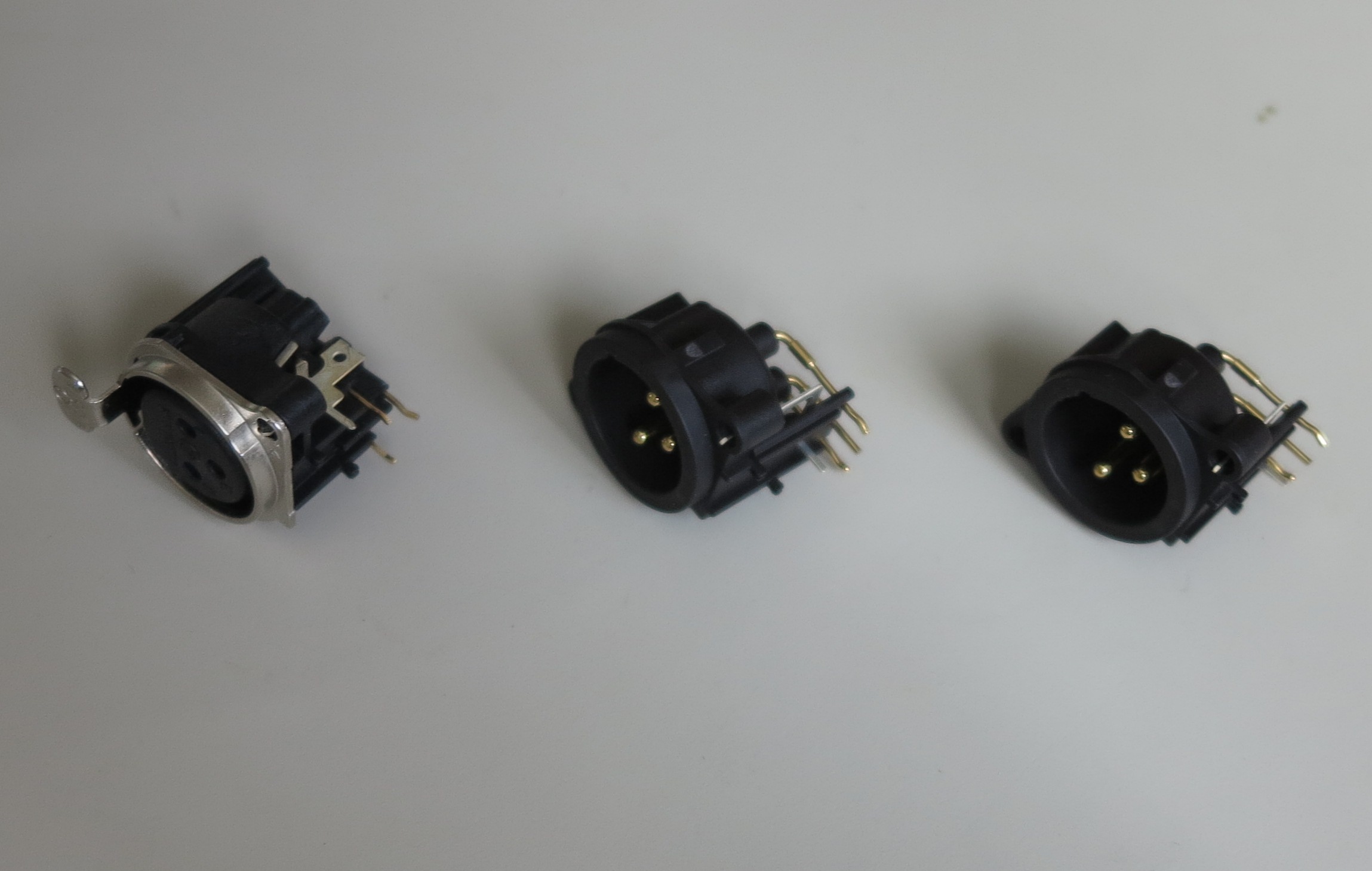

Hello,
I just got the XLR sockets for PCB from Audiophonics:
- Ordered in France and received in less than three days.
Usual Neutrik apparent quality, I hope it is the reference that goes ...
1 x NC3FBH2
2 x NC3MAH

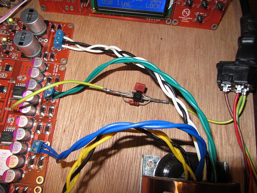

When I first connected the DAC I could here some 50hz buzz and noise coming from my speakers, I could easily detect it at 1m distance.
I installed a loop breaker circuit:
diodes, 10ohm resitor and 100nf cap in parallel that connects earth to PCB ground, and now it's dead quiet, can't hear anythin with my ear close to the speakers 😀
I needed to install such a earth <-> PCB ground connection because I use a LL1684 and therefor my DAC is galvanic isolated from my amp,
otherwise it could use the ground-earth connection in my amp.

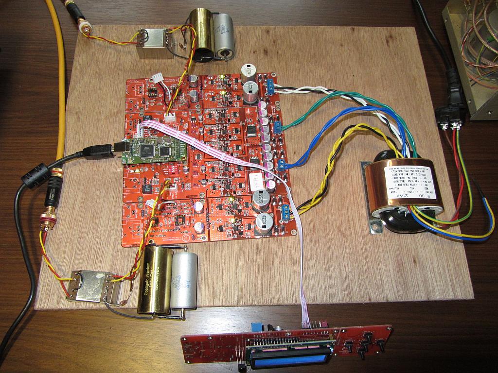

This DAC is just more than a DAC it's more a digital preamp, before I used a TVC passive preamp for volume control but now I have the TVC removed and the DAC connected directly to the amp, another veil removed 🙂
I haven't tried the opamp output stages yet but the LL1684 sounds so good that I wonder if I ever will get to it 😉
Especially with high resolution recordings it's remarkable, it's the first DAC that I hear pianos playing like real pianos.
I use Foobar configured as here.
The Smashing Pumpkins have a reissue of "Mellon Collie And The Infinite Sadness" that's available in 24bit/96kHz and some songs are very good.
Mods done:
- added PCB ground-earth connection through loop breaker
- removed PS regulator from amanero and use the DAC's regulator
- used 15uf MKPs for the LL1684 connection to ground.

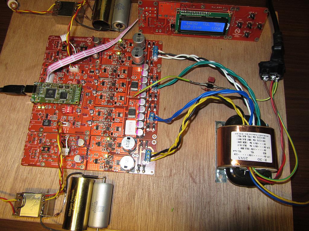

@Randy:
When you try the LL1684 connect the PCB ground to earth with a loop breaker circuit.
When I first connected the LL1684, one channel was out of phase because I based my connection on the color of the already installed wires, better to look at the labeling on the PCB, those are correct.
I used some MKPs that I had laying around, thought it would be better than oscons.
