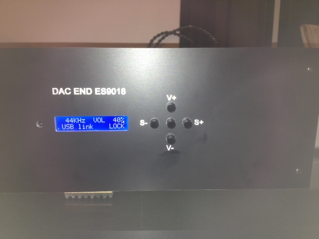

Played a DSD file tonight, worked with no problem. Using Jriver for Mac. 🙂
So far, I have played CD (44 kHz), 96 kHz and DSD. If was fun to see the display say DSD.

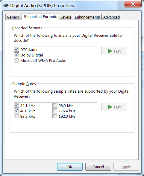

Mine also OK 44.1kHz, 96kHz, 192kHz and DSD with JRiver on Win7 via USB but no luck via coaxial anything above 48kHz.

3. Have you checked if your spdif interface can send on output 96 or 192KHz ? DTS and Dolby format cannot be reproduced by a ES9018 becasue it is necessary a surround pre-processor.

[/INDENT]2. Coaxial --- tested with Win7 PC (RCA to BNC DIY cable) >>> only 44.1, 48kHz OK😕
In the screenshot you attached you have to check the supported sample rates by your DAC. Windows or S/PDIF for that matter will not autodetect them.

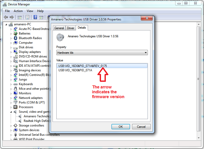

Hi
Regarding Amanero USB.
First you may check the Firmware version. the attachment shows the latest version.
See for update the firmware
Amanero Technologies

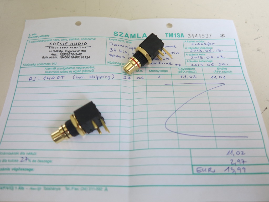

Hello,
I just got the RCA sockets for PCB from Kacsa Audio Kft, Budapest:
- Ordered in Hungary and received in less than a week for € 14.00 incl. shipping.
Beautiful apparent quality, I hope it is the reference that goes ...

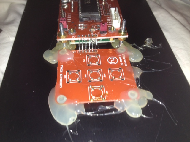

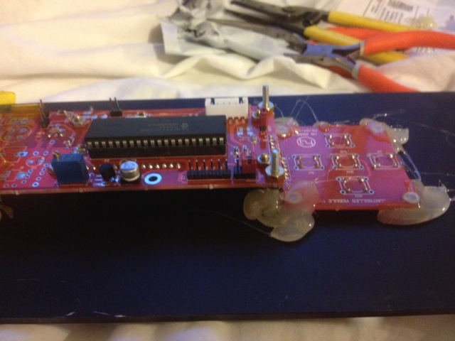

My switches and switch caps finally arrived from Mouser.
I ordered this pn for the caps: 80180-2000
It is a perfect fit for the original switches, slides right on.
But, the switch I ordered for a replacement fit OK, but the actuator part was a little larger, switch was pn 1301.9319.24.
Also the leads were a little off, but I made little solder bridges, and it soldered down OK.
Fortunately, a size 1/8” drill made the hole in the cap a little larger, and then the cap fit this switch.
I just hot glued the switch board down, as shown in the pics below. With the hole size I used, the board kind of clicks into a spot where it is centered and positioned just right.
I know it looks ugly inside, but from the front it looks fine.
I am happy with this project. I like the way my chassis looks, although I still want to paint the top cover. The front came out nicely (IMHO), and everything fits fine. And I am pleased with the sound, currently using a zapfilter2 for the output stage.
My one complaint is that switches feel a little flimsy. I may be sensitive to this because I broke one already. In hindsight, I could have got five better qualitiy panel mount switches, and just wired them to the display board.
I could also have mounted the switch board a little higher, so the buttons would not stick out so much. But the switches work fine, so these are minor nits.
I did order some output transformers to try, and will see if I think they sound better.
For input power, I used three separate transformers, one for the zapfilter (it came with this), and two for the dac end. Each of these is 6.3V, 2A. Inside my dac, there is a AC filter network in front of each tx, to feed them clean power.
Randy
