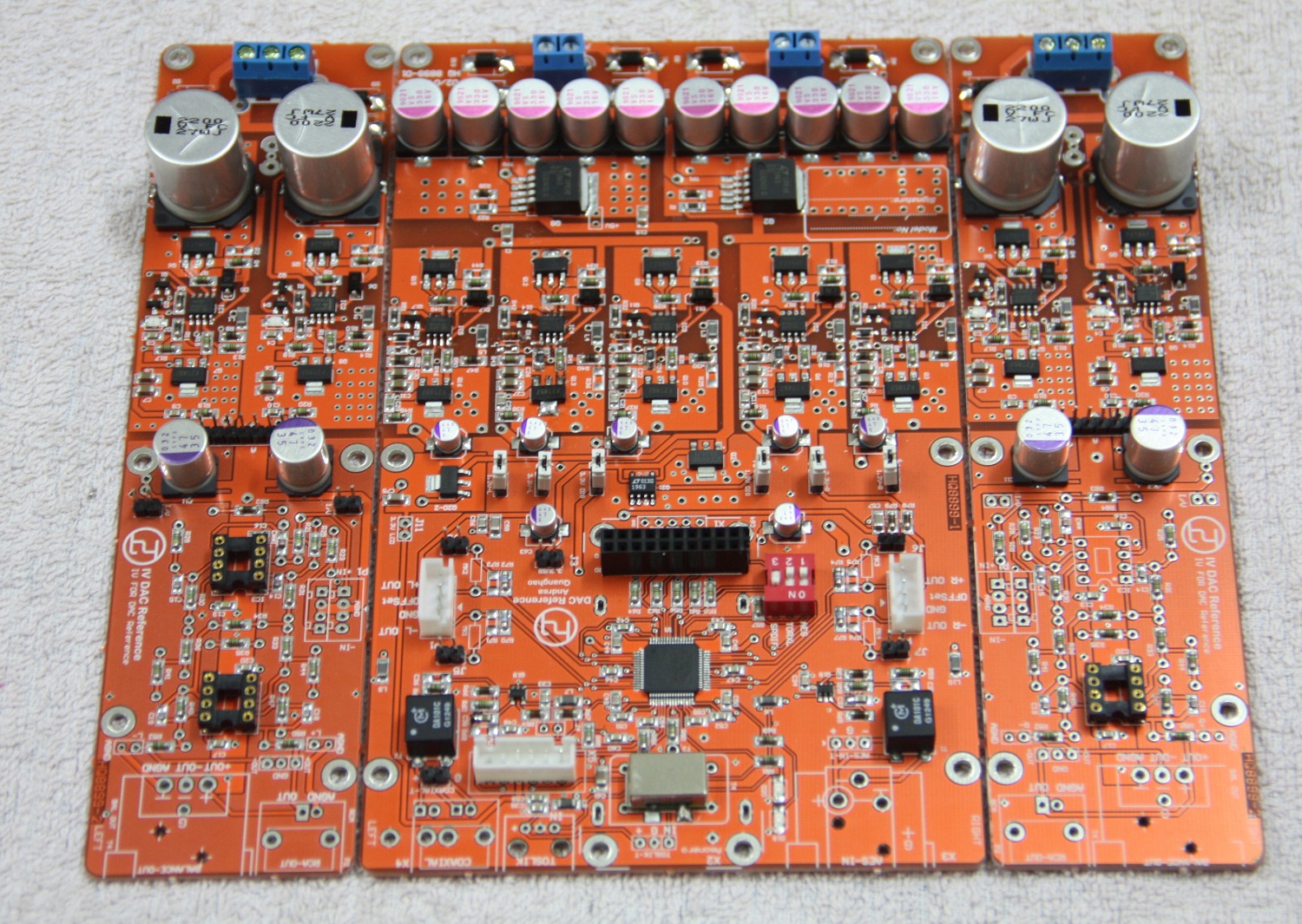

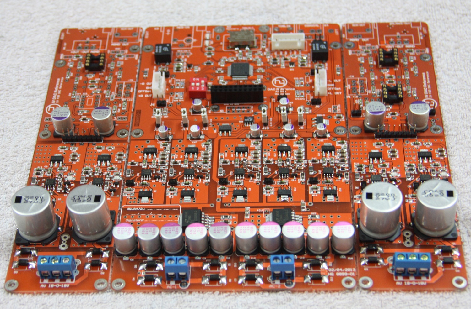

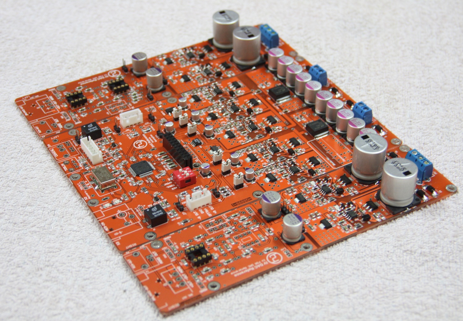

What about opamps. Do I need Single or dual ? How many do I need ?
The op-amp output stage of this DAC use 2 x dual op-amp for each channel.
I have used a dual OPA627 module as first and OPA2134 like second.
Otherwise you can use 4 x OPA2134 or any other dual op-amp.
Thank you ! 🙂 Then I will use 4 x AD 8620
Oh I forgot it can only be used up to 12 V .
Bought 4 x OPA 1612
