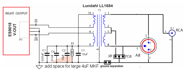

Hi Quanghao,
Two questions:
1) What is the function of the pink wire that connects R44 to R3 ( post 2073 )? In my DAC the two resistors are not mounted.
2) With the DAC/1684 you have tried to keep floating the two secondary of the trasformer and connect to chassis pin 1 of the XLR ( balanced output )?
The DAC with opamp sound wonderful.
That is R set current for shun, no need more it!

Load for LL1684
In the data sheet , recommanded load is : 10 k // 1k + 3 nF, for best square signal response.
In my system, i don't have this load and the 20 hz level is the same than 1 KHz .
Compared to my FDS366T, the sound is more dynamic , scene is wider and more background details are present.
Now, I must adjust levels and make resonnance corrections between three ways of my active system to make definive conclusions.
Br
Jacky

I use Andrea's schematic , unbalanced outputs.
In this case , best result is when output pin 4 of LL1674 is connected to DAC ground.
The efficiency of my system is 105 db/1w/1m For 3W at the output amplifier , the output DAC volume level is -21 dB , so i don't use preamplifier between DAC and power amplifier.
Pin 4 to ground? that's weird for unbalanced.
My LL1684s are configured like this.
To solve a grounding issue I had to connect DAC/PCB ground to pin 2 (RCA ground).

Using LL1684 remember to remove the I/V jump
Yes , like that !
Your secondaries are connected differently, I don't know the effect of that.
Mine are connected like the serial-serial connection in the LL1684 datasheet.
Off course I am not that confused 🙂
