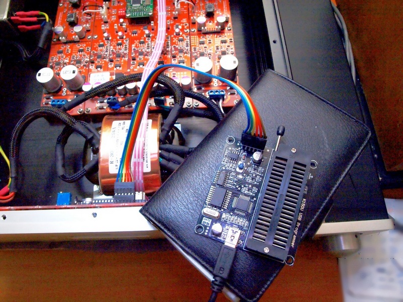

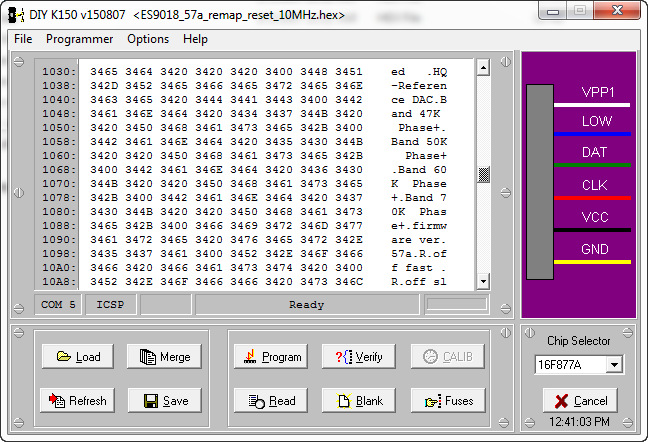

This is a known thing solved on firmware 57a
I use this PIC programmer to upgrade the firmware, cheaper than Pick-It.
Search in eBay or Aliexpress for "K150 PICPRO", it costs about $12.67.
It is made by BAITE and uses FTDI USB-Serial chip.
A side note, on my system, after the programming status bar reach 100%, somehow it pauses for about 8 minutes before the "Successful" prompt appeared, it works though, so be patience if this occurred.
I have uploaded the driver, programming software and a simple tutorial here:
BAITE K150 PICPRO Programmer Drv & SW.zip

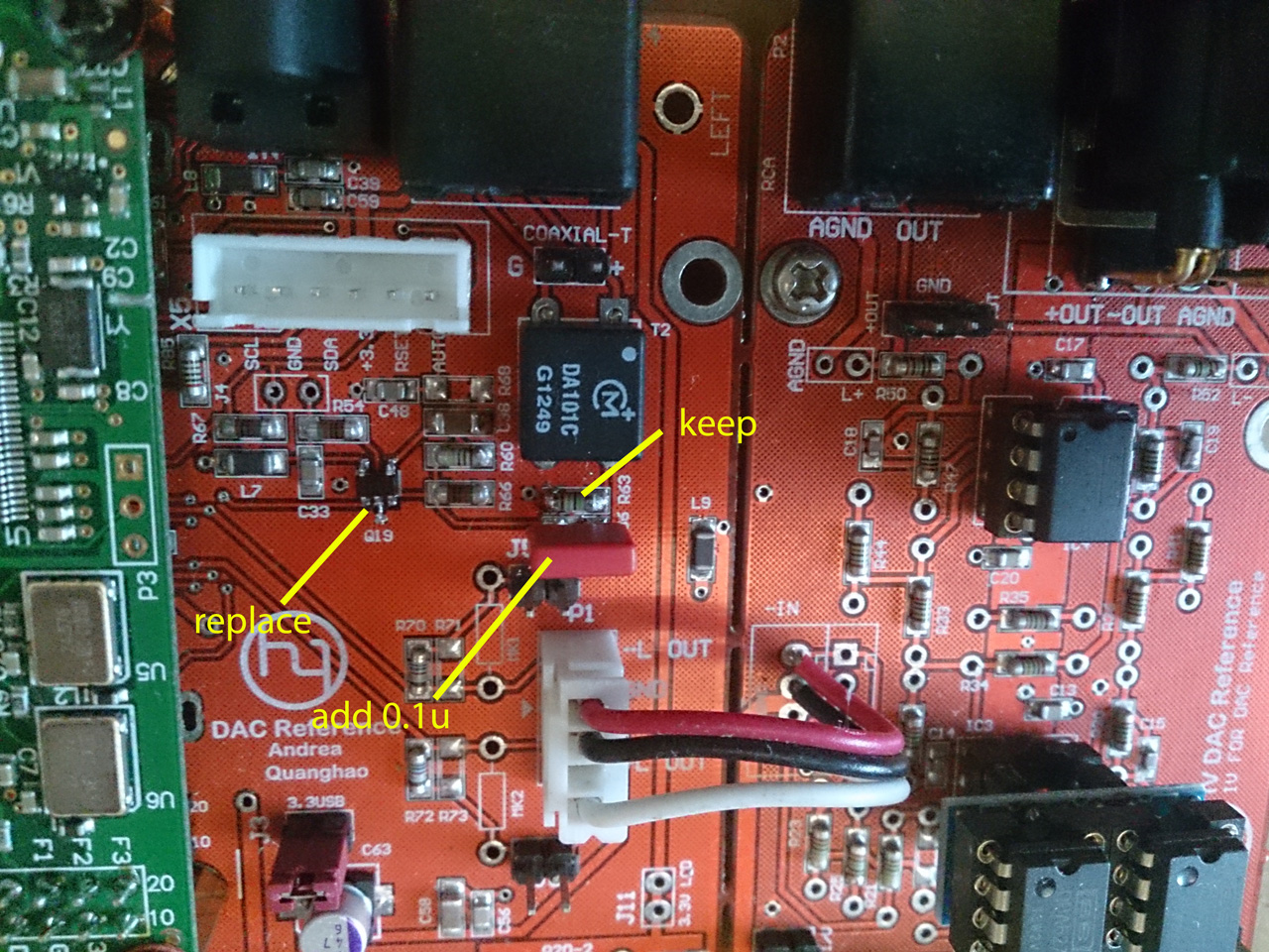

Did anybody ever finally solve the issue of the inability of this unit to sync to high sampling rates via sp/dif and toslink? The last time I checked about this there seemed to be no consensus. Some people said that adding a capacitor fixes it. Others said that changing of one of the surface-mount chips was required. And one of the designers denied that any such problem existed as all.
Unfortunately my unit has consistently failed to sync on sp/dif above 48kHz, and above 96kHz over toslink since the day it arrived. But I've not had the time to mess with it until now. So I was hoping that a clear consensus might have been arrived at by now as to what the best approach is to take.
1. Removing the 75R from the board did no good at all
2. Adding 0.1u capacitor after input transformer did no good at all
Replace the tiny defective onboard LMV7219 with an authentic LMV7219 (keep the 75R resistor and add a 0.1u capacitor after the input transformer) will solve the problem. You may also replace the LMV7219 on the AES input as well.
Andrea has kept denying the problem because he has the prototype DAC with him for testing and apparently the LMV7219 are not defective!
