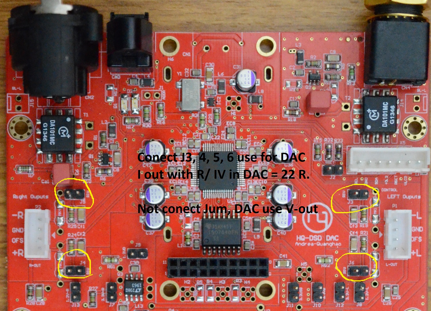

Description of all the jumpers on the ES9018 Board
Hi Quangho,
Can you give a description of all the jumpers on the ES9018 Board.
On my machines Jumper J3, J6, J11 are open. All others are closed.
I want to make sure they are setup correctly. My machine use Lundahl output transformer.
Thanks.
Alan
Hi Quangho,
Thanks.
Alan

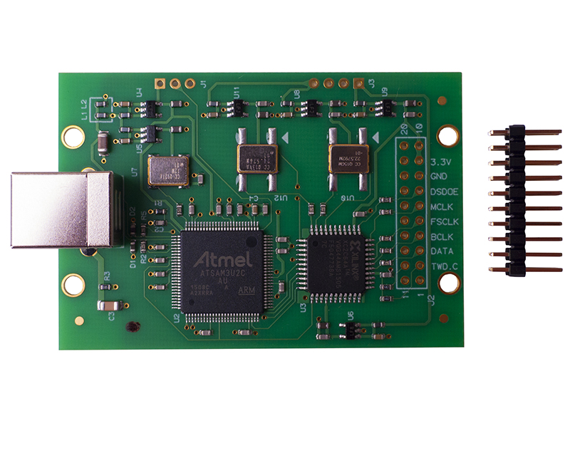

More advanced Amanero Card
I just came across a more advanced Amanero Card. It uses 6 ultra low noise regulators. I just ordered one.
All the holes dimension is the same as the original one but the board itself is bigger than the original one.
I checked that I will need to remove the Optic fibre socket to install it. But since I don't use the optical input, this is no big deal for me. I will let you know the outcome when it arrives.
Alan

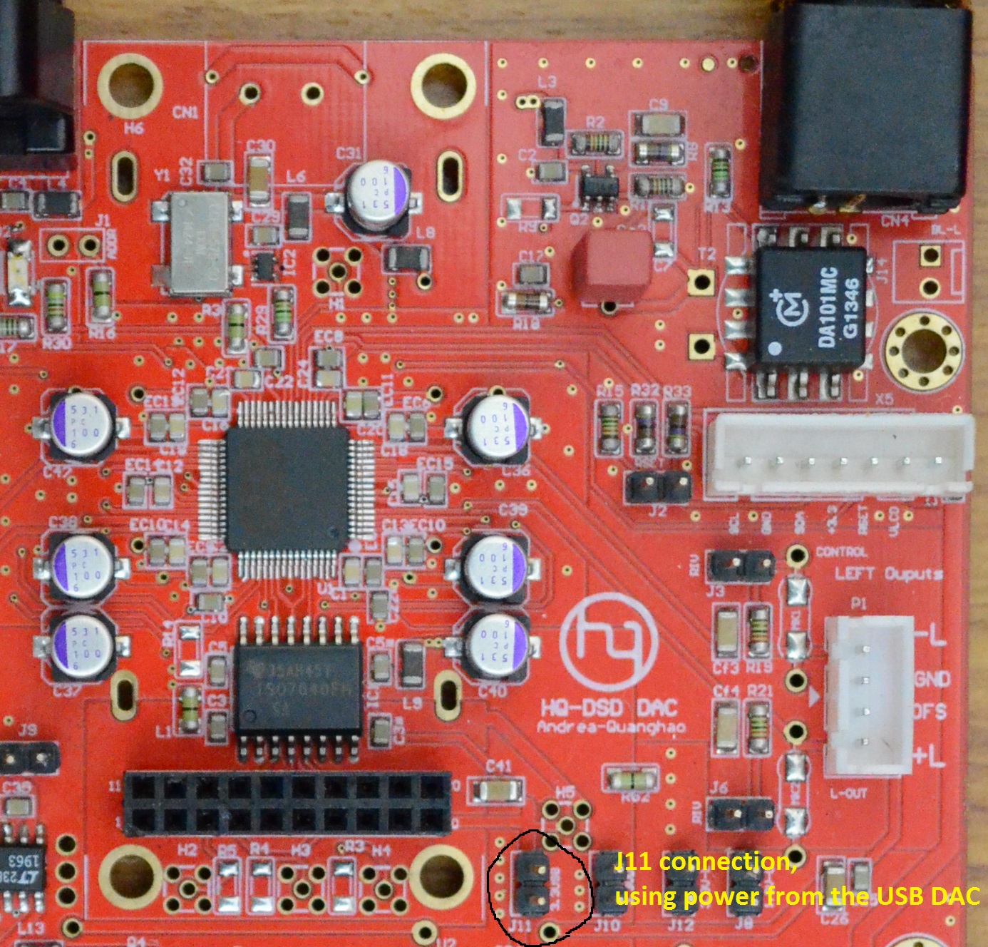

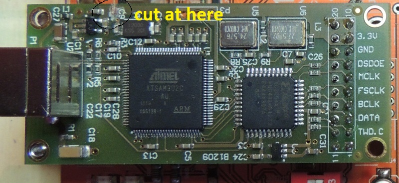

hi!
now you see :
1. in the USB board, you cut supply from computer. Please see image
2. Connect Jum of J11, you get 3.3 V from DAC . Please see image.
please do it. thanks
hi!
now you see :
Thanks Quanghao,
What is Jumpber 2, 3, 6 used for ?
Thanks.
Thanks Quanghao,
Thanks.
the jum for DAC use V-out and I-out
see image
thanks

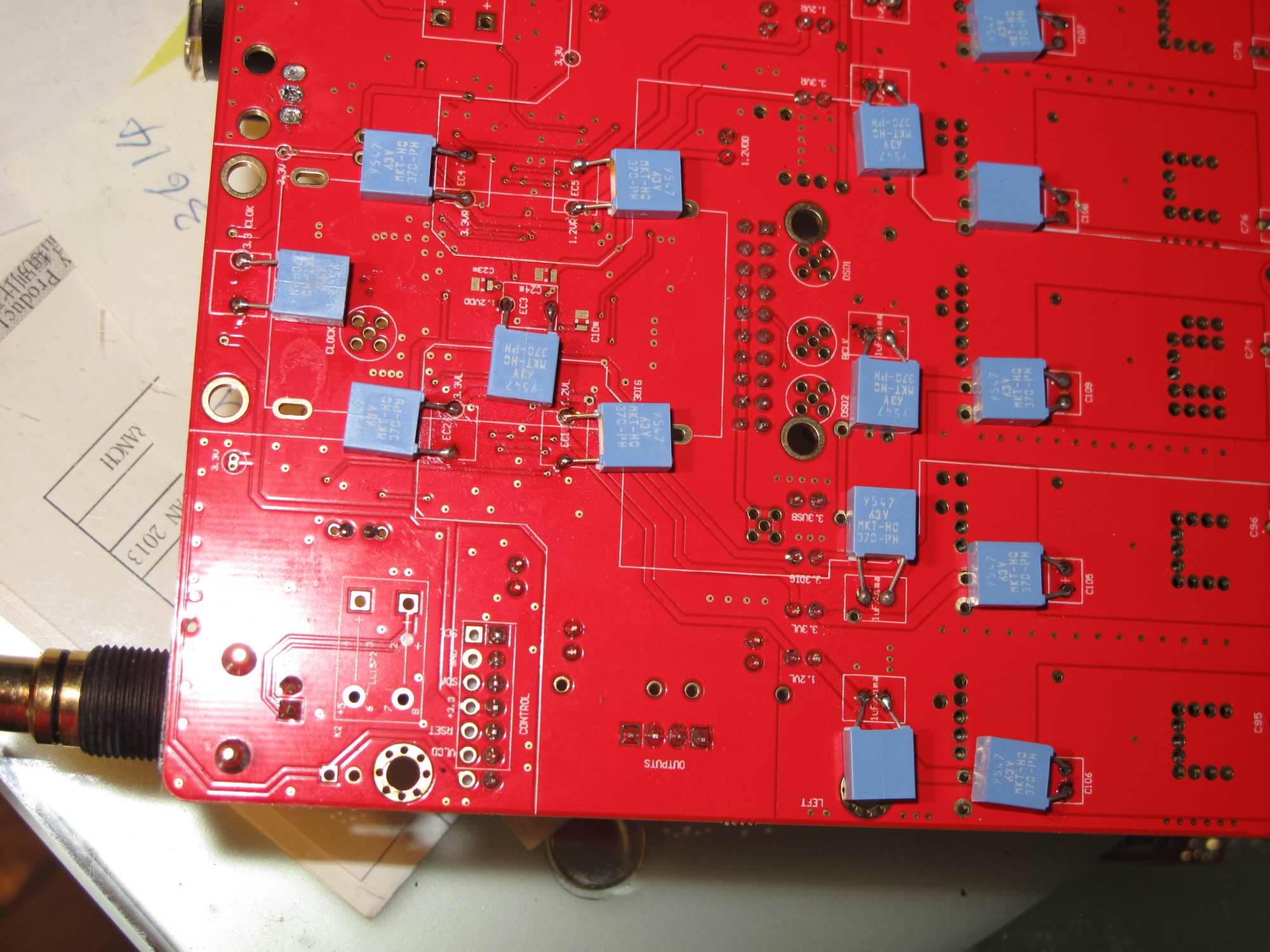

tweaking the DAC board
I have been looking at how the tweak the DAC for better performance.
Recently I took the DAC apart and look into the DAC board. At the bottom side of the DAC board, I found that there are labels for inserting BYPass caps for the power supply but there are no bypass caps there.
So I insert about 16 or so bypass caps into the DAC board. I believe bypassing the power supply to the DAC chip is important. Also I bypass the electrolytic cap of the power supply for the 100M Crystal Clock.
Just to share.
Just to share.
see image
thanks

Upgraded Amanero
Today, my upgraded Amanero arrived. I installed it and it certainly provides a sizeable improvement over the original Amanero.
First I found the upgraded Amanero to be more stable. I experience randomised sound drop out from the original Amanero. The upgraded Amanero sounds very stable and no signs of drop out at all.
The sound stage was much more 3D on the upgraded Amanero. I have great expectation of hirez recording but somehow I never like the sound of these hirez recordings based on the hirez samples I have got. After initial listening to this upgraded Amanero card, it can be a game changer. I will give further comment after more listening sessions.
As you can see from the photo, there are 6 ultra low noise regulators on this upgraded Amanero. Each crystal clock has its own regulators. The card is slightly wider than the original Amanero card. The installation holes and the connectors are on the same location as the original one.
If you want to install this card on Quanghao's DAC, you will need to sacrifice and remove the Optical socket.
At this point, I strongly advise upgrading your Amanero card.
