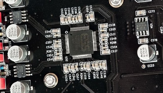

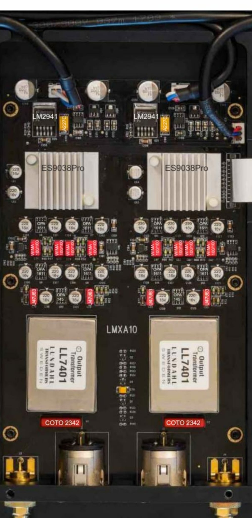

I found that Lumin audio is designed a very good DAC in all their latest devices, but as they are new devices, we can't find a schematic.
I try to contact with Lumin to help me in this regard but no answer.
Attached data is what i get from Internet, from different sites.
If anyone can help me in this design.
Thanks in advance

I don't see the idea of building a dac with dual ES9038pro as stupid. I listened to commercial dacs with that same chip and I always really liked the sound.
The idea seems like a good project to me, in fact I also thought about building something like this, only with I2S input and RCA analog output (unbalanced, with a simple operational I/V converter.

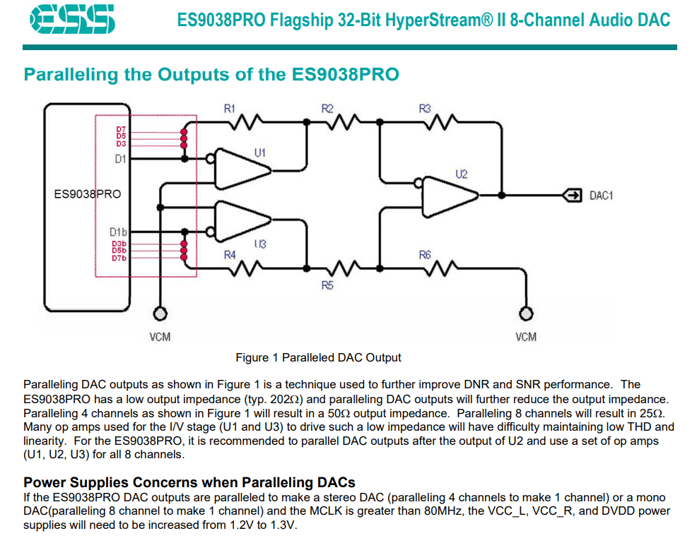

4 parallel channels are not enough? Need 8 ? :)
P.S. I made DACs with one 9039Pro as 8 channels, one 9038Pro as stereo 2x4, also with 2x9038Pro as stereo 2x8.
Also AK4499EQ as 2x2.
Yes, the SNR increases a little, but who really needs SNR more than what a single 9038pro channel can produce? And even more with 4 parallel ones (for stereo 2x4). Do you need another +3dB more, with 2x8?
TND usually does not change when connecting channels in parallel, but by multiplying the output current of the DAC, you get a headache when choosing I/V OP and an almost useless increase in signal to noise and a large increase in consumption and heat dissipation (which are already quite large).
