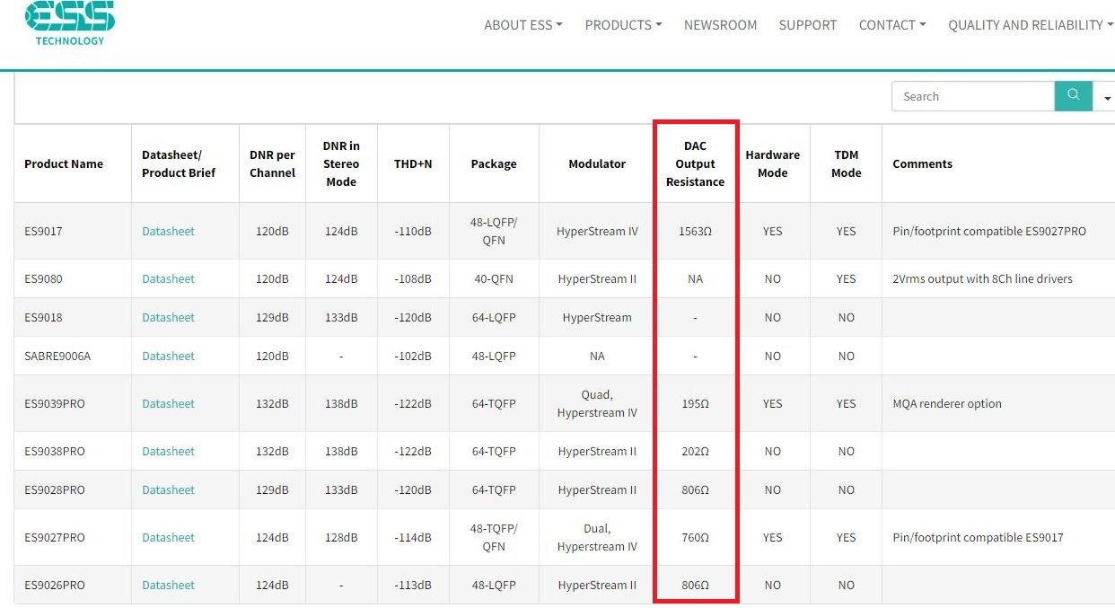

. What is the purpose of the output resistance ? How does it confuse or help us?
Can you give me a simple calculation example so I can understand how it matters ? Is this resistance in series with the output ? If the output will be forced to be fixed by the op-amp in the i/v converter, will this resistance force the internal output of the constant current source to vary in voltage according to the musical program ?

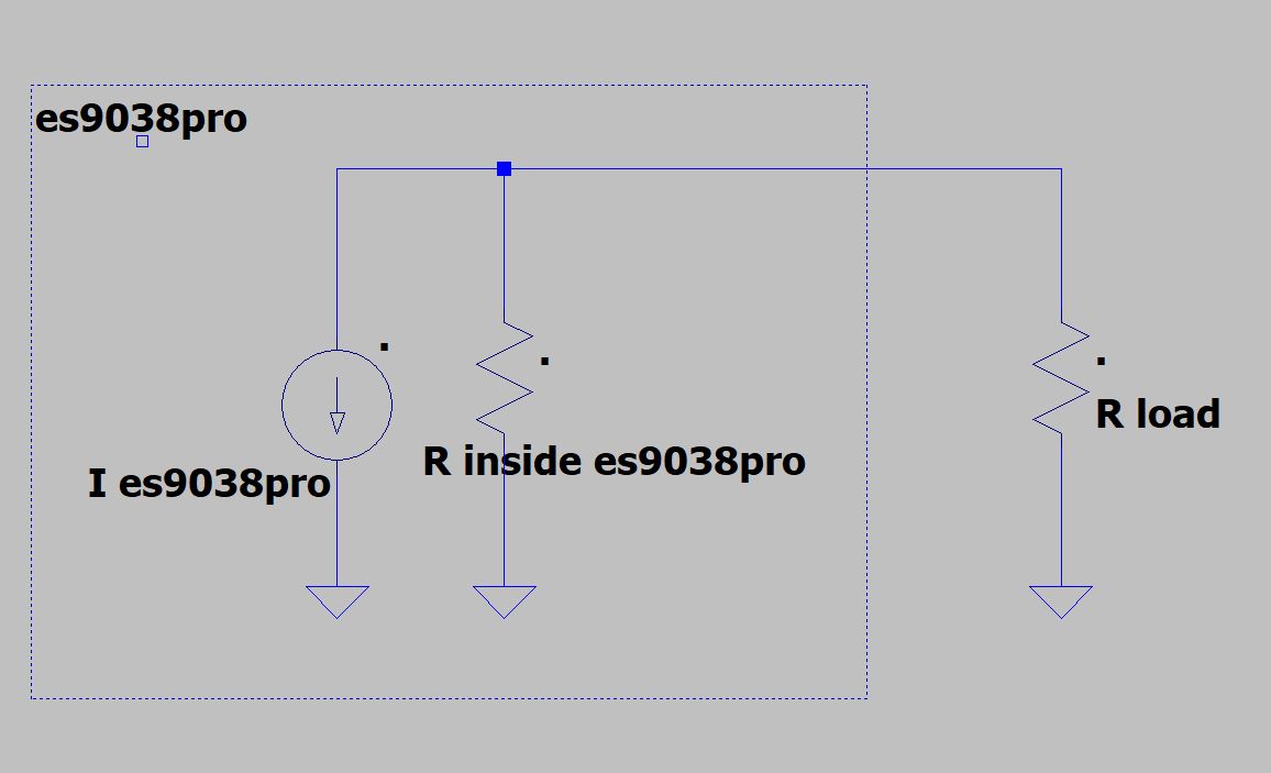

Every signal source can be thought of as an ideal voltage source in series with an impedance (as here), or equivalently as an idea current source in parallel with an impedance (the less commonly used Norton source representation).
For distortion you need to know how linear the source impedance is (if its not linear you'd better not draw much current from it). For a high end voltage DAC it will be pretty linear, but you probably still want to buffer the output to avoid loading that impedance.
For a current DAC the Norton representation is the appropriate one, and its usual there to load with a virtual short circuit as the shunt impedances are definitely not linear in a current output DAC.

So, the equivalent schematic of the current output es9038Pro is like in my drawing ?

The output impedance is the equivalent resistance present in series with the output. You need to take this value into account when you design the reconstruction filter at the output of the DAC.
I'm guessing that the DACs that have the output impedance specified are voltage-output types. So for the design process you'd assume that the DAC is an ideal voltage source with the output impedance added in series. The ones that don't have the output impedance specified are likely current-output types. That's just an educated guess. You could look up their respective data sheets.
ESS DACs appear to be of the rather uncommon switched-resistor type. Those silicon resistors have voltage cooefficient which is why ESS recommends running the output pins into a fixed voltage virtual GND node just like true current-output types.
