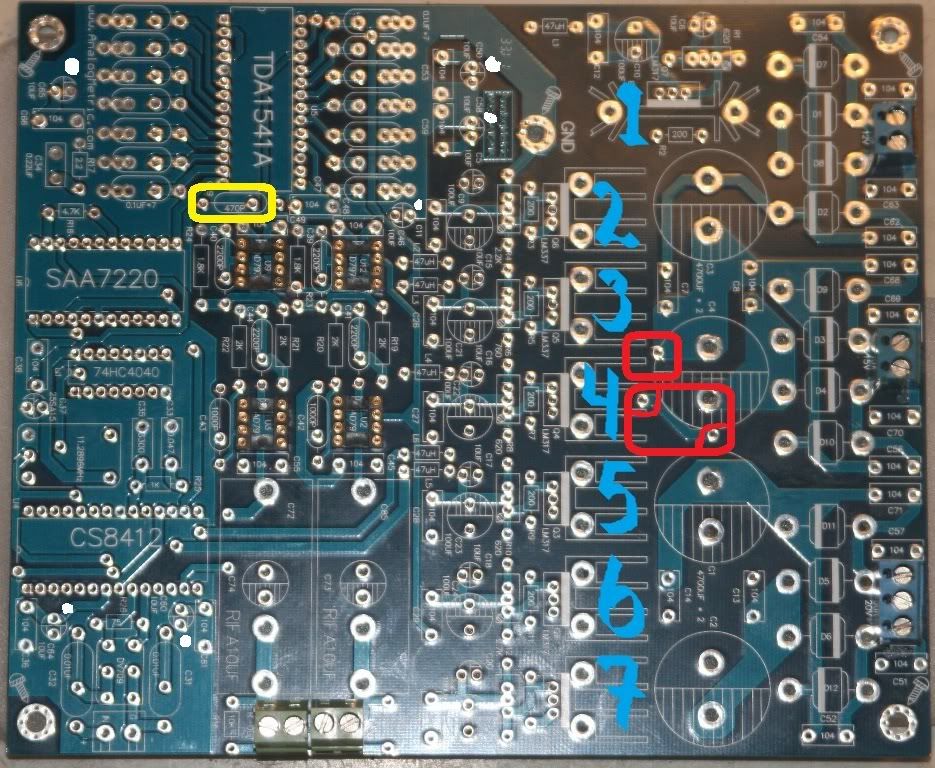

Some questions about the PCB
The regs, numbered in the pic, which one feeds what?
The items marked red, are they jumpers or what are they?
Yellow isn't really a questione but rather the DEM cap, which I'll probably use 122pF 1% silver mica.
elcos marked with a white dot, are these suitable spots for Os-cons?
Hi Mayday, You can get a PDF of the schematic and build sheet from Analogmetric. Just email them. Note: There are some errors in there on the schematic. Some polarities are shown wrong on the negative power supply decoupling. The circuit boards are correct so no worries. If you can't get it (the schematic), just PM me with your email and I will send it to you. Stay warm lots of fluids and you should feel better soon. Dave
Mayday, The yellow box is the pin 16/17 capacitor for the DEM oscillator in the TDA1541A. I'll look at my PDF on the supplies. I recall that wasn't real clear. Dave

Hi Mayday, 1 is the SAA7220 regulator, measure at L1 to set to 5 VDC. 2 is -15 VDC regulator for the TDA1541, measure from L2 to adjust. 3 is -5 VDC regulator, measure L3 and adjust. 4 is +5 VDC for the TDA1541, measure from L4 and adjust. 5 is the (2) +5 VDC supplies at the CS8412/8414, measure at either L5 or L6 to adjust. One regulator feeds both L5 and L6. 6 is the analog stage +18 VDC, measure from C29 to set that one. 7 is the analog -18 VDC, measure at C30 to adjust that one. The red boxes your looking at the circuit board vias. That carries power from one side of the board to the other. Hope that helps. Dave

All regs except 6 & 7 are more or less "static" like you described a few posts above? So for them I can go 22-33uF, and for 6&7 maybe a bit higher?
At what positions on the PCB would you use solid polymer caps?
The bom says 10uF for the ones I think are suitable for SEPC caps, but in my CD-60 I've started swapping 33uF elcos for 270uF SEPC around digital IC's.
Hi Mayday, Yes... I think that 22 or 33 uF bypasses should be good. The digital chips like the 7220 run lots of current as it is a CMOS part. So that regulator will run "Hot" compared to the others. I haven't tried the capacitors you mentioned however they are excellent quality. You might consider for the analog supplies to the Opamps applying smaller caps right near the chips themselves as opposed to using a larger values near the regulators. If you look closely you can see the caps near the regulators are a long distance away. That will help dynamic current delivery. Maybe someone else has a comment on those Polymer capacitors.... Dave

I'll probably use 22 or 33uF Sanyo OS-con's then 🙂
The os-con sepc are very low esr and are supposed to be the best to use for digital IC's.
