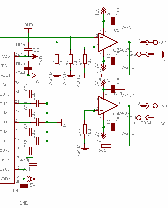

So, I increased the 5532 gain and reduced I/V resistor to 30 Ohms. Here You are, the scheme I use. Just the R10; R11 values are changed and added output capacitors.
And again, what if I try to Null the offset, and miss the capacitor? Is there something wrong in this idea, and why everybody use capacitor?

Yes you can null the offset using the adjust pins.

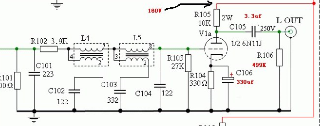

The cathode follower is from here:The Valve Wizard
The single end is from ECC83 datasheet tables, with resistors for smallest THD. My circuit looks really like a nest 🙁

That circuit is not right for a TDA1541 output stage.
You don't need 300V for an E88cc. Use 150V or 160V. Even 120V will work 🙂
Build the circuit in the attached schematic. Sorry the IV resistor got cut off. It is 100 Ohm. But you can use anything from 80 ohms and up to 100ohms . Don't worry about the output compliance. Get the circuit working then worry about fine tuning.
You wont need the inductors.

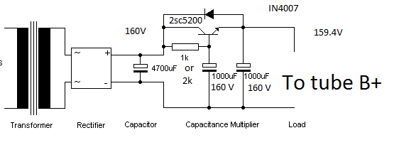

Use a capacitance multiplier on your B+ see the attached picture.
The transistor wont get hot because your circuit will only draw about 20mA.
I use a 2sc5200 because I had them in my parts box. You can use a cheaper power transistor if you prefer.
Try this tube circuit then report back. I think you will like it 🙂

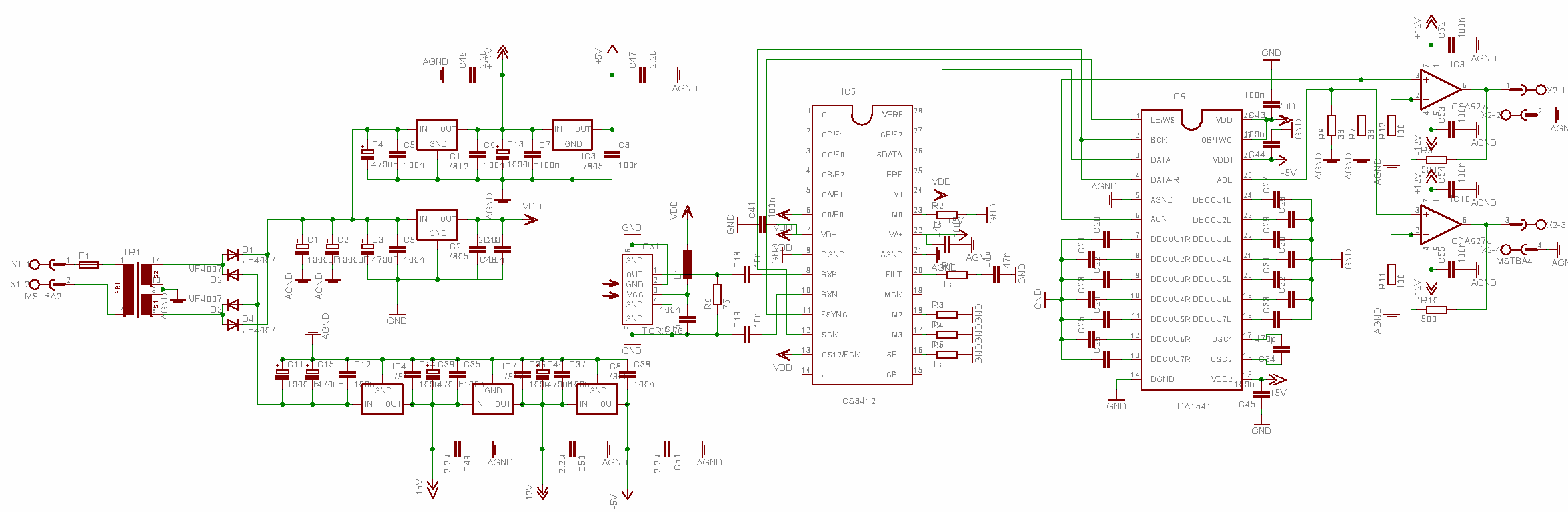

can you upload again layout for TDA1541
i need power for TDA
Power supply for TDA and CS8414
