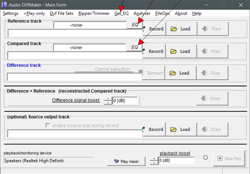

But this is my point - there's no where in Diffmaker that I can find where you can "apply eq file" - it simply isn't possible, unless I'm missing something
There is a button to create an EQ file, and buttons for each file to apply EQ from an acquired EQ file.
See image below.
See image below.
Sorry, you are correct - how did I miss that??
Good work!!

No offense taken, just an embarrassing mistake, that some of you were happy to point out! That's one of the many things I like about this group, everyone is pretty friendly and laid back, excluding myself of course.
