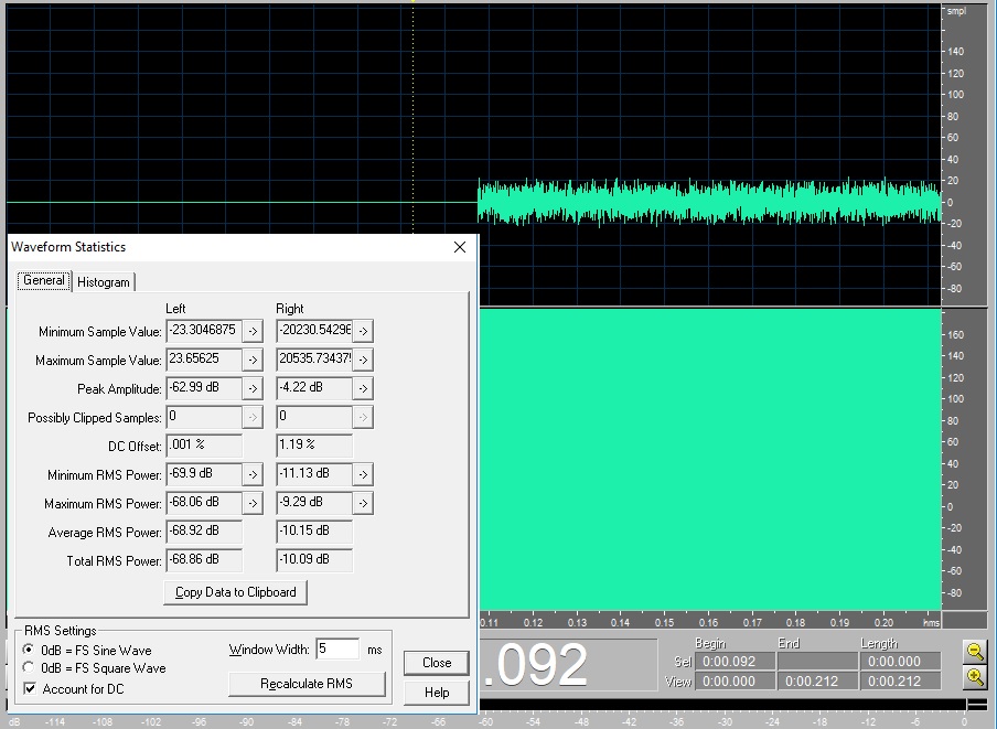

Really? Can you give us an example of such tiny dB filter ripple in the audio band giving rise to -60dB correlation difference?
What I believe you're saying here is that room responses & reflections will deviate greatly from the input signal - no disagreement here but relevance?
First one is easy I took two identical broadband noise signals (~-10dB L and R in the picture). I amplified 1/2 the top one by only .01dB and replaced the top channel (L) with the difference. The R channel is drawn off scale here but the waveform statistics show the difference is identically 0 in the first 1/2 and the .01dB difference in the 2nd 1/2 corresponds to a -59dB null. So +- .01dB simple amplitude variance can account for a ~-60dB null.
My second point is if the difference could be accounted for by benign .01dB or so frequency response differences how would you resolve that from the several dB ripples in any real listening environment?
I hope my picture is clear the waveform statistics are on the second half of the signal, the first half is just there for completeness the subtraction yields exactly 0 (perfect null). It's just math BTW, rule of thumb 10% ~=1dB so -60dB = .1% = .01dB.
I am unclear what it is that puzzles you. Unless devices are perfect there will be differences. These differences may be measurable without being audible. Minor wiggles in frequency response are a likely explanation. -60dB difference could mean a 0.009dB response peak; unlikely to be audible?mmerrill99 said:I'm not saying Diffmaker is perfect but those who live by measurements have never explained what the problem is that leads to such reported differences between input & output of <-60dB for supposedly transparent devices.
