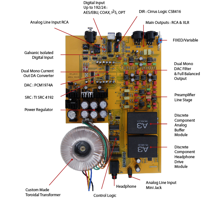

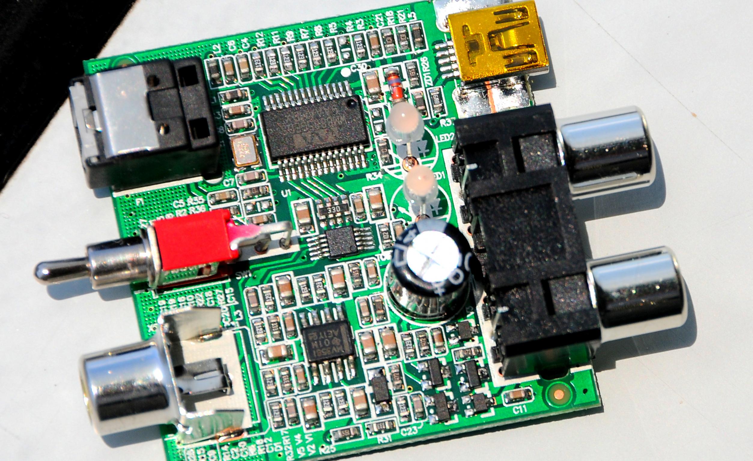

I just google image searched the models, there was an open pic of each
Pictures are too coarse and lack contrast to see the part numbers. There are no schematics to tell how they're configured either. That aside, the difference in effort / circuitry put into the design is striking. I would expect the better DAC to measure significantly better. However, that does not mean we can hear it.
What's more astonishing is that both DACs ICs, probably sell for less than $3.

Having now seen the pictures, where are the pair of output electrolytics allegedly present on the smaller unit? I can only see one electrolytic near the outputs.
The differences between the two are indeed striking.
That might be
WMB8356EDS x
WMB8056EDS x
WMB805GEDS x
WM8805GEDS - S/PDIF tranceiver https://goo.gl/xf5PSq
WM88056EDS x
No DAC here, unless it is something else.
MV3581 x
MV358I returns LMV358 dual low volt. rail-to-rail op-amp.
Most likely, the DAC is this ..unknown hero:
The other pic says DAC: PCM1974A which it doesn't exist, but it might be a typo as PCM1794A does exist, it's a good Texas DAC chip and costs 12 or 15 euros (two versions).
"132-dB, 24-bit, 192-kHz advanced Segment, Audio Stereo Digital-to-Audio Converter"
"132dB SNR Highest Performance Stereo DAC (H/W Control)" goo.gl/3TSmgW
Of course, it's not only the DAC chip itself that counts.
OK, but next time try to use a cheapo DAC that we can recognize and download the PDF with its specs and architecture. Then we might be able to assist by suggesting specific revealing sounds for you.+1

I was curious what chip was used and came across Inside FiiO D3 | H i F i D U I N O (which I believe is the dac used?) There are some other sites and a few youtube teardowns.

The FiiO DAC is a Cirrus $2.55 from Digikey. CS4344-DZZR Cirrus Logic Inc. | Integrated Circuits (ICs) | DigiKey
The other DAC is a more advanced TI part cost $13 PCM1794A-Q1 132-dB, 24-bit, 192-kHz advanced Segment, Audio Stereo Digital-to-Audio Converter | TI.com . This is an expensive DAC.
Here is a similar part but lower cost at $2.90 PCM1795 costs
PCM1795 32-bit, 192kHz Sampling, Advanced Segment, Audio Stereo DAC | TI.com
It is not shown in the pics, but the author claims it is the Cirrus CS 4344.I was curious what chip was used and came across Inside FiiO D3 | H i F i D U I N O (which I believe is the dac used?) There are some other sites and a few youtube teardowns.
It's because you compared a $30 device to a $3000 one.Who cares? I fail vs a 3000$ DAC. My life is a misery now.
If it's any consolation, the actual comparison is between a DAC that costs 2.5 euros vs one that costs 15 euros, that's a 6:1 difference, not a 100:1 one, therefore, mathematically you should now feel 16.7 times better! 😛
P.S. The cheapo's PDF doesn't say much, I'll look if there is more info on other docs at a later time.
