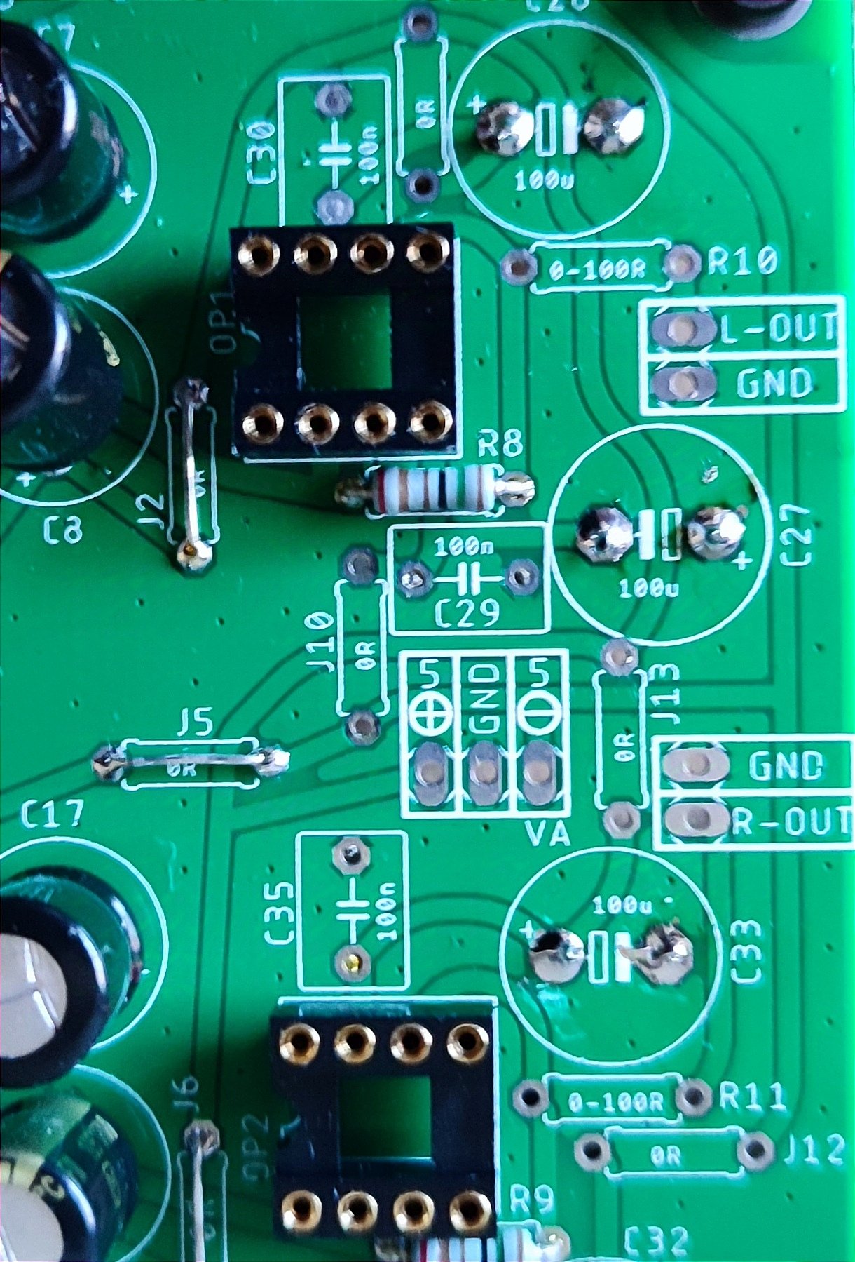

Maybe a stupid question, but how do you determine the value of the "output resistors" marked 0-100R?
No stupid questions only stupid answers 😁
If you're going to use one pair of ic cables to the rest of that dac life, then you can calculate resistor value there as you will know the cable resistance and (main culprit) capacitance. If not, 22-47R will cover most if not all ic cables you will put there, and what it does is in short is, prevent oscillations. It also saves your opamp (potentially dac chip as well) in case of a short. Best thing is, use quality resistor there and you won't have impact on the sound, so, win win.
