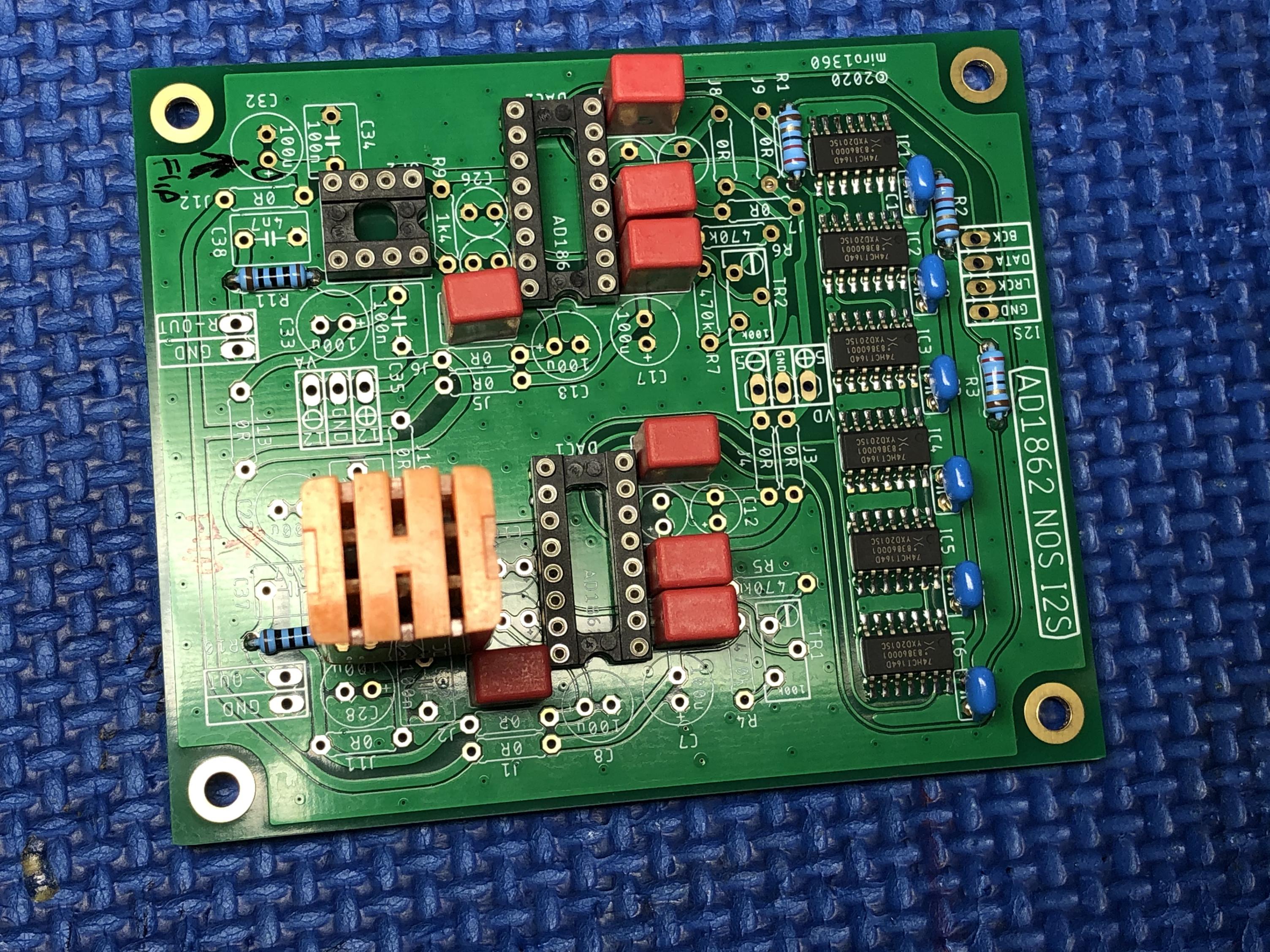

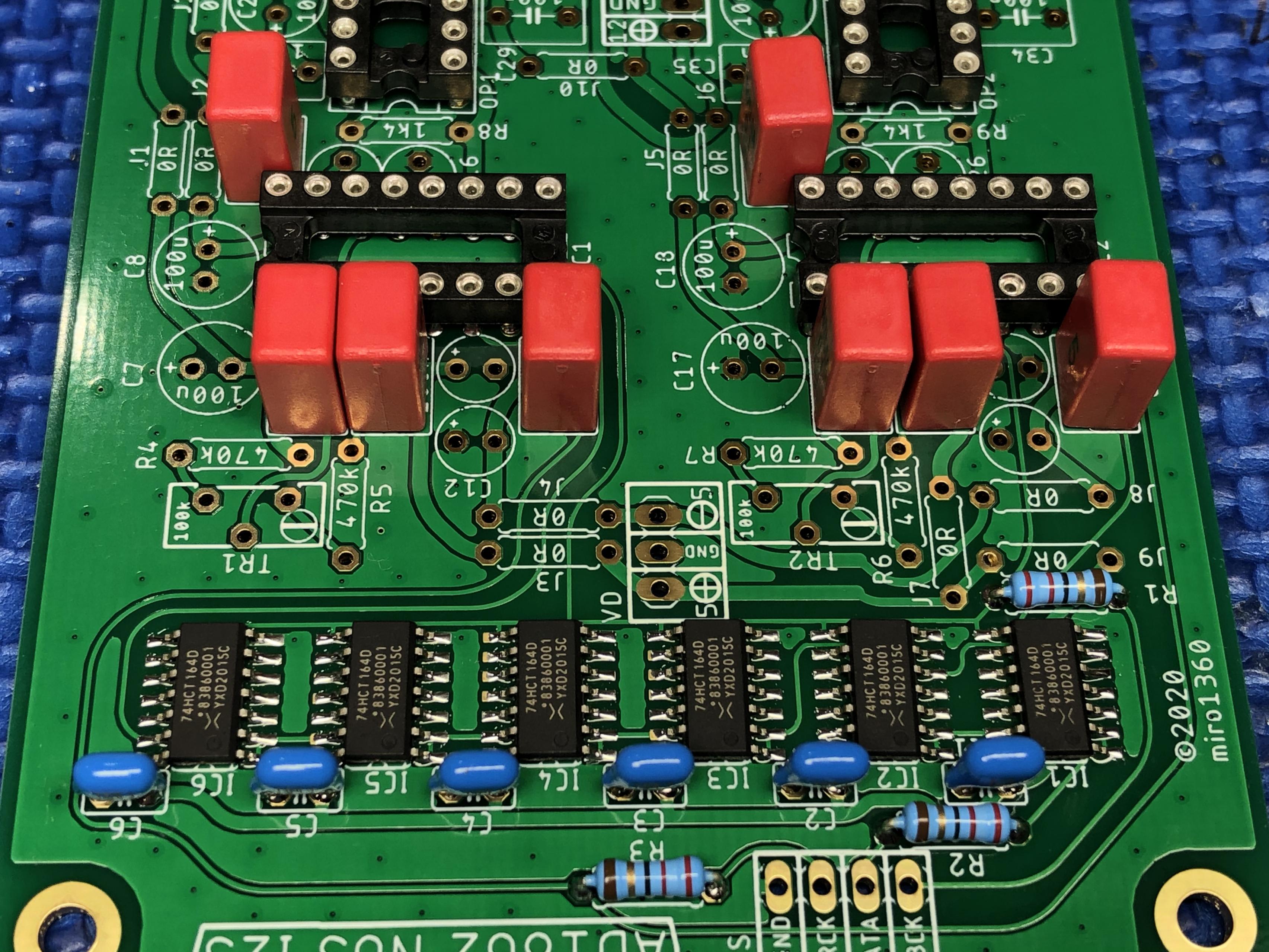

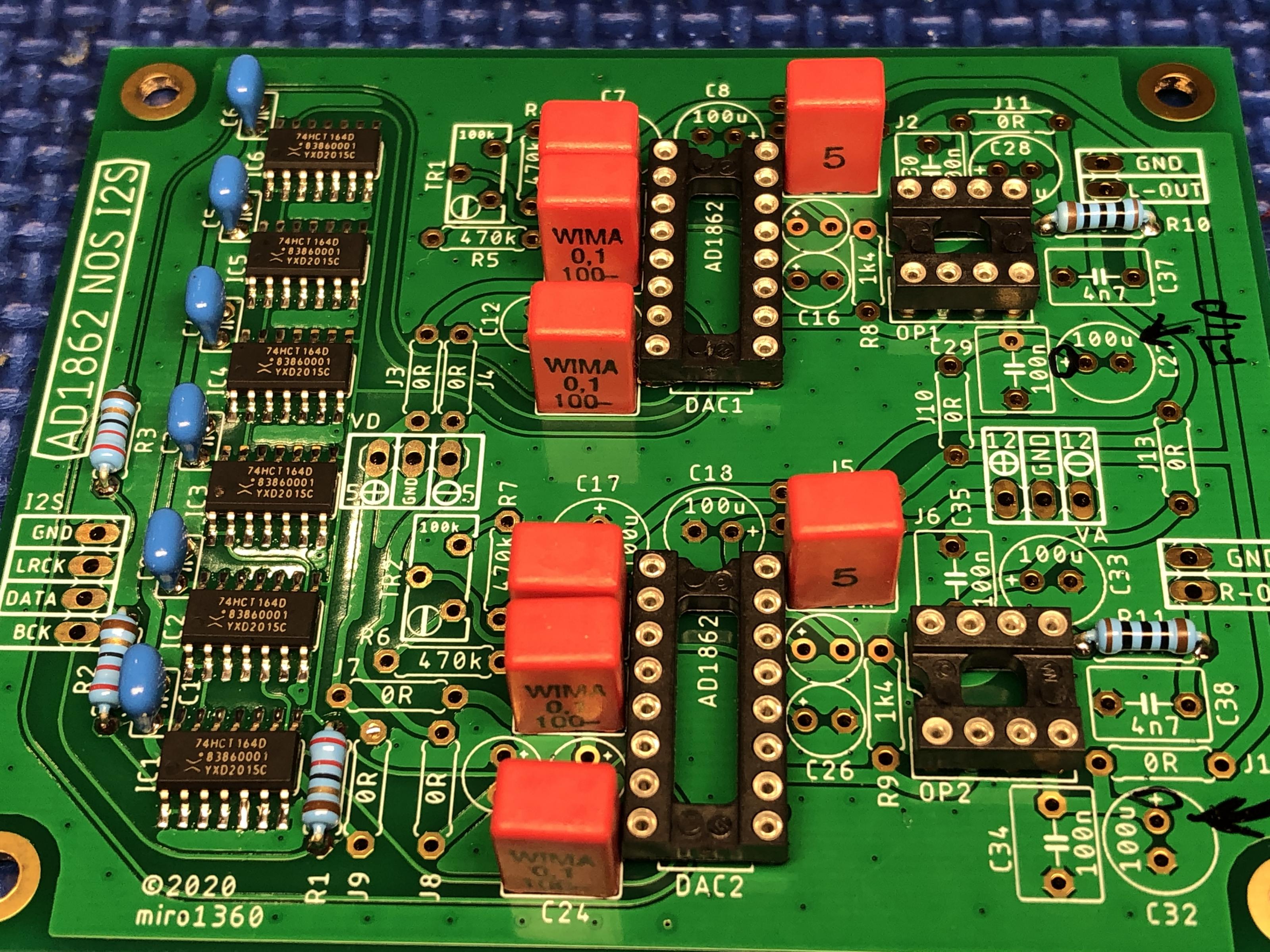

Hello Fellow builders,
I’ve made some progress tonight on the AD1862 DAC board. I don’t think I’m going to populate the MSB trim section until I’m powered up and all works as it should. From the beginning, I had plans to roll different types of opamps in the I/V section to find my sweet spot. But as you see there is very little space around the chips for anything but a “stock” opamp. Most capacitors around the DIP8 sockets will have to be mounted under the board. I understand why the components are mounted so close together and to the opamp/AD1862 pins, but it does make component selection a challenge.

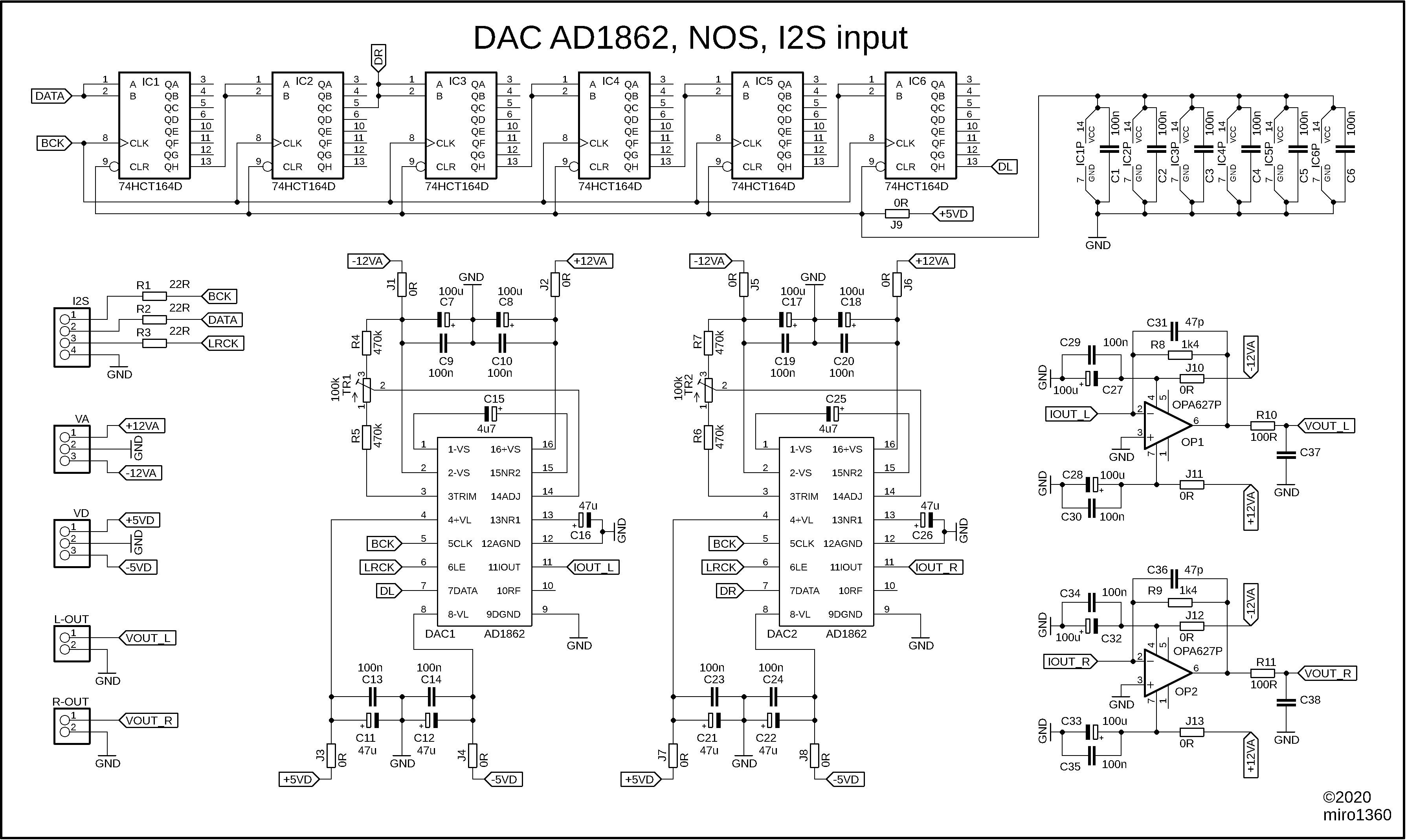

There might be a way to achieve passive IV with very little modification of the standard IV op amp configuration by adding a small (50r-300r)series resistor between DAC output and inverting input of op amp.
you generate a voltage across input resistor and the gain of op amp is reduced accordingly by ratio between input and feedback resistor.
So far it sounds very promising compared to trafo , but has to be compared back to standard IV (without input resistor) still. I think there is definitely some very mild distortion that was less discernable with the trafo, but im using 200r which could be easily be halfed or quartered with potentially no loss of sound quality.
I guess op amps do not like running at very high gain with wide bandwidth signals like in the IV configuration?

try and tell us about your result with passive I/V
my tests from the past have not gone well, I tried different values of passive resistor on PCM1704 and AD1862, the same operational amplifier (as in active I/V) was used to amplify the signal after the passive resistor, I also compared the lowest values of passive I/V without additional amplification directly on the headphones
in all "sound" tests, the active I/V had subjectively better dynamics
it would be nice if someone else tried it, because I used a classic passive resistor, metal-oxide (some people tried different foil resistors with good result, i didn't try foil)
