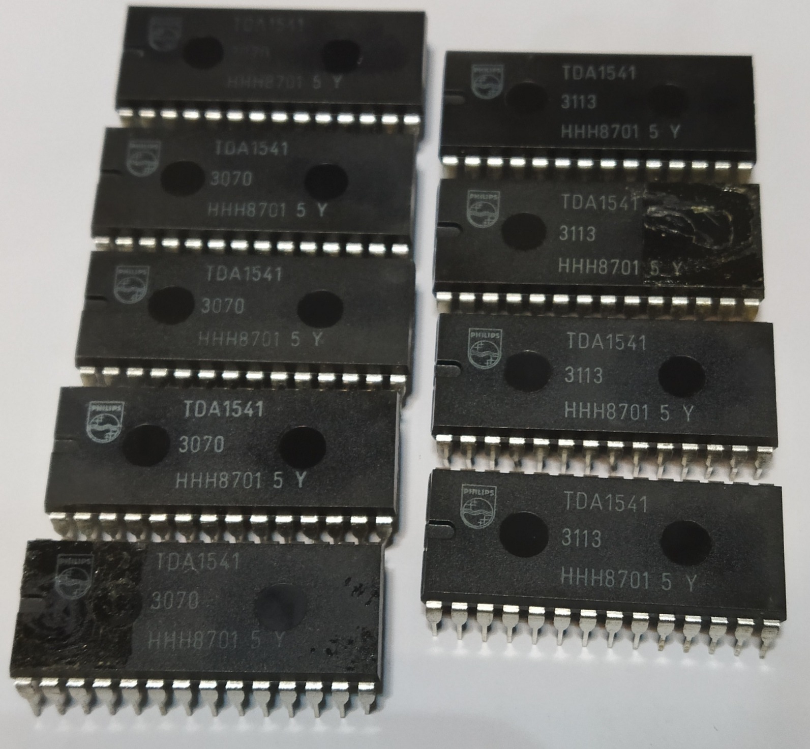

@miro1360
Hi dear miro
I have some tda1541 non A and wanted to made your dac
First question:
Does the shift register on this board accept 348khz sampling rate from i2s?
Because up sampling can improve the shape of the signal.
Second question:
Does your VHDL code support 1541 non A?
I2S to simultaneous CPLD TDA1541
Third question:
Is the following method correct for up sampling?
USB TO I2S -> SRC (SRC4192 192k up sampling) -> EPM240 (Convert i2s to simultaneous mode) -> TDA1541
@mehdism
Difference between TDA1541 and TDA1541A is only in capacitor (C15). In the non A version this capacitor is not used. There should not be another differences.
Shift register on the board is not supporting 384 kHz. I am not sure if the CPLD does support, but you can easily try it. If you notice any problems, you can play with LE bits a bit in the code.
This part of the code:
if (cntOB = 17) AND (inLRCK = '0') then -- LE pulse duration (4 BCK)
leFlag <= '1';
elsif (cntOB >= 21) then
leFlag <= '0';
end if;
Make the LE duration longer, maybe try 10 BCK:
if (cntOB = 17) AND (inLRCK = '0') then -- LE pulse duration (10 BCK)
leFlag <= '1';
elsif (cntOB >= 28) then
leFlag <= '0';
end if;
I did not test it, so you can do it 😉
Correct, for upsampling with filter you can do it like this:
Be sure that everything is configured for standard 64fs (BCK) and not 32 or 128 🙂

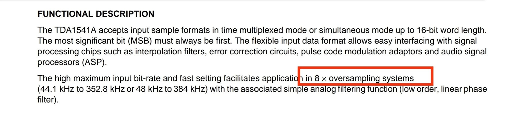

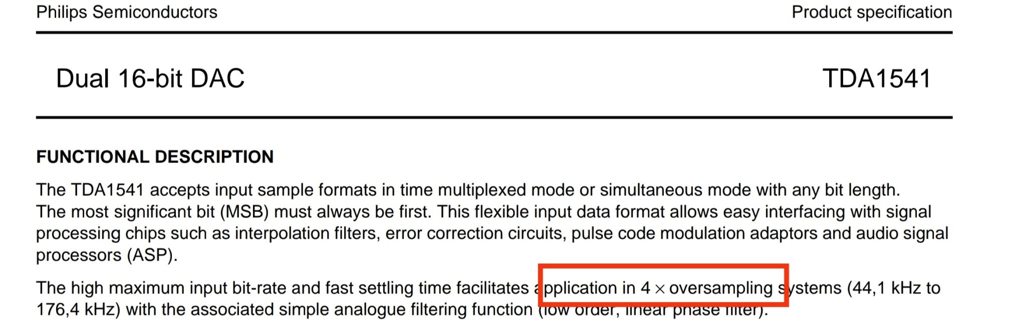

Short answer : do not focus about that numbers and high frequency clocks (it depends if 32 or 64 conf) with a 16 bit clock.
Longer answer :Have you a lot 384 K hz materials ? Which is the second family speed of rare material reccordings, no !
Written differently, many people noticed than x 8 upsampling didn't add vs x4 upsampling. At least with that chip (and most of the old pcm ones)
While it is feasible (P. Rogic demonstrated that) it has no improvment in the real world of your hearing vis à vis of all the (complex) needed things trade offs needed with that chip around (layout - ah that ground with 3 voltages 🙂 ) output stage with its 0 to - 4 mA output and so on (the DEM, the DEM clocking while you are captured with a non A chip)
Notice than if the non A has the cap inside, the pins are still active if you want to follow the nowadays fame that brings nothing essential for the sound but for the hysteric scope measurement people that think their rigth brain can translate a measurement into sound at just looking at THD !
What you could do instead (and that has a sense but the race of the numbers horse) is to to apply to miro pcb's the Grunding DEM that needs x4 upsampling 😉 and that is proof sounding good 😉 (multiple as the nowadays condescending multiple blinkeyes when too much often used)🤣
While hs gnd design is not made for it so not ideal for it, it is worthing to try it and I surmise it will sound better... and then currents will find a path anyway whatever the nonn ideal ones !
Oh, I'm sur some will have some different theorical answers splitting fur in 4 parts, lol !

"Written differently, many people noticed than x 8 upsampling didn't add vs x4 upsampling"
R serie was said to be sorta prototypes... That work very well for a said called prototype !
You should focus, again, on the essential things, if it is related to sounding result.
Reactions: mehdism

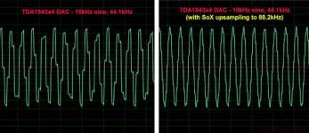

x4 vs x8 with TDA1541A... nope, as far hearing music is your goal ! there are better birds to chase with that chip ! Whatever you shpw tda1543 measurements or any 16 bits chips. Going higher frequency has some drawbacks ! At least my long experience with that chip. YMMV. Try blind tests and report, do not stop on datasheets eachtime.
