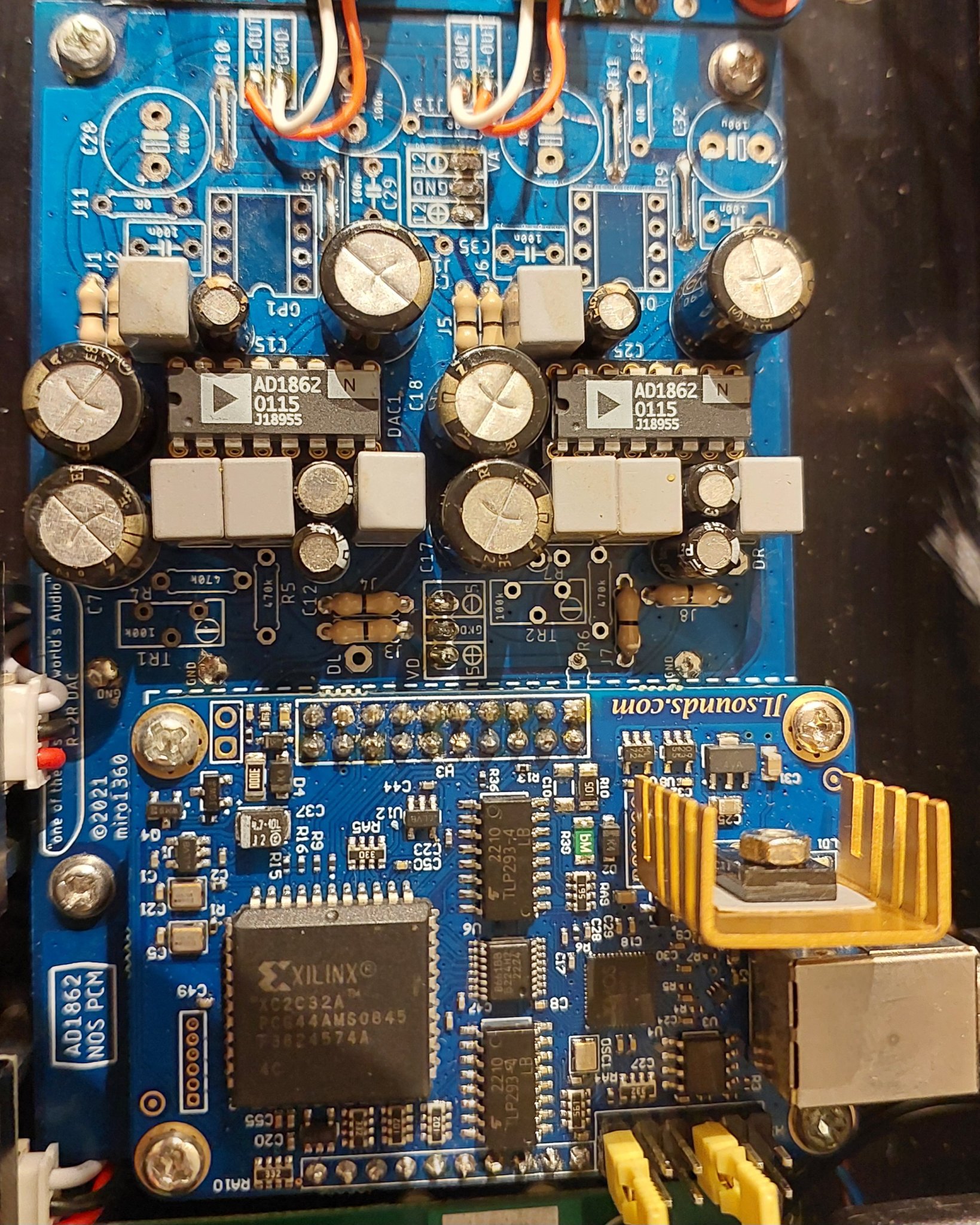

And if you choose the 'correct DAC board' to get, you can stack the JLSOUNDS board on the Dac board... Which makes them a neat, compact and cool looking unit ..

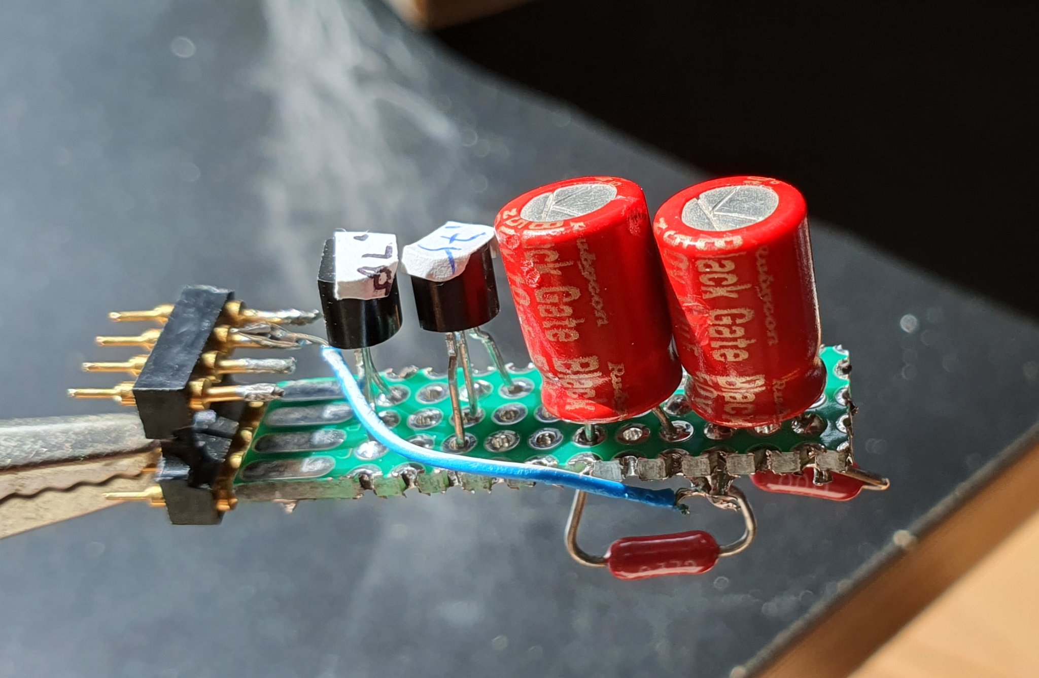

Micro project of the day.
I wasn't entirely happy with some aspects of the sound of my 1862 (unofficial) board. Today, decided to replace the OPA1641 I/V with a quick and dirty attempt at EUVL's CEN. The little protoboards fit the DIL opamp socket, so the experiment was really easy and preserved the same Shinkoh IV resistor already on the dac board. Obviously with a floating PS.
The tonal balance is finally normal with all sorts of music. There are other improvements too. Very impressed and a big thank you to Patrick.
