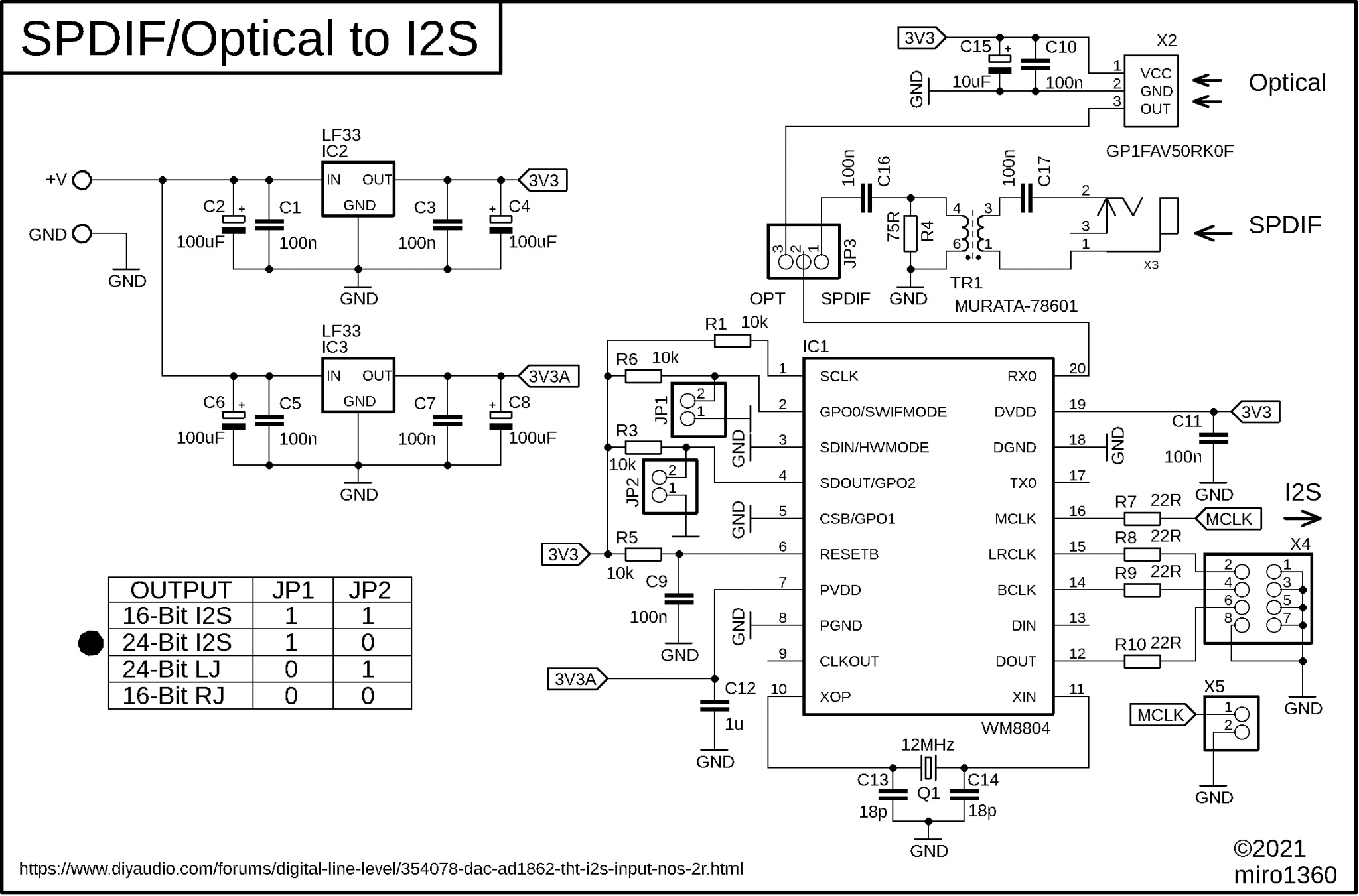

Does anyone have an explanation?
SPDIF/Optical to I2S, almost THT, there is no active device (CD player) on the SPDIF input of the WM8804 panel, the current consumption is several times higher than when I connect an active device.
The current consumption is also low if there is no data traffic on the SPDIF input and only a switched-on device is on it, the current consumption increases after the device is switched off.
Thanks.
Thanks.
Has the current consumption decreased by connecting the optical signal? Or just with coaxial SPDIF?
I can't test an optical signal, only coaxial SPDIF.
The connection is not the determining factor, but if the other device, e.g. CD player is on. An actual active data stream (CD playback) is not required; powering it up reduces the current consumption to a normal level.
Is JP5 shorted or open?I can't test an optical signal, only coaxial SPDIF.
This is because the spdif stream is running.
I used WM8804 many years ago and don't remember its behavior. Using other spdir receivers with an external SPDIF amplifier (usually 2 inverted CMOS gates, like 74LVC2GU04, etc. in analog mode) I have seen 2-2.5 times higher current consumption without the SPDIF signal.
WM8804 has an internal spdif amplifier, but probably with the same topology.
