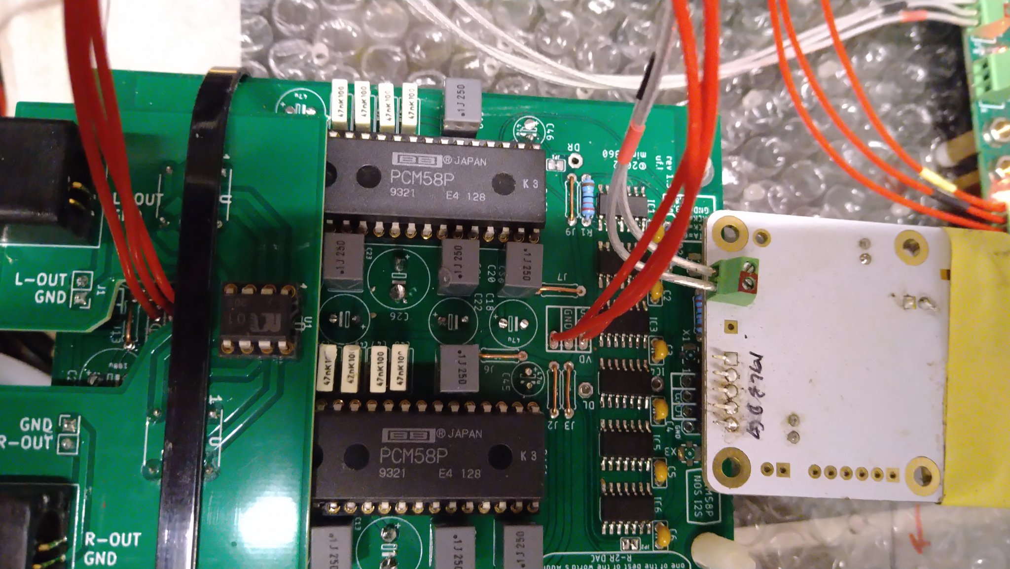

pcm58 pcb playing well, running over three weeks, no problem.
