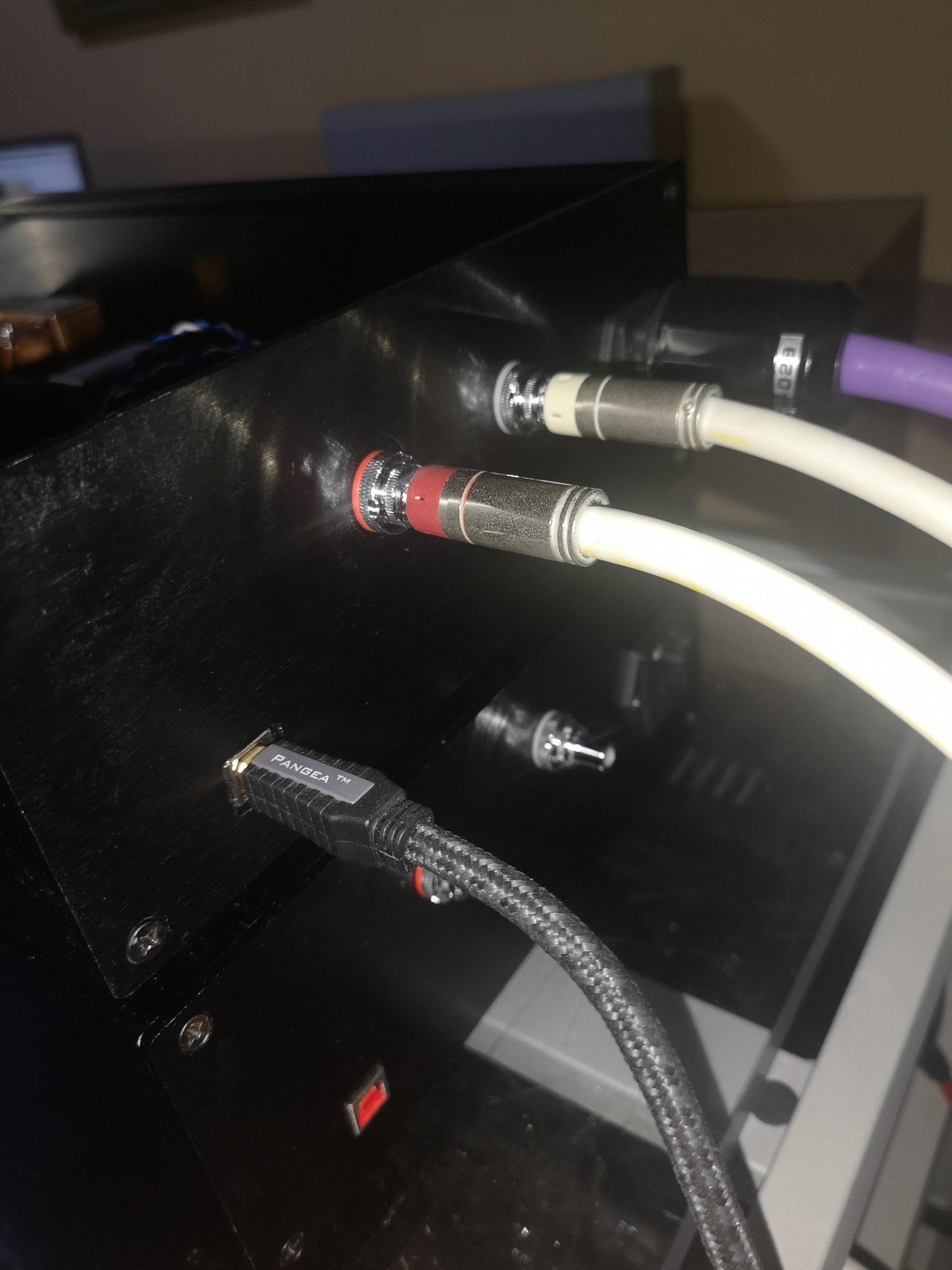

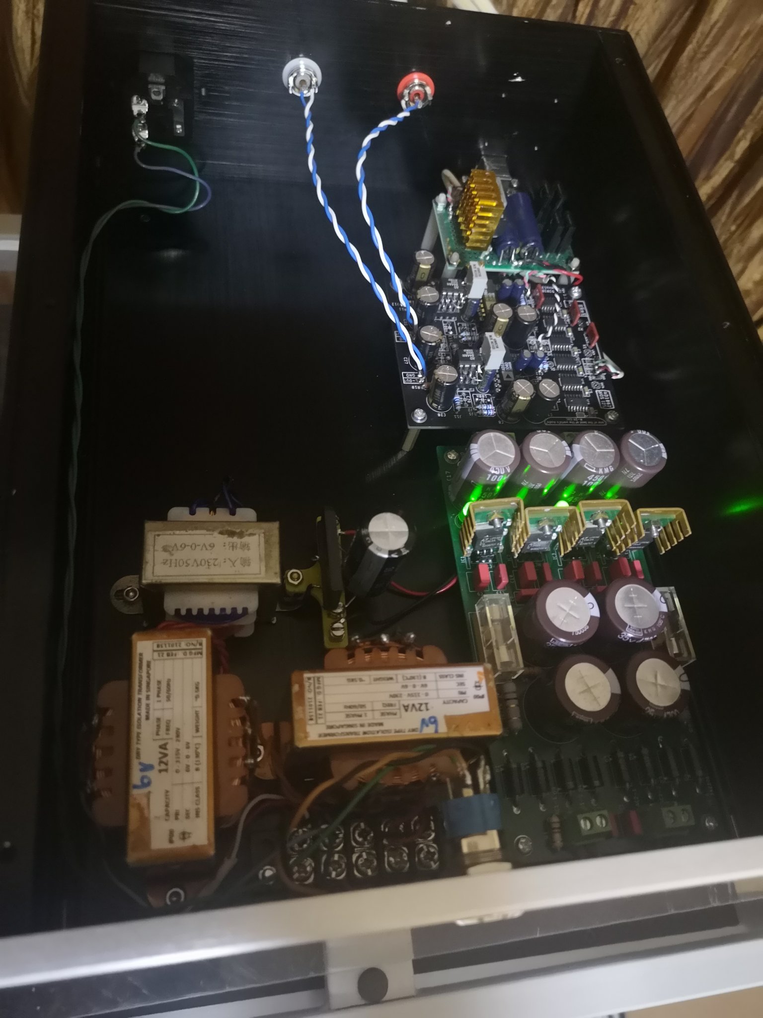

Thanks! Did you already made all connectors in the back? Can you show us?
There is good space in the chassis for my adventure with output stages, psu etc. Yes connectors are at the back.

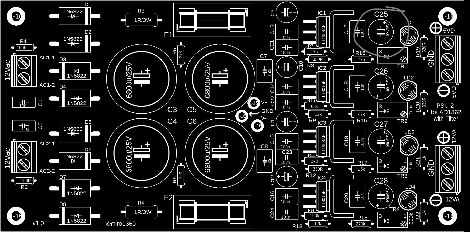

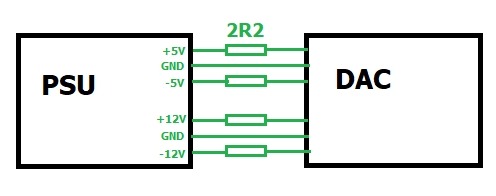

Be sure to use 2R2 resistors on the output power lines.
Hi Miro!
Do you mean this?
J1-J13: is 0R resistor, or a wire jumper for the PSU 1. Use 2R2 or 3R3 resistors for the PSU 2. Jumpers can be used as an alternative input for separate power supplies for each channel (no significant advantage with separate channels).
I duno...it is just a question as I have not tested...I find strange this oscilation thing and I suspect a 0.1 uF somewhere decoupling to be too much but where ? Before the ic reg input pin ...two 0.1 uf there on the power rails into 3 cm from the main reservour cap...too much odd? Or the output pin ? 2r2 should not arm but what a pity with such good reg ic... I am a noob and do not understand much but I like making experiment...I woyld have tried 100 uf output cap with 16V max rating to INCREASE the esr (adding resistance) instead putting a resistor...but yep...vias are so small I would not try too much desoldering caps there...
