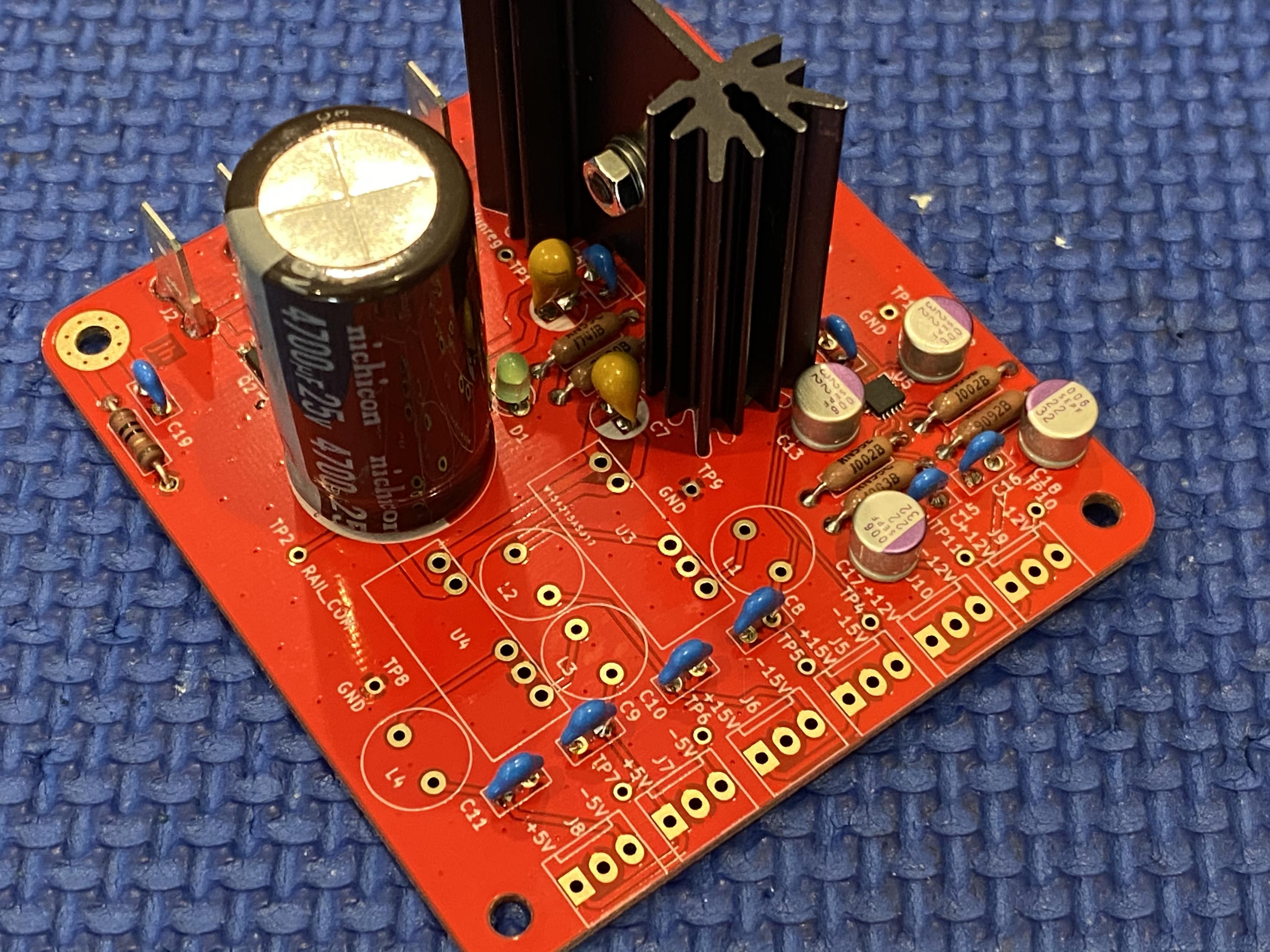

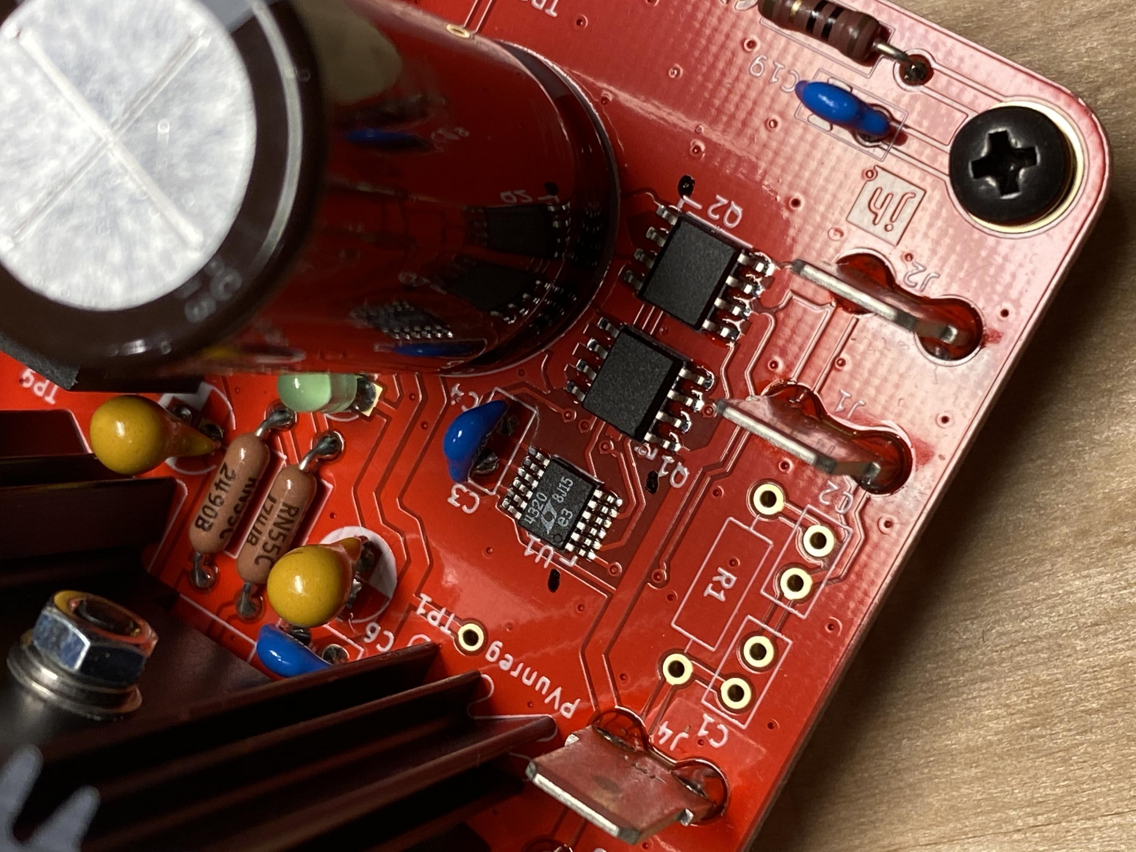

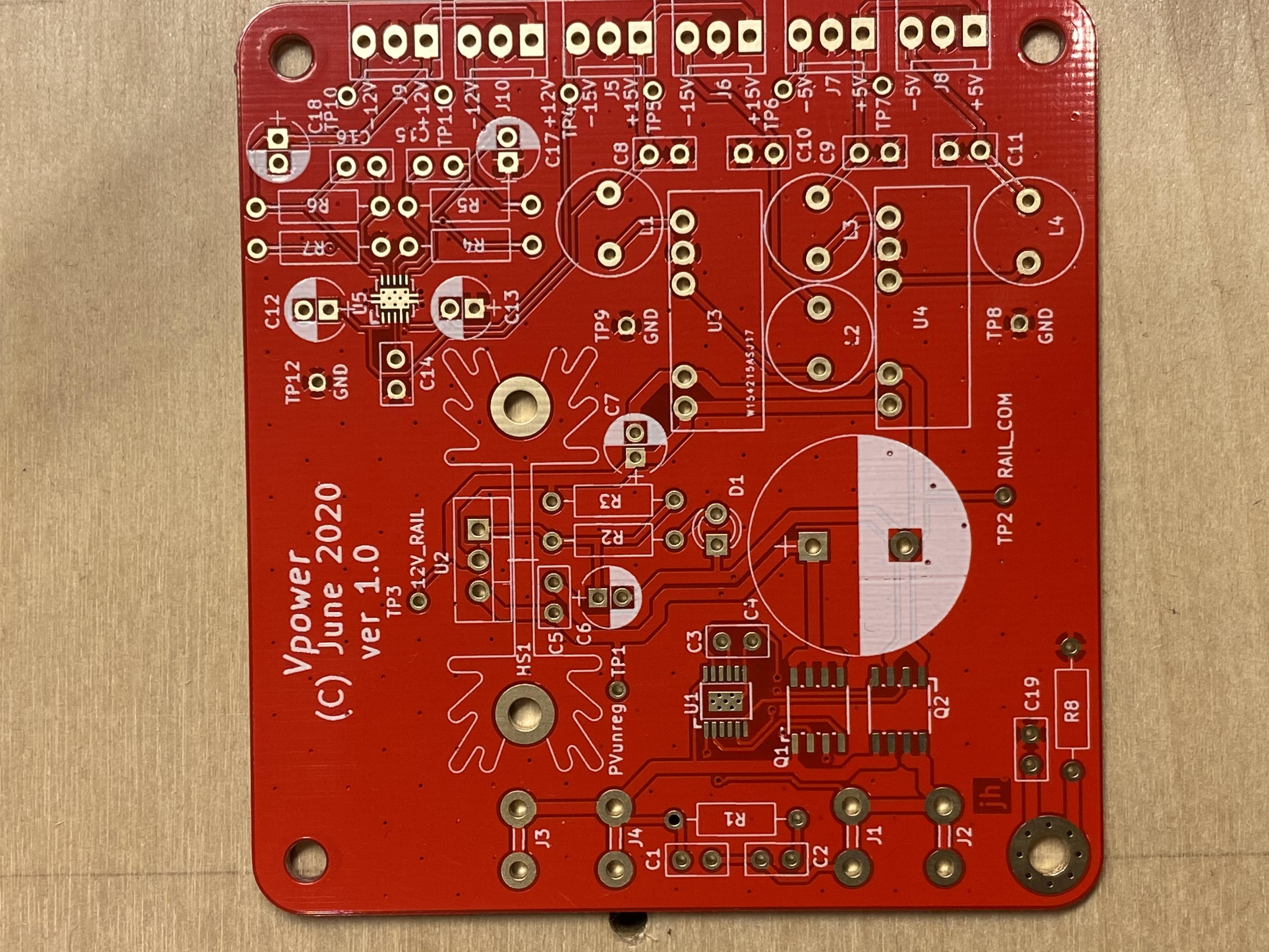

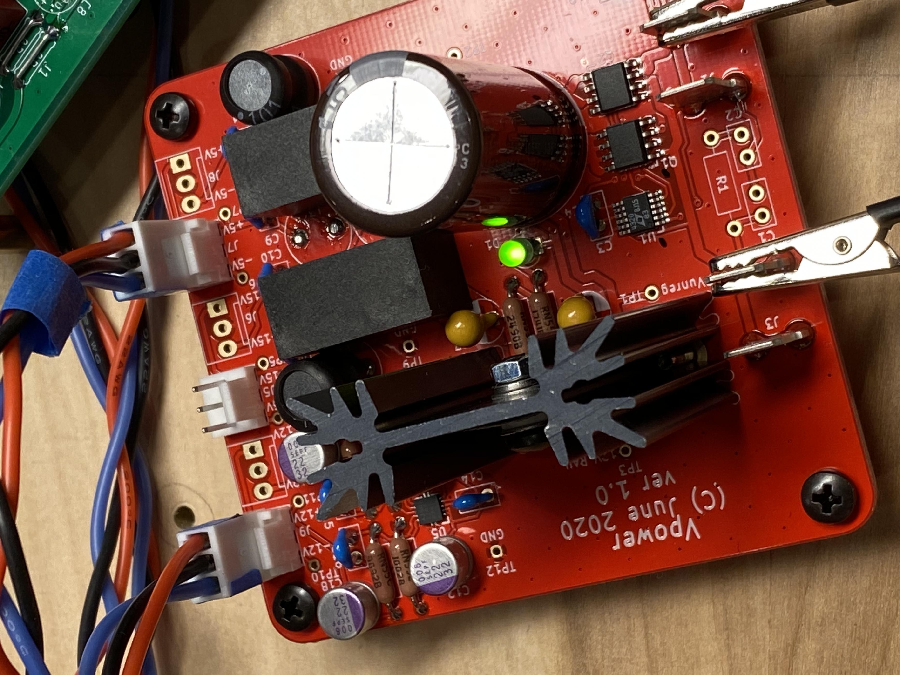

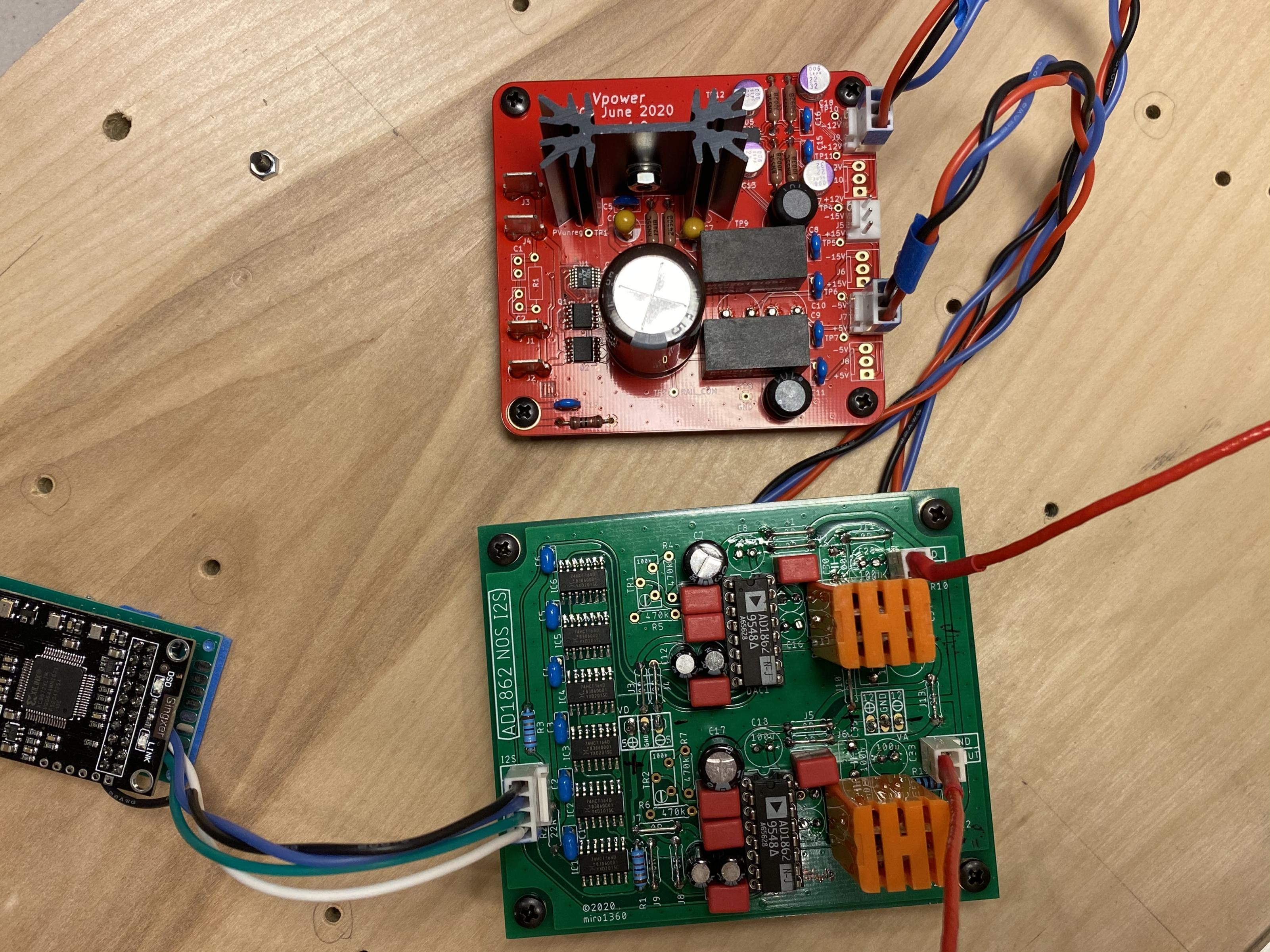

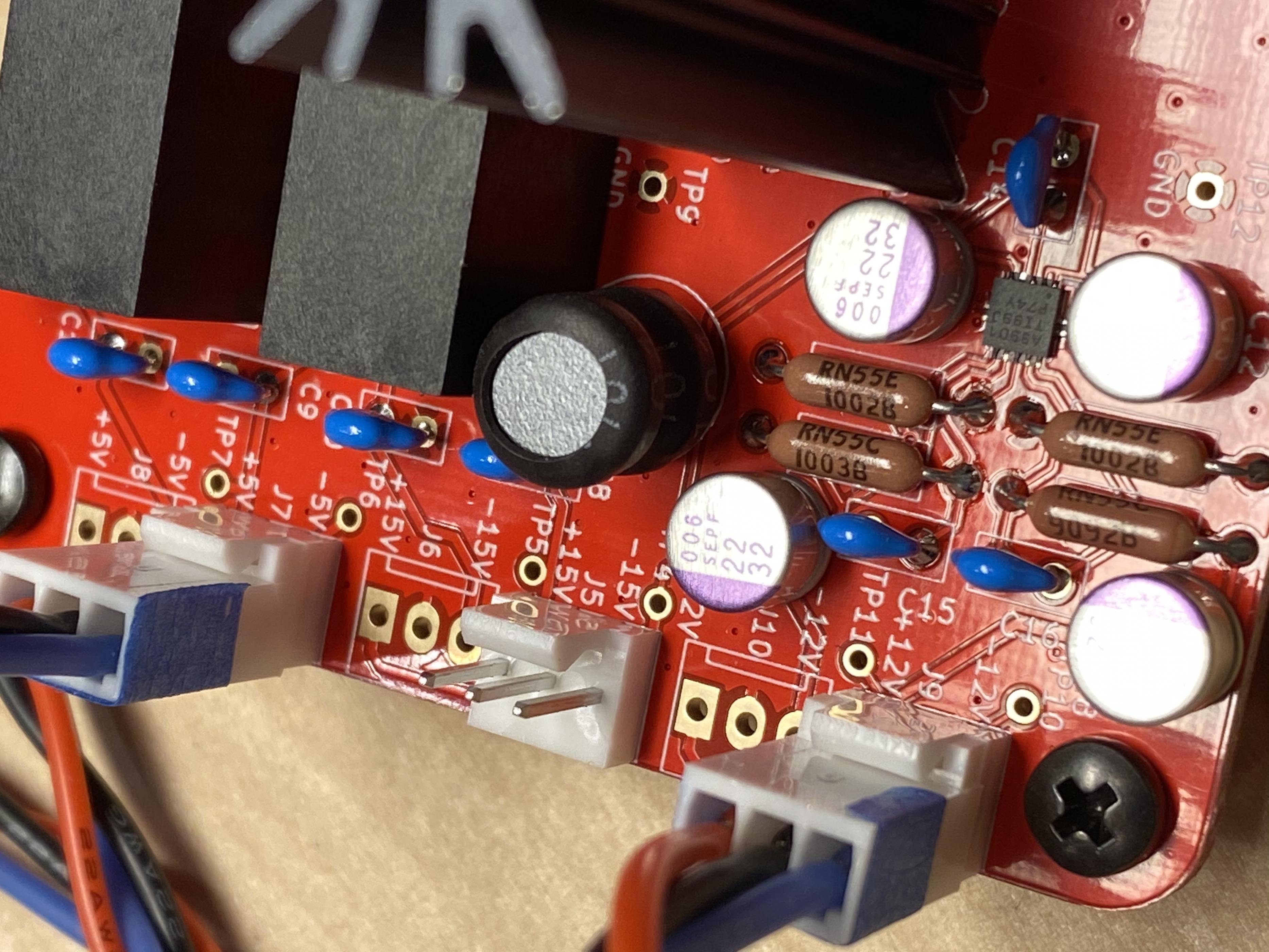

Hi All,
I finally received the rest of the parts needed to complete a very compact multiple output voltage PSU perfect for this project and others as long as current draw does not exceed the DC converters maximum. With the help from member jhofland, this psu outputs +/-5, 12 and 15vdc, nicely suited for digital, analog and opamp supplies.
A single transformer 12vac secondary feeds an LT4320 Ideal Rectifier then on to an LM317 regulator fixed at 12vdc. 12vdc powers a pair of DC/DC converters that output +/-5vdc and +/-15vdc. An LC network is on the outputs to tame any converter noise. There is a parallel +/-15v that feeds a TPS7A LDO regulator fixed for +/-12vdc output for the analog power.
The psu has been hooked up this evening and it works fantastic!! This DAC sounds excellent and the combo is so small.

Really nice work Vunce! Modular system is always a good choice, everyone can opt for their favorite power supply, easily test other things, or compare it between.

My next move is to remove the opamp psu jumpers to utilize the +/-15v supply.
Your decision to not include an onboard psu and utilize jumpers was a sound choice. This DAC project is a Tweakers delight 😀
