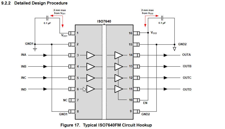

Edit, I don't know if a good isolator chip the size the shift register we already soldered exists ? Maybe it will be better than a not perfect Nenawa traffo splitter. the isolator chips for digital circuitry are nowadays very few jittered, less better than 5 or 10 years ago...
Well I assume as usual, proof is in the pudding, while it deserves or not icing has to be tested for real !
@gaszto - give us some details of the isolator you used too!
It is just an ISO7640FM isolator IC. One side of the IC is the "dirty" input side, the other is the "clean" output side. You need a good quality 3.3V or 5V supply to the clean side.
I have not tested it with the ad1862 yet.

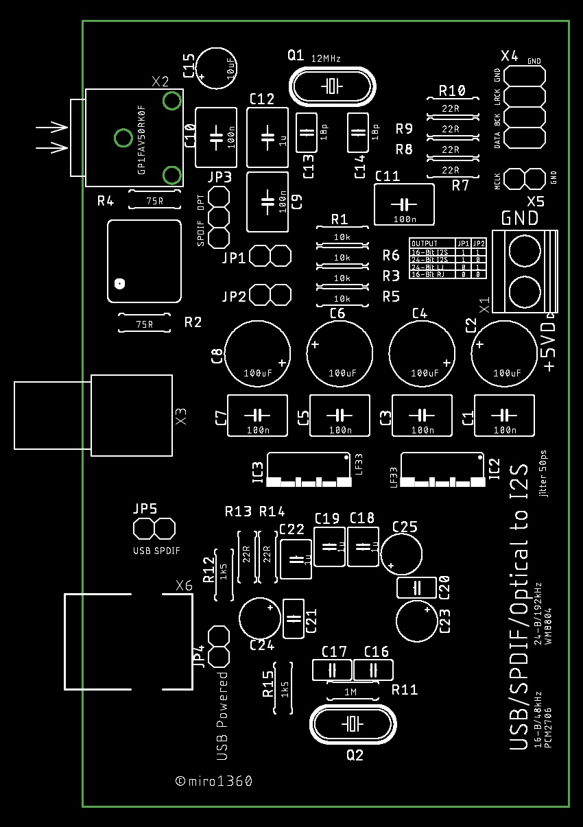

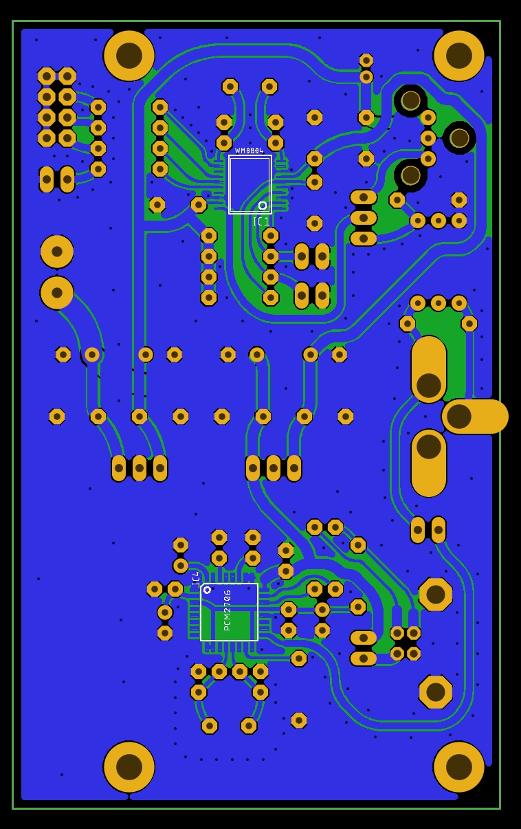

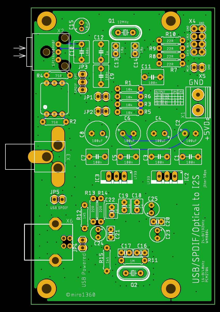

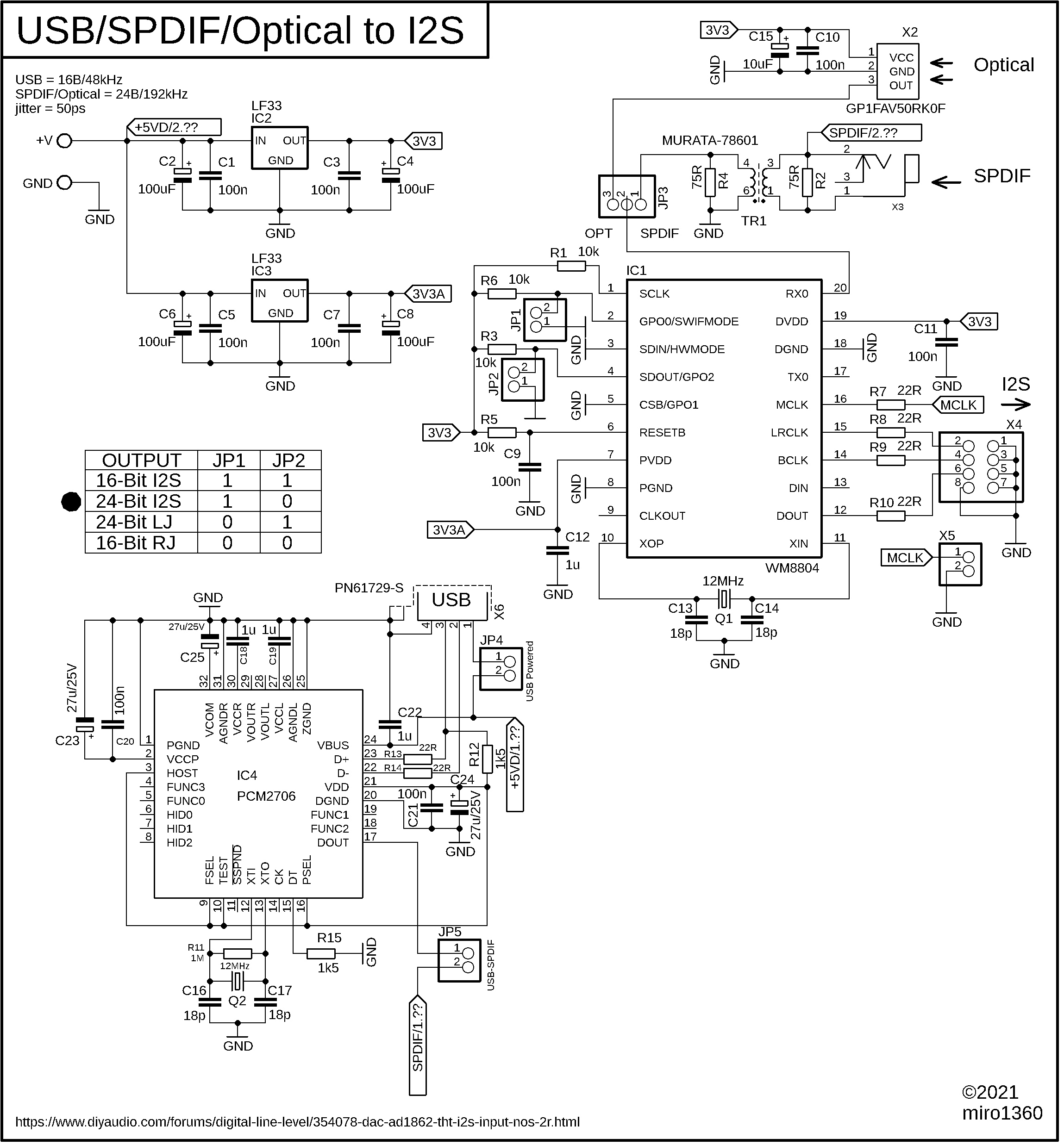

USB/SPDIF/Optical to I2S
Simple USB/SPDIF/Optical to I2S 🙂
USB up to 16-B/48kHz.
SPDIF/Optical up to 24-B/192kHz.
Jitter is 50ps, so it can be also used with modern delta-sigma DACs.
Transfer is asynchronous (clocks are generated directly in the WM8804).
It is almost THT except for the WM8804 and PCM2706, which are soldered from the bottom.
How to solder the smd IC: youtube IC soldering
Untested at the time of writing this post, so i can't guarantee the functionality right away 😱
(The first post will be updated after testing.)

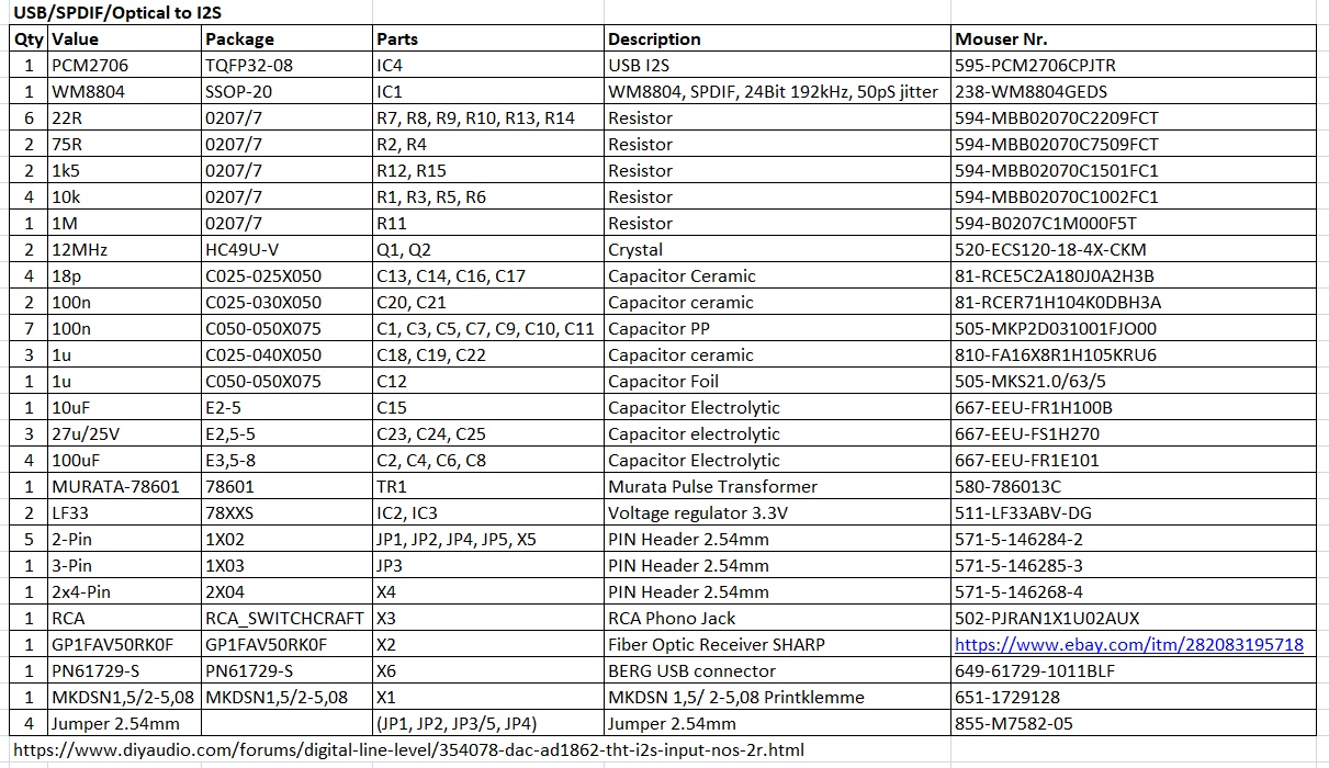

Components example, mouser:
IC4:595-PCM2706CPJTR
IC1:238-WM8804GEDS
R7, R8, R9, R10, R13, R14:594-MBB02070C2209FCT
R2, R4:594-MBB02070C7509FCT
R12, R15:594-MBB02070C1501FC1
R1, R3, R5, R6:594-MBB02070C1002FC1
R11:594-B0207C1M000F5T
Q1, Q2:520-ECS120-18-4X-CKM
C13, C14, C16, C17:81-RCE5C2A180J0A2H3B
C20, C21:81-RCER71H104K0DBH3A
C1, C3, C5, C7, C9, C10, C11:505-MKP2D031001FJO00
C18, C19, C22:810-FA16X8R1H105KRU6
C12:505-MKS21.0/63/5
C15:667-EEU-FR1H100B
C23, C24, C25:667-EEU-FS1H270
C2, C4, C6, C8:667-EEU-FR1E101
TR1:580-786013C
IC2, IC3:511-LF33ABV-DG
JP1, JP2, JP4, JP5, X5:571-5-146284-2
JP3:571-5-146285-3
X4:571-5-146268-4
X3:502-PJRAN1X1U02AUX
X2:GP1FAV50RK0F Original and New SHARP Sensor | eBay
X6:649-61729-1011BLF
X1:651-1729128
(JP1, JP2, JP3/5, JP4):855-M7582-05

WM8804/5 or DIR9001 have lower jitter (good internal PLL, only 50ps jitter), consider it 😉

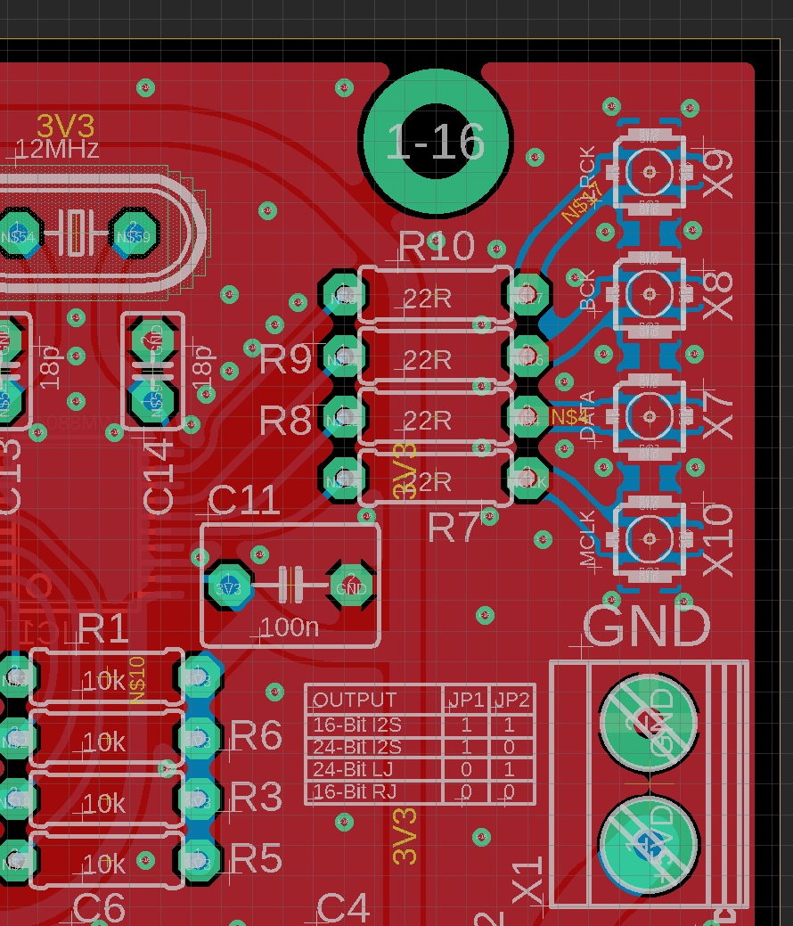

@ Miro,
It will be also very cool to have uf-l pads near X4 for direct I2S if the board is stacked on the main board. It will be very versatil (Sd Card owners and so on)
The DIR9001 IS ULTIMATLY BETTER but hard to find and expensive...

ahaha RED, nah it's good if it has the X4 conector still (in my head both should be on board for everybody 🙂, the uf-l could be on the top side, with traces towards X4 till on the right side of the pcb for the stacking with the main DAC !
The stacking X4 connector for overlapping on the main dac is a great idea ! Imagine a Miro board with the UTFL96 streamer board from ECDESIGN via Toslink, with Diyiggy parts BOM and the output stage of your choice (Fran-Wood) : it will beat several USD grand SIGMADELTA AK and ESS, hey ! SOme can also uses sota SD Trans via UF-L; a NAS via USB, a toslink towards soundcards of computers, eetc VERSATILITY 🙂
