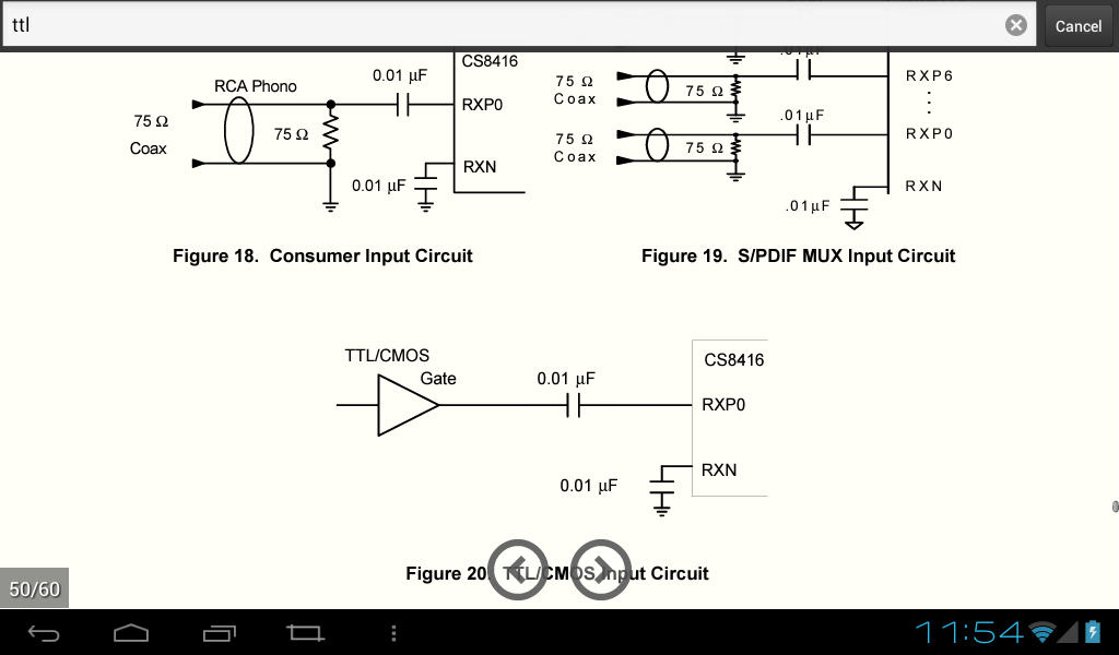

The cs8416 datasheet clearly says you can use a ttl or cmos input

I am talking about the cs8416. See the attached grab from the datasheet.
TTL input is ok

It is right, but only if VL (pin 21) is held at 5V; in Absolute Maximum Ratings they clearly specify: Vin MAX = VL +0.3.
In my MINI2496 board VL is held at 3.3 V.

Have to agree with fulvio on this one...
I read over the CS8416 datasheet countless times, and on page 27 you'll find this;
"The input voltage range for the input multiplexer is set by the I/O power supply pin, VL. The input voltage
of the RXP[7:0] and RXN pins is also set by the level of VL. Input signals with voltage levels above VL or
below DGND may degrade performance or damage the part."
So, it would be wise to keep SPDIF input voltage below the VL. Doesn't mean it won't work, but try it at your own risk...
Or you can put a simple resistor voltage divider, but it may not be the best solution...

Thanks, I think I've fixed the problem using a compensated divider, that is a 33 pF capacitor in // with the series resistor of the divider.
In this way I can't see any difference in rise time before and after the divider.
