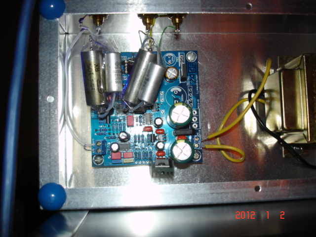

Recall that in a few post back, I planned to take the output from the AK4696 directly without LPF and opamp. I spent some time in the last few days to try out 2 configurations:
1. Output transformer (a cheap pair that I have around, Edcor PW600/600).
2. Capacitor out (Silmic II 10 uF // CDE Vitamin Q 0.47 uF // 6200pF FT2 Telfon).
Since I don't use the opamp, I only use a Radioshack 120V/12.6VAC 3A transformer which is more than enough to power the board.
After 3 days of extensive listening, my preference goes to the #1. Compare the 2 alternatives, the cap out just doesn't have the clarity of the mid and the high of the OT's, and this can only be better with the Cinemag's that I need to find out where they are hidden in my pile of junks However, there is a down side of the OT's, they are very unforgiving. Any artifacts in the recordings are simply amplified, whereas the cap-out masks that in a nice manner. This was very obviously when I listened to some so called remastering from Hong Kong for some recordings from 30 - 40 years ago. To me, a little coloration actually helps.
I have to say either one turned out quite well, and I can listen to either one comfortably. For now, I choose the cap-out, mainly due to the fact that the chassis that I use is simply too small accommodate the OT's.

What parts of the power supply can be modified when using the ditrect out, with a capacitor?
I have now this setup so the op amp section not being used, but I left all the components on the pcb in place.
If you could also give some more info on how you made it possible to use one 12v transformer, that would be very helpfull.

Attached 2 pictures to show how it is connected.What parts of the power supply can be modified when using the ditrect out, with a capacitor?
1st picture showed the 12VAC input. In order to do so, use Greg's picture as in post 958. Keep in mind, when you want to switch to use opamp, you will need to either remove this link or remove this transformer.
2nd picture shows how the caps are connected. Basically, I took the outputs from the L+ and R+. When the board is in the same orientation as in the picture, that will be the 1st and the 3rd of the 1K resistors from the LEFT.
Since I want some flexibilities,
1. I didn't solder the transformer into the fuse and the on/off switch. The
idea is that I can swap in my second board into the same chassis without
the soldering iron at all.
2. I soldered 4 header pins into the 1K resistors holes so that I can solder
and desolder from these spots so that I won't lift the trace from the board
by accident.
3. I soldered the other side of the cap to the board at the far side of the
2 1K resistors instead of directly into the RCA jacks, same reason as
#1. The 3 wires from the RCA's are connected to the board's screw on
connectors.
I hope this will help.
