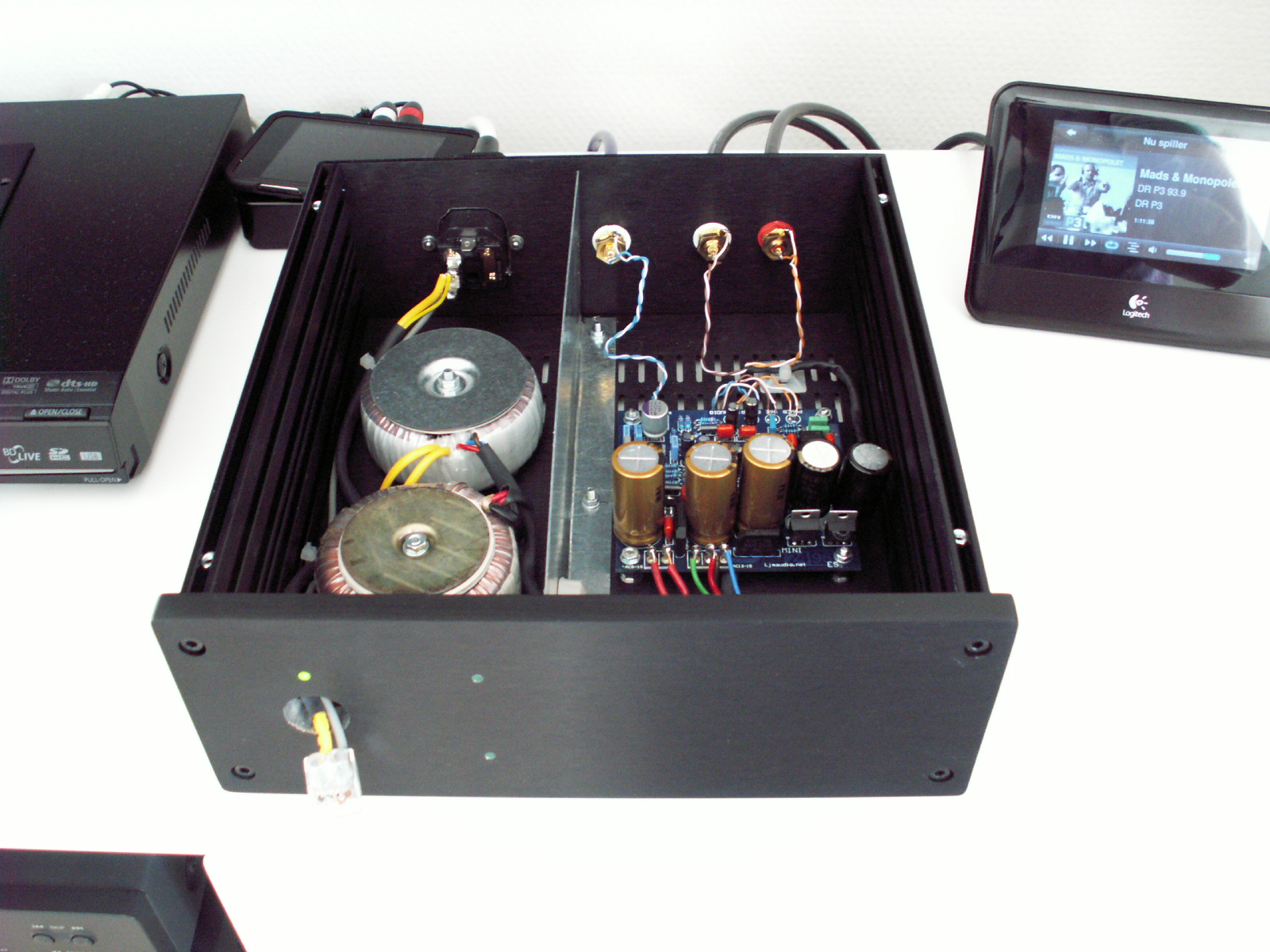

Hallo
So am I almost finished with my eBAY DAC. I am missing a button (on/off), which will hopefully soon come.
I have upgraded the following
C3>> Sanyo SEPC 470UF 16v
C 38 and C 39>> Elna Silmics II 220 uF 50v
C 23, C24 and C25>> Nichicon FW (m) 2200UF 63v
The 3 regulators > MCxxxxCTG
I think I have some problems with ttttt and ssss sounds.
It plays incredibly detailed, and the scene is good. But it becomes too much in length with sss and ttt sounds. The new components have played about 20-30 hours now(c3 and the 3 regs. only about ~12 hours), are there chanches to anything will change? Or are there other places I should look?

The analog audio filter on the op-amps needs attention to remove the sibilance.
Replace the generic capacitors (little green ones) with either Vishay KP1830 or Wima FKP type.
Also I notice you are not locally decoupling your op-amp with Silmic caps!
This will also reduce sibilance.
Your audio transport could also be causing some sibilance? Are you using your touch with a linear power supply and applied soundchecks mods?

If you didn't already changed resistors you should add some carbons, R25, R27, R31 and R33 are good positions.
Any good quality industrial carbon film will do but for best results buy four Rikens.
If you order some more the best thing is to hand-match them to 1% or better.

Hallo Erin. I am still a Newbee 🙂 The green ones you mentioned, is it the 5 pieces with circles on the picture below?
If yes, can you please give me a link to eBay to the right ones in the right size from Wima FKP or Vishay ?
Can you make a simple drawing that shows me, what I should do with silmics on the op-amp. And what caps do i need ? (link ebay ?? )
Yes i have a linear power supply for the Touch. I don`t think that soundchecks mods, do something good to the music. Only sittings i have changed, is trancoding on the server (FLAC)

Replace the 4 green capacitors next to the opamp with this:
http://www.ebay.de/itm/WIMA-Polypro...060?pt=LH_DefaultDomain_0&hash=item4aae8e1d24
The two red capacitors next to the op amp should be removed and replaced with Silmic 100uf or 220uf. Observe correct polarity!
Also be careful removing any capacitors in this area because the tracks are thin.
