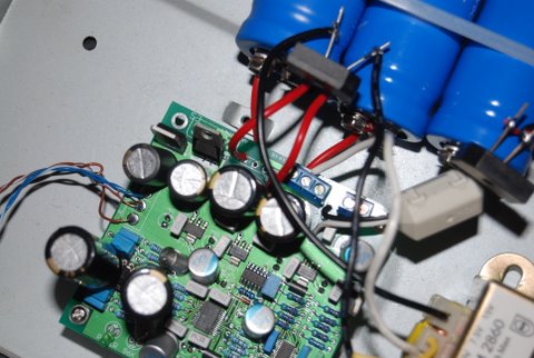

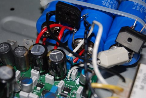

I was asked for some photos of what I have done.
You can see the 22000uf capacitors. The bridge rectifiers have been removed from the board and I have mounted different bridge rectifiers off the board before the caps. It should be self explanatory. You can also see the Silmics decouping the op-amp.....

I removed the ak4393 and replaced it with ak4395,the receiver is now running on 5volts after changing lm1117 3.3v to 5v version. All electrolytics have been replaced with sanyo oscon and all coupling caps with tantalums. Power supply has been upgraded to 5600uf and 1800uf panasonic fc. Opamps have been bypassed and output is directly off dac through 2.2uf mkp's to the grids of two Tesla gold pin e88cc tubes configured in an SRPP arrangement. This little dac is an unbelievable performer excellent detail,smoothness,bass slam ect....
