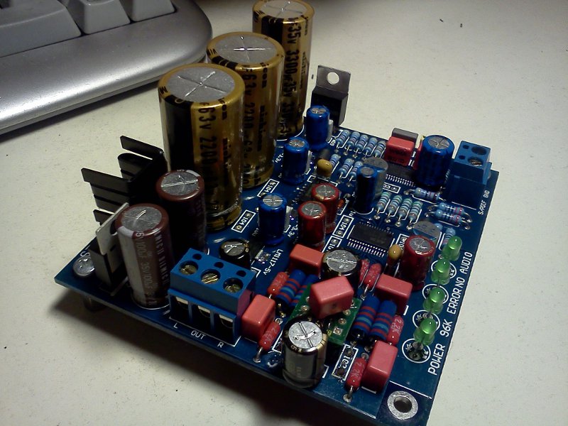

I've assembled and running in my second MINI24/96 (the first one was a development board... 😀).
I've attached a picture and a modified BOM (Takman REX became PRP9372) since before mounting the Rikens to the new boad I've compared again PRP and REX, PRPs are a bit more 'dynamic' and full. 😉
