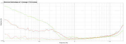

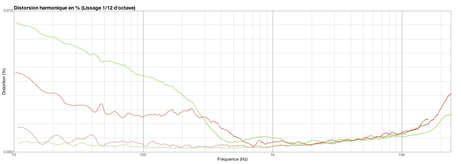

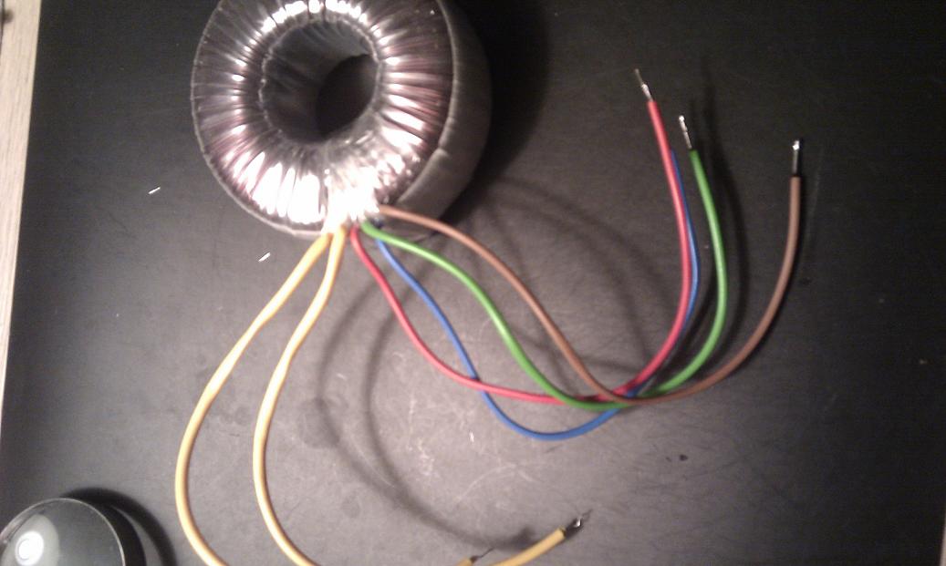

I just measured the dac with the ebay R-Core(2x9v+2x15V) and also with two 30VA R-Core (one is 2x9v, the other 2*12V), and there are small differences in the sub 1000Hz range. In red is the ebay R-core and in green the two 30VA R-cores. In solid the 2nd Harmonic Distortion and in dotted the third (in percentage) across the audio freq range.
At least it shows that transformer difference is measurable.
Caution with the ebay r-core to plug the 15V in phase beacause the wires for the two secondaries are the same color (yellow and brown).
Time for listening now...

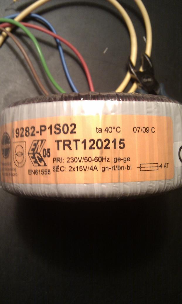

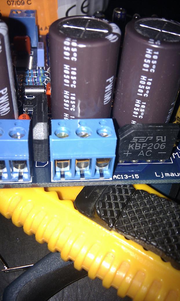

Hallo
I am a total Neewbe, so sorry for asking a stupid question.
I have just soldered the ebay DAC but, have trouble finding out, how to connect to the transformer. The one of the two "power indputs" have 3 connections. I have a traffo whith 2x15Vac, i was planning to youse for this project. How do i connect the 4 wires from the traffo ? Please se my pictures.

How can you tell if they are in phase or not if they are both in the same color?
I used a two channel scope. I plug a yellow and a brown together for ground and the other yellow and brown to scope channels.
To be more precise, I plug the transformer to the dac with the wires that are in opposite phase.
Silver84.
You have to search the web for the connection diagrams for your transformer.
I found this.
http://www.display.nl/components/com_virtuemart/shop_image/tekening/02.04.12015.tek.jpg
You have twin secondaries.
The red and brown should be connected together as the lower drawing shows.
This becomes the 0 volts and should be connected to the centre terminal of the three way block.
The other two wires connect either side of it.
If you are only using one transformer, you have to join two solder dots underneath the board.
This connects the other bridge rectifier to the wires you have connected.
I found this.

You can try by putting together 'gn' and 'bn' wires for AC ground (in the center of the triple blue connector) and 'rt' wire to another connector, and 'bl' to the third connector. 'ge' and 'ge' must be plugged to the main 230V.
Note that if you did not the solder trick to join the two power rails on the board, you need another 9v transformer for the other 'double' connector.

That whas just what i needed, many thanks
I thinki will find another ´transformer for the two way block. That must be a better solution
bismuth --> Thanks to you to 🙂 I have just ordered another 9v traffo to the "2 way block" i
Btw. Funny thing. If i use a polhit to tjek the polarity (phase og 0 ) it light whith all the 4 wires. But if i take out the main power plug, and turn it 180* and put it back in, the polhit only lights up whith 2 of the 4 wires. This must be the correct way, to wire the transformer on the primary side ?
