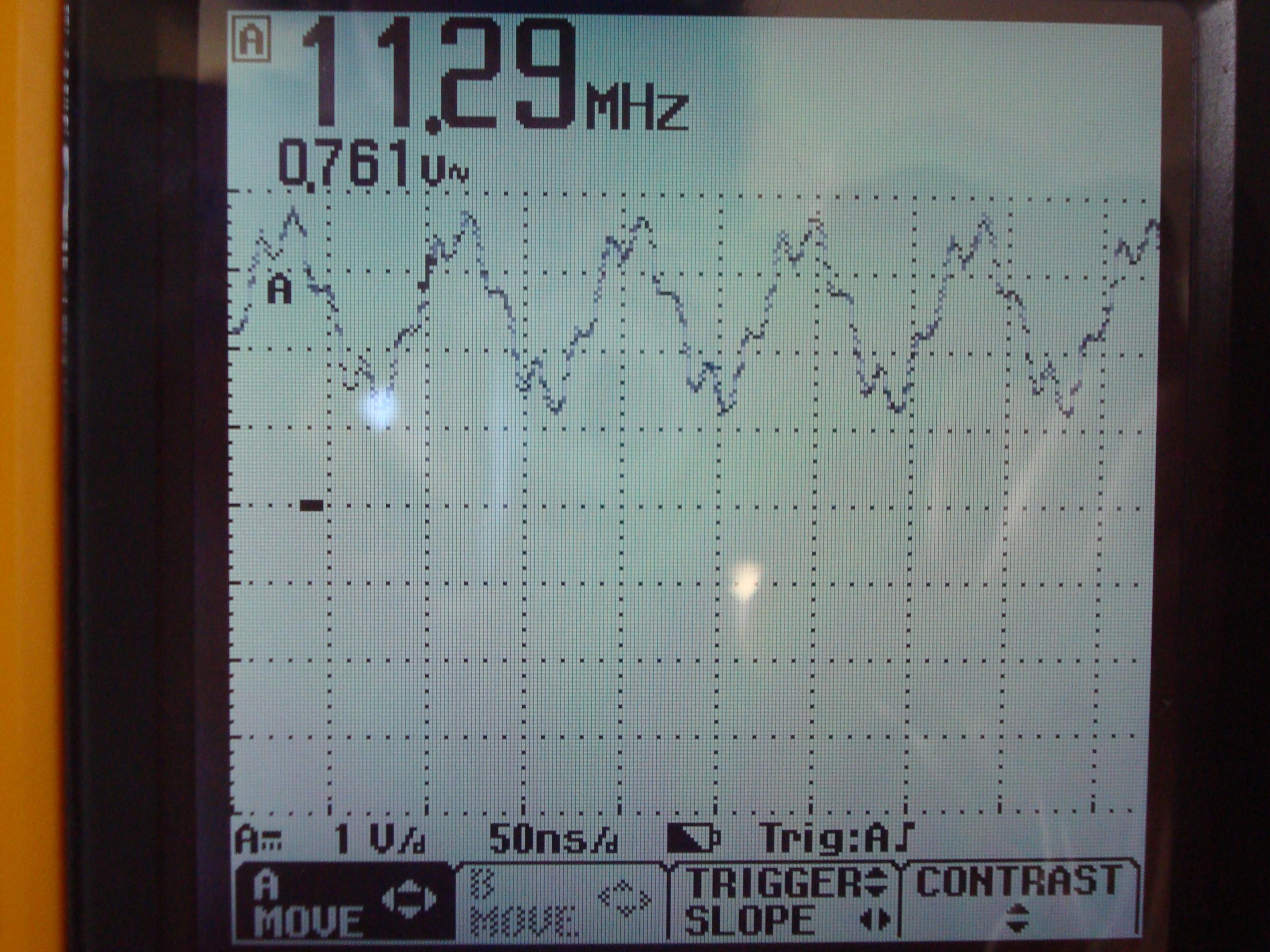

The oscillator has three connections:
INPUT
OUTPUT
GND
So INPUT goes to digital +3.3V,
GND is self explanatory
OUTPUT goes to OMCK (pin 25 on CS8416)? Now pin 25 is connected to GND and via R4 (47K) to SDOUT. Should that be removed? And if yes, what should and what should not be removed?

Ooooops, gave you the wrong link - that's a passive crystal...
You need something like this;
10pcs 11 2896MHz 11 2896M Active Crystal Oscillator Timer SMD 5x7 5 7 | eBay
or
5 x 11 2896MHz Crystal OSC 8 Pin Format TTL Enable Option DIY Word Clock | eBay
You have; Vdd, GND, Output - all of these are self explanatory...
OMCK is connected to GND, but SDOUT is connected to GND through a 47k resistor - so no need to touch SDOUT or that resistor - the DAC schematic is drawn a little strange...
Just unsolder the OMCK pin...

Hmmm.... that 5 x 112896 Crystal OSC etc.... is a 5V version. As far as I know, the CS8416 works on 3,3 V.
So how should I connect this? There is no 5V on the board, only 9V or + / - 15V 😕
Well, I put a separate 5V regulator together with the oscillator, but you could steal 5V supply from the regulator that supplies the AK4396 (AMS1117) - not the best solution but it will work...
OK, thanks. The biggest problem will be to find a soldering tip that can desolder the tiny pins of the SMD chip. 🙄
So, after connecting all this, the output of the DAC chip will be muted, if no S/P DIF signal is present? And once the CD player starts to submit the digital stream, it will automatically start to decode and play music?

I used a 2mm wide soldering tip (not that small) and a scalpel with really thin tip to push the pin up...
You can heat up the surrounding pins, just make sure you pull up only the OMCK pin...
The output of the DAC won't be muted, it will be active, however you won't get that annoying hiss when no SPDIF signal is present, it will be silent... And that's all you need...
