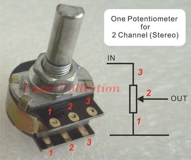

Hi, I now use my pc with a USB SPDIF converter to supply my AK4396 dac.
I have just had a tinker and plugged the dac directly to my power amp.
I like the sound much better this way so would it be possible to put a volume pot in between the dac and power amp.
If this is no problem, what value would be best 50k, 100k.
My amp is the Linn LK280 which I believe has a strange input impedance. 3k ohms I believe🙂

This is much more than is necessary, but may be helpful. Shielded Pot
Also - here is a simple diagram. SMD Pot - from eBay.
Hi Bob, would you rcommend this pot and it's value 10k over say a blue alps pot🙂
I have both of them and it's a toss-up. The Alps offers non-stepped operation but the 21 divisions on the SMD are more than adequate. The Alps is a heavier build but sounds a bit filtered when compared to the SMD. It is possible to fuse some of the resistors with excessive heat when attaching the leads to the inlets on the SMD pot.
If you plan to mount the pot directly on a PCB you need the Alps with pins. I haven't seen a motorized version of the SMD if you want remote control.
I lean toward the 10K SMD for it's clarity, but wouldn't hesitate buying the Alps Blue if the build/application required the physical features it offers.
The choice of 10K is matched to best operation with my particular power amp. You will need to select the value based on your system /amp specs..
Thanks this pot looks ok, bearing in mind my amps input is 3k ohms what would be the best pot from 10,20,50 and 100.
I am at a loss to understand input values.🙂
