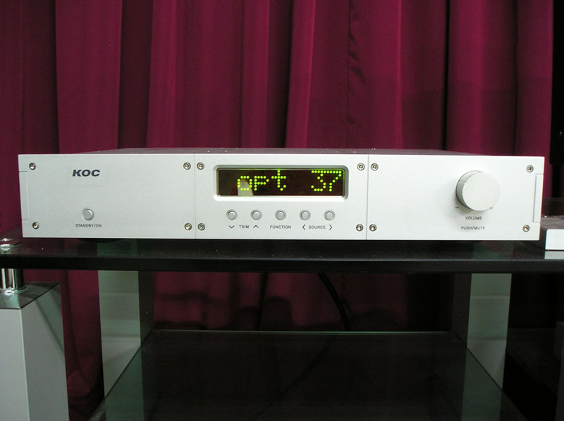

I love using encoder for volume control, and there's no problem to use pic. so don't worry.
then to design or program the dac, then first we should share information like schemetics..
anyway, why don't we design new da converter with ad1955 or ad1853.
Now I am thinking to design AD1853...
If you agree, then we can start. But where can we treat this da converter? I mean for sharing information, I or you should upload data like sch. So if you are ok, then I'd like to discuss this on my board. But you have your own homepage or board, then we can discuss on your board or your homepage.
On my homepage, I am processing digital amp. So If you are ok, then I can process the DA converter on my board.
(www.digi-hifi.com/audio forum)
and first, we should decide who draw sch and artwork.
waitting for your response.
